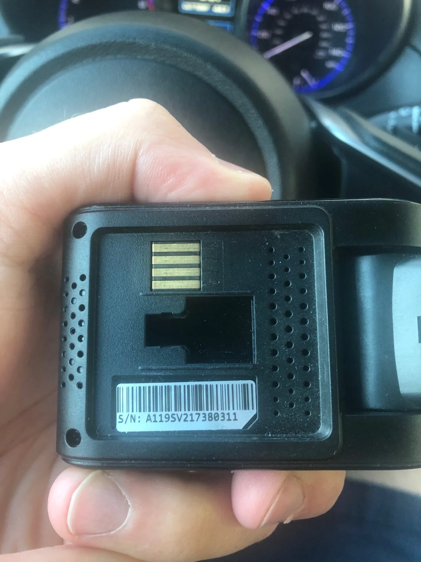

It's A119S. How can I tell if it's V2? And discount would be nice, thank you
You can tell it from the serial number that is on the front camera's back. Please share the serial number with us by shooting a pic.
