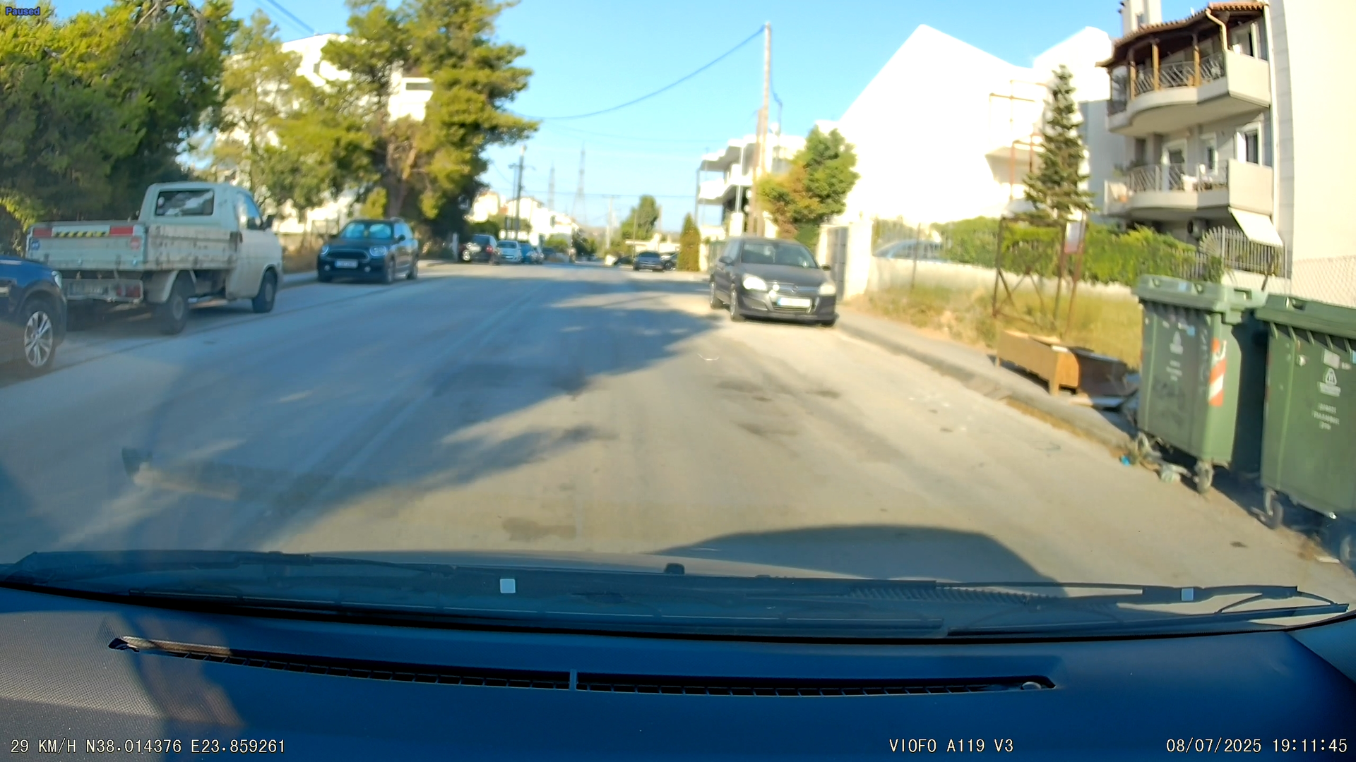

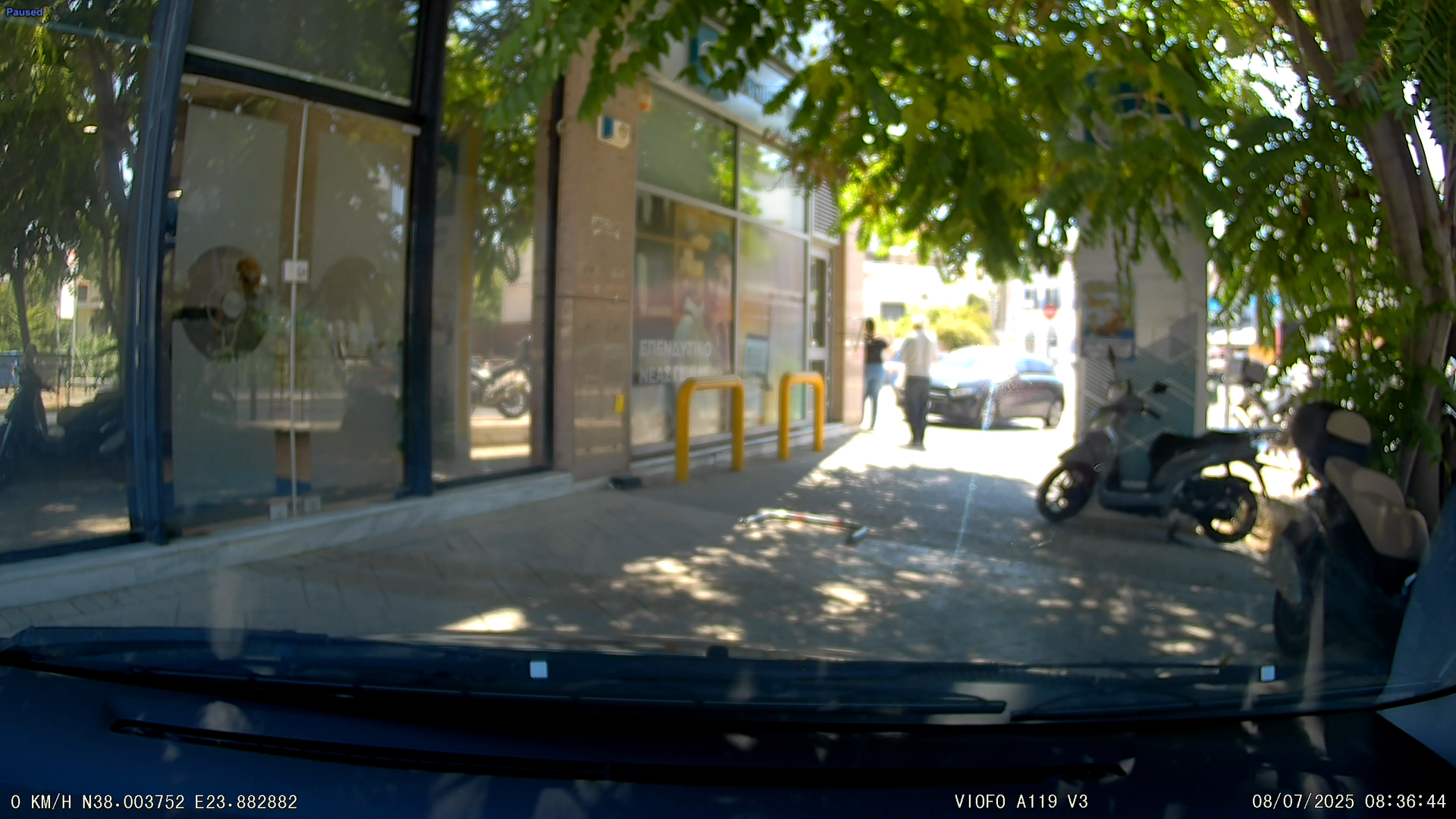

Unfortunately, the problem was not solved, not even by changing resolution/HDR/Bitrate etc.
View attachment 82505View attachment 82506
The whole problem is in the plastic lens holder, starting from 119 and 119 S, but it is strange that it is on the V3, there was a metal holder installed, in any case, keep in touch with Viofo support, they are aware of this problem.
