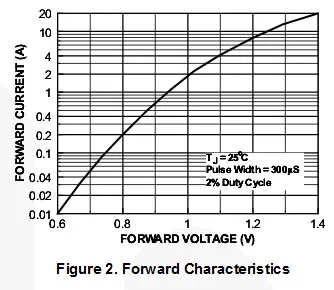

The graph on the data sheet shows the diode conducts 10mA at 0.6V forward voltage. It doesn't show what happens at lower voltages, but suggests it never actually drops to zero. Without testing it would be hard to predict what voltage the capacitor would reach without the resistor. I think it would be OK but it should be checked.

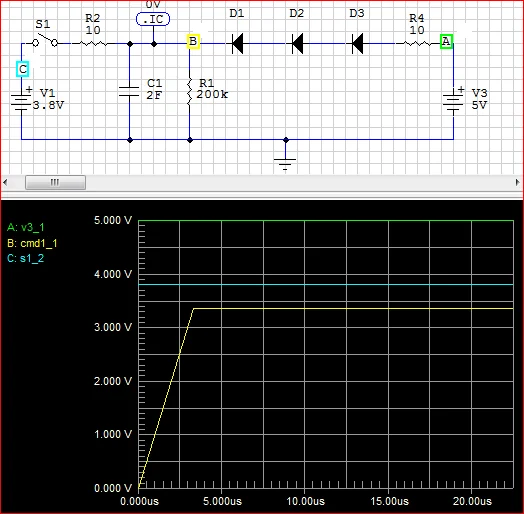

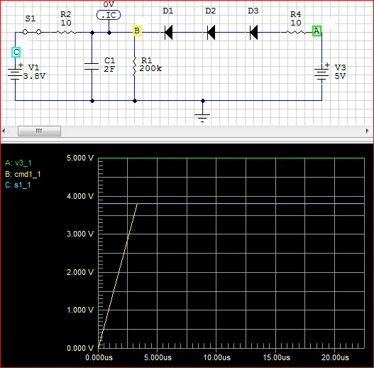

Exactly as I predicted (without the 360 ohm resistor) Simulation 101, Camera On capacitor voltage 3.8V, camera Off ~3.4v.
R1 simulates the processor standby load. R2, R3 simulates PS source impedance, .IC Initial capacitor voltage all needed for proper simulation.

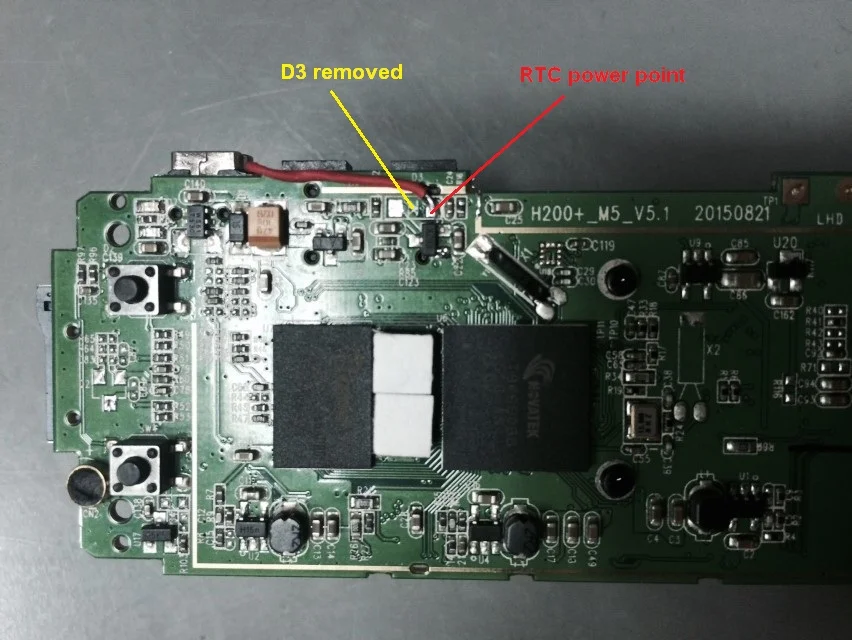

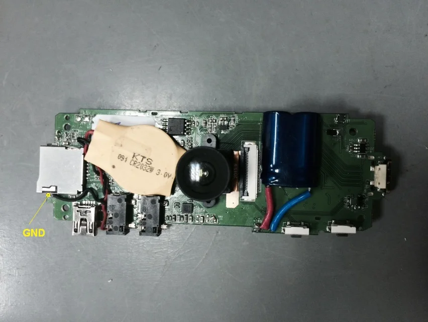

As I found, it can be re-hacked πŸ™‚ and RTC cell can be added very easy : I used CR2032 laptop backup battery with wires.
Just disconnect D3 that supplies RTC power and connect 3V battery (+) to this point. The (-) of the battery connect to any GND point.

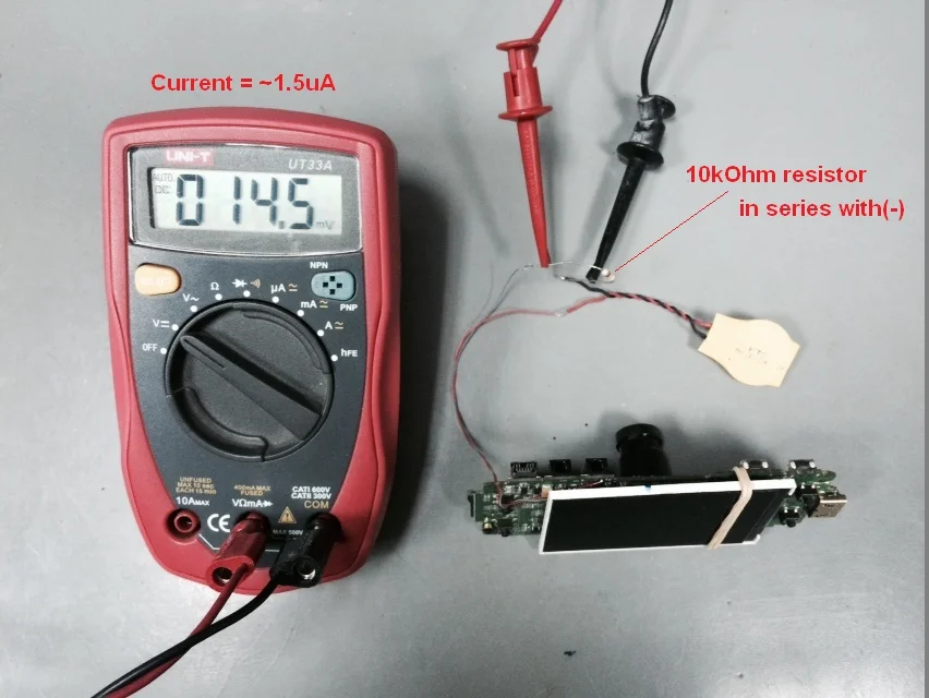

I suggest to make 1st connection via 10 kOhm series resistor and to measure battery discharge current: the scale is 10mV/uA for voltage measured on 10k . In my measuring the RTC consumption is about 1.5uA, that gives for 225mAh CR2032:
(225000uAh/1.5uA/24h/365d) *0.75= ~12year. (0.75 is 25% self-discharge factor).
The battery should be placed as close to the PCB as possible due to speaker, thus I didn't use any glue.
I tested it for ~24h, seems to be OK, before it lost date in ~5-7 hrs.
About a question: why not to do this in a "classic" way with 2 diodes to prevent battery discharge during power-on? The answer is that this causes more bad than good πŸ™‚ . I checked this point, it works, and this can really save battery power if you drive more time than the car is in standby. But my car is 80% of time is in standby, so I can save only about 20%. But even for good schottky diodes leakage at hot temperature (during parking) is 2-4 times more than RTC consumption, thus we save 20% but loose 300%. You can use low leakage silicon diodes - but their voltage drop is too high and you also loose battery lifetime. If you need - you can place 2 diodes - it works, but don't use original D3 - it leakage is unacceptable πŸ™‚

@EddieL Nice and clean- good job πŸ˜€ I am wondering where the red wire from the RTC (+) pad goes, looks like it's headed to the USB power input socket. That would be bad news if the battery is seeing 5 VDC+ via the PS when the cam is powered up. I'd look for myself but I don't have a G1Wc on hand πŸ˜‰
No, this net (D3 cathode) supplies power to the real-time clock circuit only (dedicated pins of the processor). D3 anode is connected to a local 3.3V regulator, thus D3 supplies 3.3V to the RTC from USB/main battery/supercap. When RTC is supplied by an external source, D3 is redundant.
