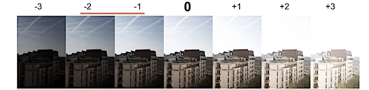

I'm afraid this statement is not true. The average CPL has an exposure factor (otherwise known as "filter factor" of 3-4 depending on the particular CPL filter used. This means that the CPL will block enough light entering the lens to create an exposure penalty of as much as 1.3 to 2 full ƒ stops. Each smaller ƒ stop aperture (increased filter factor) has half the light-gathering area of the previous one, so 2 full ƒ stops would increase the amount of light required to achieve the same exposure by 4 times.
Even on a sunny day there will be a measurable difference in how sharp an image of a moving object can be captured. While this may seem negligible in brighter light, under low light or cloudy conditions there will be a pronounced increase in motion blur with a CPL compared to the same image captured without a CPL. Of course, this works in concert with the shutter speeds and so results will vary according to the conditions.
A CPL will darken your image by 1.3 to 2 ƒ stops thus causing your camera to compensate by using a longer shutter speed.
