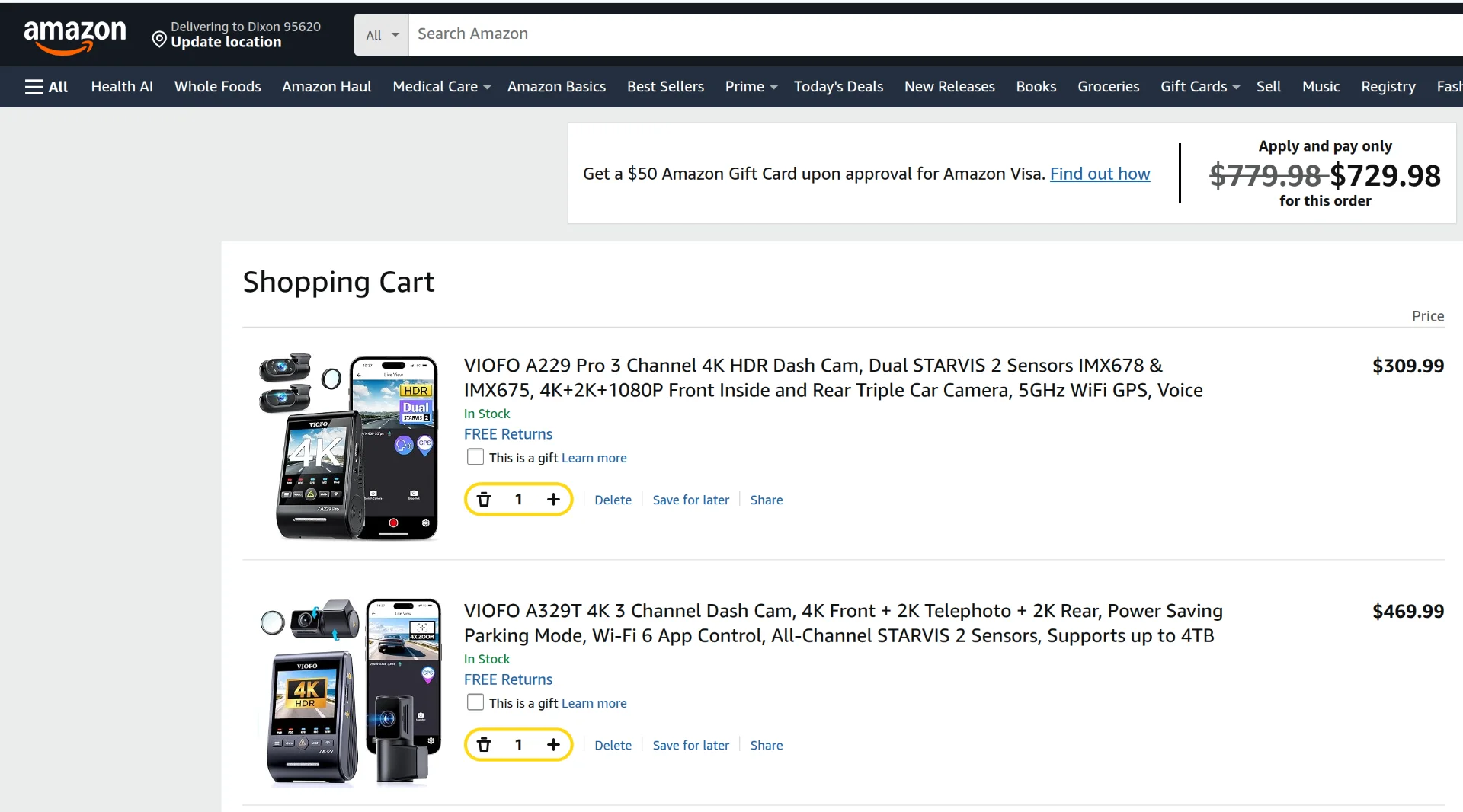

Maybe the Viofo A229 Pro would work?
Welcome to the club.
A229 Pro was best of the best for 2024.
In 2026 not so much, it's got (2) Achilles' heels the A329S fixed.
Of course I don't know what your budget is.
$310 A229 Pro 3CH (Rear & IR Interior)
$470 A329S 3CH (Rear & IR Interior)
$470 A329T 3CH (Rear & Telephoto)
Q: Is A329S worth $160 extra?
A: Only you can decide.
-Chuck

What are the achille's heels that the A229 Pro has, if you're okay with me asking?
I thought you'd never ask 🤣
Two biggest issues;
1.) Front camera Bitrate is cut in half when IR Interior camera is connected.
2.) Lack of modularity for both remote cameras
a.) IR Interior Camera Cable & Connectors: 3.5mm TRRS to Type-C
b.) Rear & Telephoto Camera Cable & Connectors: Type-C to Type-C
Minor Issues;
1.) Rear & Telephoto cameras have separate processor built-in that complicates firmware updates.
2.) No “clip-on” CPL Filter for Rear Camera, (semi permanent only).
Sometimes you need to remove the CPL Filter to clean the lens from dust build up.
3.) “Slow” Wi-Fi Transfer Speeds
10MB/s (430MB) 44 Seconds A229 Pro (2023)
33MB/s (472MB) 14.4 Seconds A329S (2025)
4.) No LPID (Low Power Impact Detection) Parking Mode
5.) A329S gets upgraded GPS Module for greater accuracy, and faster satellite connection.
A229 Pro Test & Review
A229 Pro Improvement Wishlist
The A329S fixed the two biggest issues by maintaining Front camera Bitrate when remote cameras are connected.
And going back to MCX Coax Cables for all remote cameras.
Now any remote camera can be used with any camera output on front / main unit.
This provides maximum user flexibility with the (4) different available remote cameras, (Rear, Waterproof Rear, IR Interior, Telephoto).
The minor issues were also fixed.
All processing is done by front / main unit.
Rear Camera gets clip on CPL Filter.
A329S Test & Review
