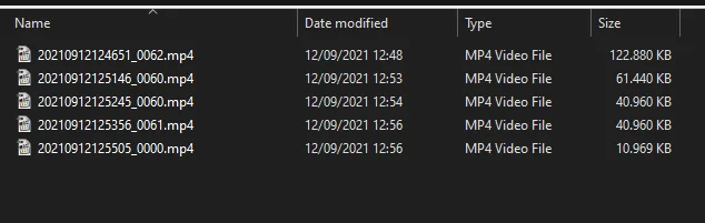

Ok. Time to update. My new SD card arrived. And the problem persists. Only the first footage (first minute) was properly recorded. The subsequence footages are invalid. The SD card itself doesn't have any problem. I can read, modify, and even reformat it like usual. These are the files when I check my SD card.
The top one is the valid first minute of footage. Resulting in a file around 122 MB. The subsequent footages only have 40-60 MB. Does anyone ever face this kind of problem on Z40 or any other DDPAI devices?
Oh... And it's quite often showing an "SD Card Malfunction" message on the display.

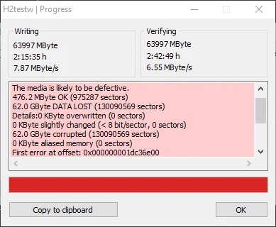

And now I know why this happens. This new SD card is a counterfeit one. The actual size is only 500 MB (duh). I guess I got scammed.
