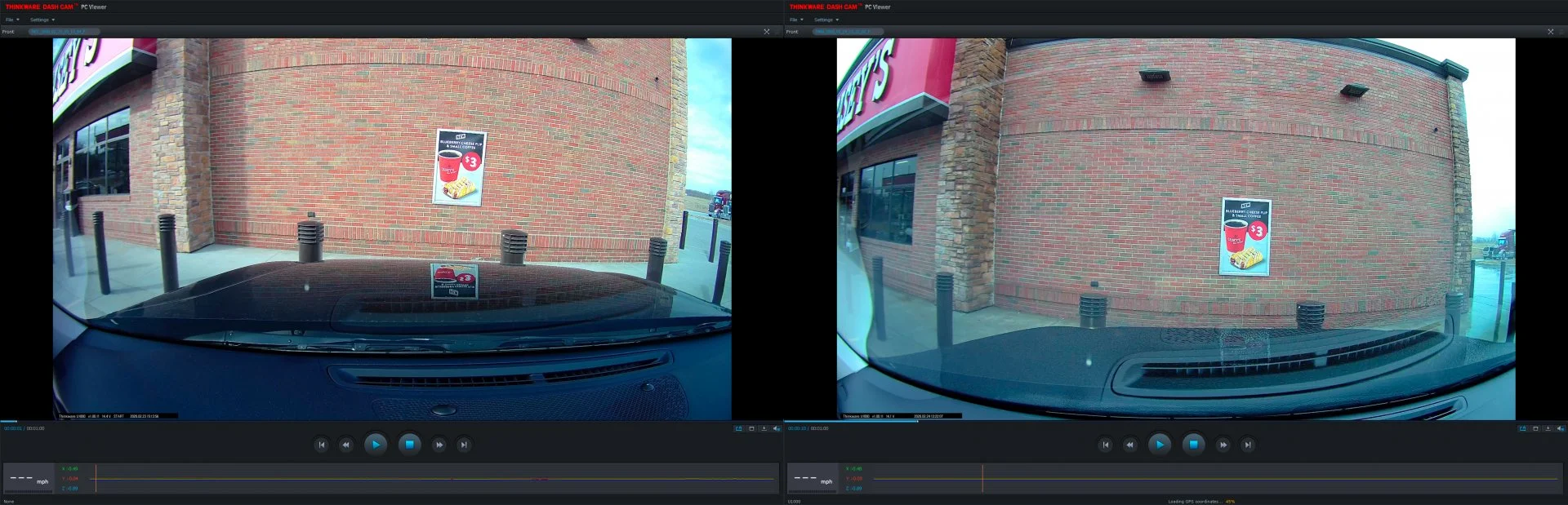

About ready to throw in the towel on my u1000. Left third of image is illegible, right third looks great. And wifi is constantly blinking (and on I suppose) while driving. Wondering if it is affecting my bit rates. Any way to turn wifi off?
Are you able to show a video or at least a screenshot of the video so we can see what you mean please?
Also the WiFi is on all of the time as it's looking for WiFi Hotspots as you can store around 40 in it's memory.
As @Maddog1974 said, please share a video clip as we'd be happy to try to resolve your issue 🙂
Thank you kindly for the help. Tags of people passing me on the left are illegible, those passing me on the right are fine. Here is a screenshot that really helped illustrate the blur on the left third. I've shifted camera from right of RVM to middle of windshield to left of RVM now and left third was always the same.
Something definitely looks off, do you have a CPL filter installed? which firmware version are you using? The screenshot just barley cut off the timestamp so I'm unable to check. Lastly, which recording mode was the dash cam in during this screenshot?
Yes I have the cpl filter installed, hadn't thought about removing it but I can do that and go back to the same gas station to see how it changes. Firmware 1.00.11 and this was in continuous mode.
Please try recording without the CPL filer. If the issue persists it's most likely due to a lens issue, and if that is the case we would be happy to exchange your unit.
Here is with CPL (On left) and without (On Right) seems about the same to me. Let me know what you think.
The left side of the image without the CPL does look sharper. The gas station sign and bricks on the left side of the image look more in focus. However, the camera angles and lighting are not identical. But I do think the image without the CPL does look better.
Something to keep in mind is that the focus points will always be near center. Anything near the edge of the frame (ex. the gas station sign) will not be as focused as the center.
We would be happy to send you a replacement CPL or do a warranty exchange as well.
Let me know how you'd like to proceed. 🙂
Thank you for your help.
Adorama was kind enough to overnight me a replacement and there is a night and day difference between the two. Couldn't read tags coming at me at 65 mph and now no problem at all.
Interestingly the second camera was manufactured in Jan 2020 and had an extra piece of protective film around the lens area that the first one (Manufactured in Oct. 2019) did not. Both had film over the lens itself but the newer one had the additional one. Both boxes were sealed so no idea why the difference.
Glad Adorama got you sorted out!
We did add more protective films on the U1000 to prevent the plastics being scratched during the manufacturing process. You most likely received a device with a faulty lens. Hope you enjoy your new U1000 🙂
