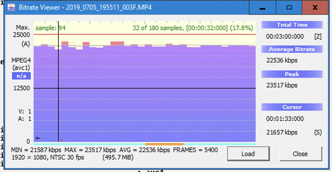

Yes I just saw was MOD2WI from the file so custom firmware - it looks like the encoder is choking at high bitrate in that release of the firmware as you can see the peaks where the missed frames are and 38 dropped frames out of 5400. What card was it?
The new wave of 4k cameras capable of high bitrate recording are going to cause lots of issues for people with slower / older cards (not saying you have one but a general observation).

I am using Viofo 128GB MLC card,tested with 2 other Samsung Evo Plus too with same results..
Can bitrate viewer tell you how many dropped frames there are in a video file?
