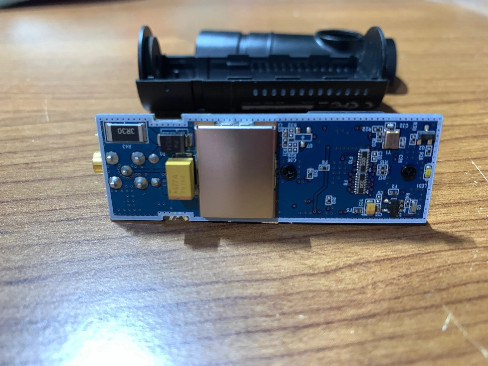

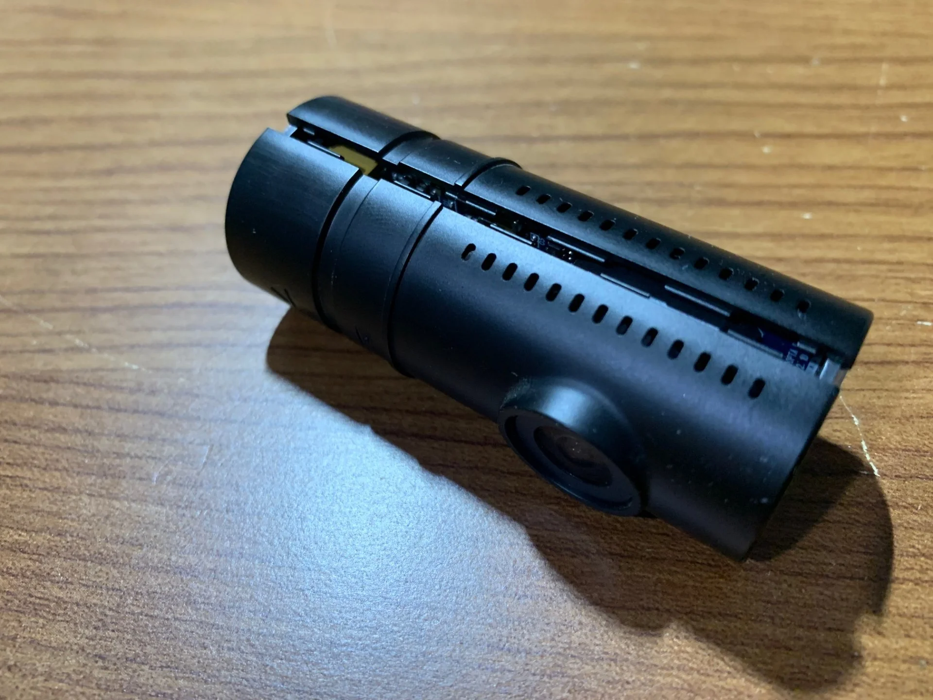

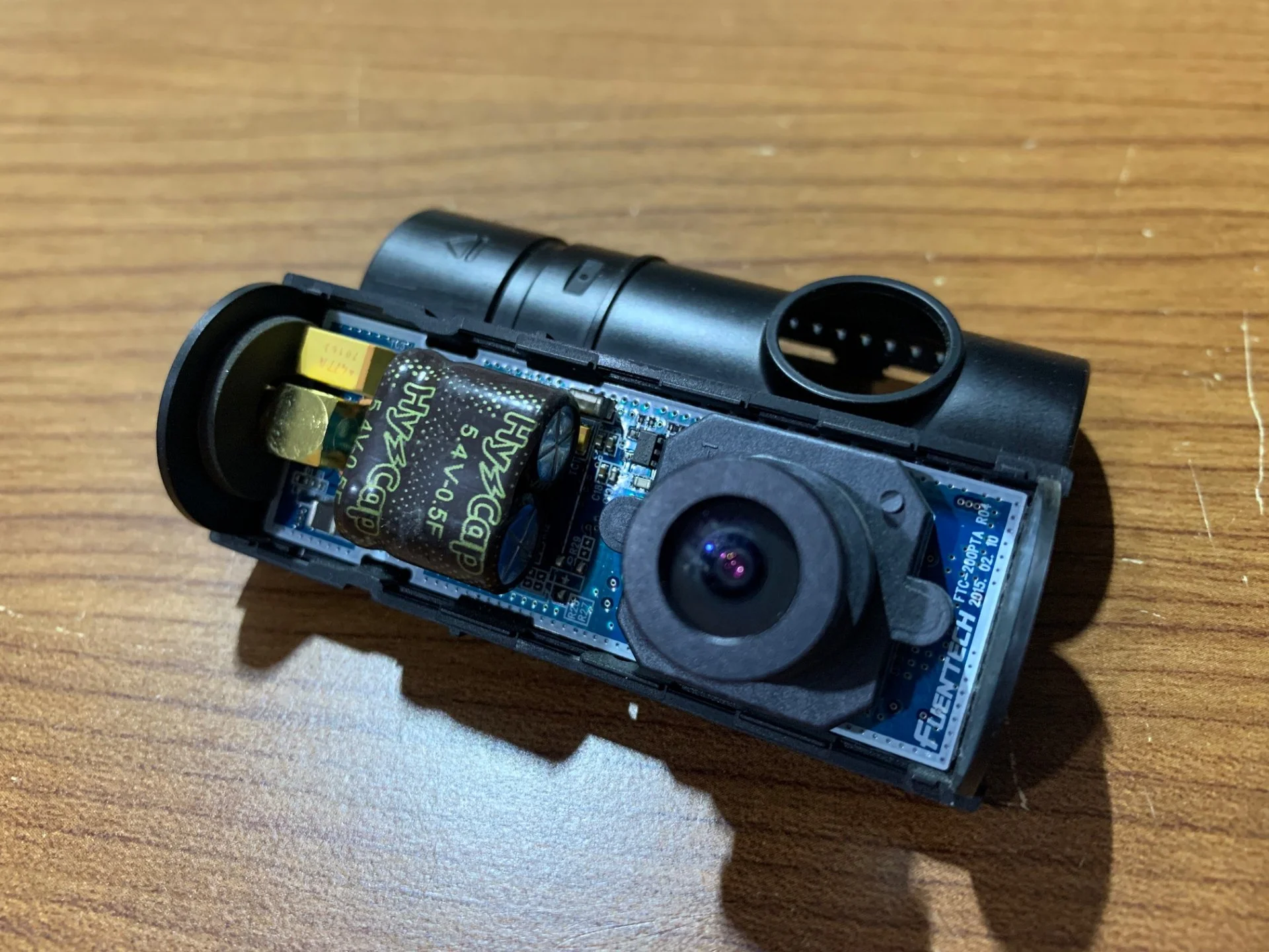

I ended up figuring out how to take it apart, now just need to see whats going on and how. but everything looks fine at first glance.
Its all plastic clips, just need to use something thin like a plastic guitar pick to spread it apart where both sides meet up.
Thanks! It worked! I was afraid I might break something if I just pried it open. I was able to open it and clean my foggy lens. Now my rear camera is back in business. Appreciate your help!
