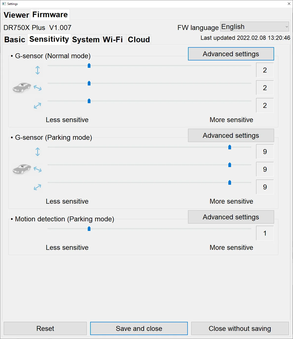

While reviewing video, I was seeing a large number of normal mode driving impact events ( _EF, _EI, _ER ) files. After I added the CM100LTE, I noticed my phone was alerting A LOT during the first driving segment of my trips. After I would park the vehicle and the dashcam went into parking mode and then I started driving again, the insane number of impact events went back to normal (small number or none).
I have the G-sensor settings for driving mode set to 2,2,2. The parking mode G-sensor settings are 9,9,9.
View attachment 59817 View attachment 59818
As a test, I decreased the parking mode settings to 5,5,5 and went on a test drive. The number of normal driving mode impact events went way down.
I restored the parking mode G-sensor settings to 9,9,9. On 10-Feb-2022, I went on a short trip into town. Just about every 1-minute segment of the drive was considered a normal mode impact event (see file listing screenshots included below). I parked the car for just over 45 minutes. On the trip back home, I drove over the exact same roads and there were no alerts being generated and all of the video files were "_N" normal driving mode video files.
On 11-Feb-2022, I went on a much longer trip (almost 30 miles round trip). The same pattern was observed. The driving segment when I left my home and drove to the first stop (of four), the number of alerts and normal mode event files was outrageously high. After making the first stop and letting the dashcam go into parking mode, the remaining normal driving segments only generated normal recording files.

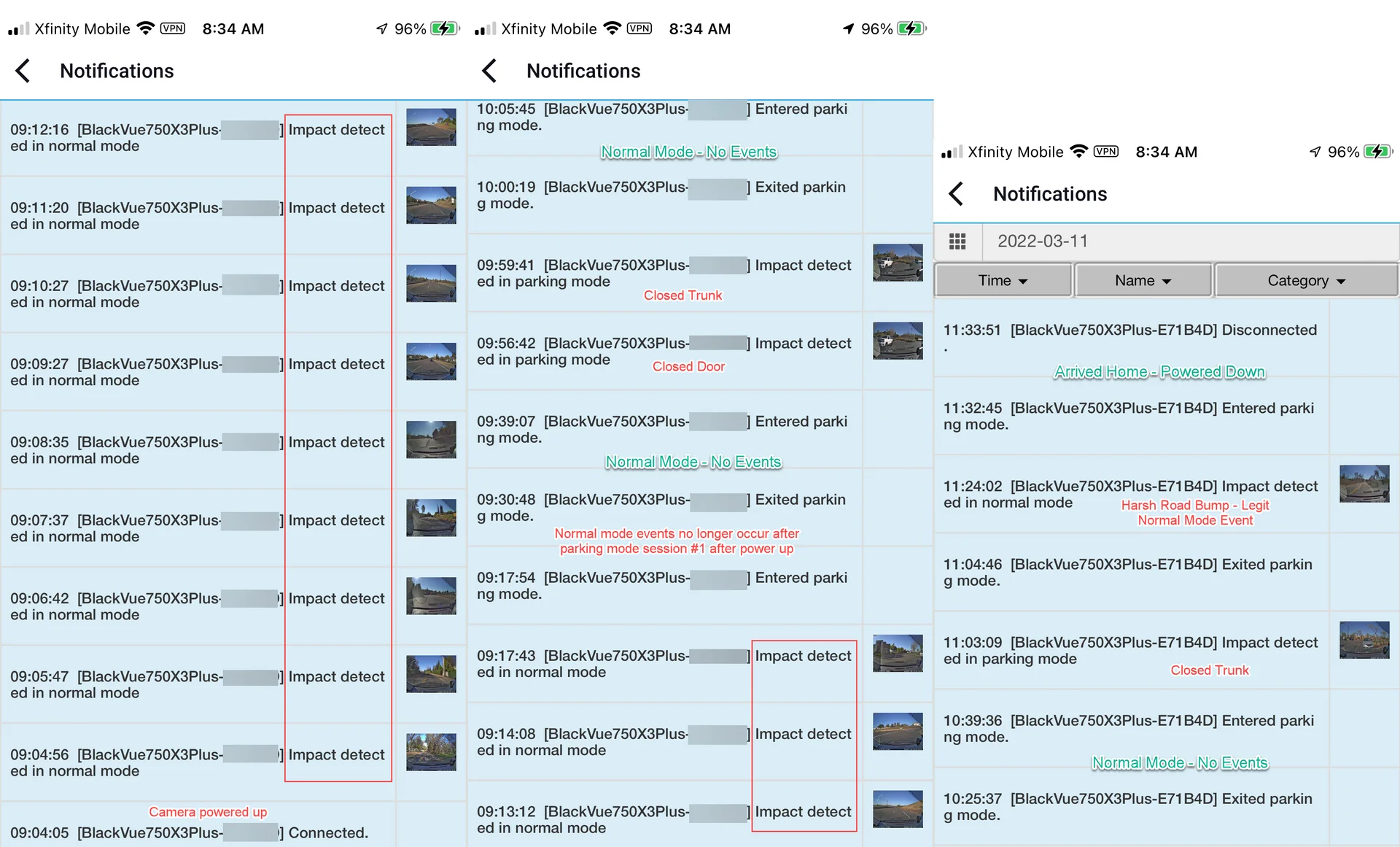

Here are screenshots of the files from the 10-Feb-2022 trip into town. The first red outlined set of files are the impact event files while driving into town. The second red outlined set of files are the normal mode video files driving back home.
On 12-Feb-2022, I created the post in this thread that I've quoted in this post about a strange behavior I've been observing with the DR750X-3CH Plus and DR750X-2CH Plus dashcams that I have installed in my car.
The erroneous event file creation after initial dashcam power up (normal recording mode events) through the first parking mode session continue to occur. There are so many push notifications being generated by the DR750X-3CH Plus events, that I get a question from iOS asking if I wish to mute the push notifications because there are so many of them in such a short period of time. The other part of this issue is that the dashcam is uploading these event files to the BlackVue Cloud consuming far more of my monthly 2GB of 4G LTE data quota than I would like since they are bogus events.
I've driven on specific routes to see if the erroneous normal mode events only occur between initial power up and the first parking mode session or if they occur each time I drive that stretch of road.
On 15-Feb-2022, I performed the most detailed test of this issue. The basic premise of the test was to power up the dashcams, drive a specific route to a location where I allowed one of the dashcams to go into parking mode (DR750X-3CH Plus powered by 3-wire hardwiring cable / battery pack) and not allow the second dashcam to go into parking mode (DR750X-2CH Plus - parked less than 5 minutes and powered by cigarette lighter / power port adapter and B-112 battery pack). I drove to a destination midway along the same route and parked for more than 5 minutes (allowing DR750X-2CH Plus dashcam to go into parking mode for the first time on this test trip). I then drove back to destination one, I then turned the car around and I then drove on the same roads back home.
The test results from my 15-Feb-2022 test supported my pre-existing problem statement. If the problem were the roads I was driving on the erroneous events would continue to occur, but they no longer occurred after the dashcam was allowed to enter/exit parking mode and then drive on the same roads.

Here are the events from my 11-Mar-2022 weekly shopping trip. The driving segment from my home to the first destination is littered with "Impact detected in normal mode" notifications. There are only a couple of 1-minute segments without an impact event and that's because the car was stationary (at a stop light or in a fast food drive thru line). After the first parking mode session takes place, normal mode recordings are "normal" again. I did have one additional impact event in normal mode at 11:24:02, but that was due to a harsh bump (harsh up/down motion detected by the dashcam) and it was a legit event.
When you view the "event" videos in the BlackVue SD Card viewer program, the "G-sensor" panel shows that none of the X/Y/Z motion values violated the "2" normal mode g-sensor sensitivity setting.
If I drive on the same roads that the dashcam thought were "Impact detected" worthy after entering and exiting a parking mode session, no impact events are detected by the dashcam (DR750X-3CH Plus or DR750X-2CH Plus). As part of my 15-Feb-2022 road test, I made sure I drove the same roads before and after the first parking mode event to prove that point to Pittasoft.

With regard to the G-sensor problem after power up and before the first parking mode session, I wanted to see if the problem was common to multiple BlackVue dashcams or specific to the DR750X Plus dashcam series. Based on my test findings, only the DR750X Plus series dashcams suffer from this problem.
Test Setup
  • BlackVue X series 3-wire hardwiring harness was used to provide power to the X series dashcam
  • BlackVue Android app v3.31 is used to configure the dashcam’s sensitivity settings from whatever they were before to “2,2,2” for normal mode and “9,9,9” for parking mode.
  • After configuring and saving the firmware settings change, the dashcam is fully powered down (no constant power, no accessory power).
  • I only used the front dashcam in my test to reduce the number of video files generated
  • Dashcam is powered up and enter normal recording mode
  • Dashcam is left sitting motionless on a desk/table for a short period of time
  • The dashcam is gently moved in all three directions (X/Y/Z) enough to register with the g-sensor, but nowhere near enough to trigger an “event”
  • The gentle motion continues with some periods of no movement for a few minutes
    • This is to allow the dashcam to create several different “normal mode” or “event” files
  • Dashcam is placed into parking mode by removing the accessory power – for about 30 seconds
  • Dashcam has the accessory power restored to have it exit parking mode and return to normal recording mode
  • The same type of gentle movements are executed again (just like before parking mode)
