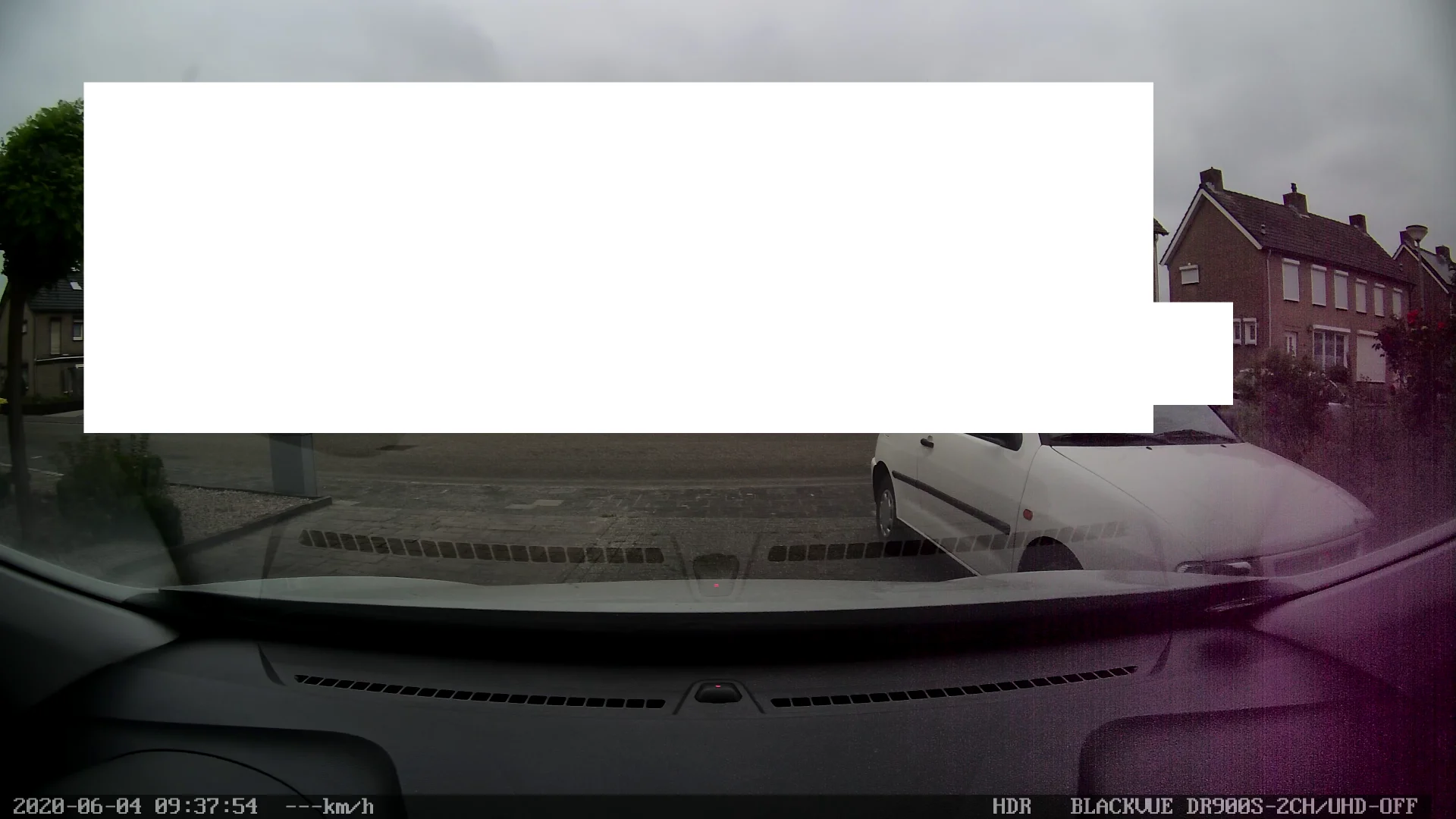

I bought 2 Dr900s 2ch 16gb kits from amazon one to upgrade my existing kit the other one to install on my mothers car so my mother and brother now both have dashcams installed. the dr750s set i already had is working fine in my brothers car however these 2 dr900s kits have some issues
I noticed a weird purple artifacting glare that shows up from time to time both in parking mode and while driving in the bottem right corner on both front cameras.
I run the cameras with the HDR night vision option enabled brightness setting 3.
The codec setting i use is Hvec 265 and quality settings are at extreme
Both cameras feature a 128gb samsung pro endurance micro sd
Both kits came with the latest Dr900s firmware installed both seem to be the UK version i can see on the box.
I have tested if the purple glare would show up when i watch the same footage on my smartphone as to make sure it is not a driver related issue with my computer i also updated the codecs with the latest Klite pack and the AMD radeon drivers just to make sure.
however it still shows up the purple glare on both my computer and smartphone.
it happends on both DR900s front cameras at exact the same spot.
I have reinstalled the firmware on both cameras with the same latest firmware version 1.012v to see if that would fix it but it still shows up.
I have added a few images and removed some stuff so i dont invade other peoples privacy too much.
I hope you guys might know what causes this problem and if it is a defect or something else.

Thank you for your response. I will contact them today. Not good that both dr900s cameras have this right out of side of the box. :/
i put in 3 screenshots more of a open scene:
apart from the purple artifacts can you tell me if the sharpness is upto the dr900s standards?

Well, well, well, what do we have here? This is much more than just a sensor failure, it seems like a design flaw. :) Other examples here.
Ad the sharpness, it looks quite blurry to me. Try to turn the camera off, wait few minutes, turn it back on and compare the footage before and after. The reason why here.

I have the same problem with my 900s. I reported the fault to the UK distributor and they confirmed a faulty sensor. Unfortunately the camera was only a 6 months out of its one year warranty, the UK distributor stated they would need to ship it back to South korea for repair and I should get the camera back after 8 weeks. The original thread here https://dashcamtalk.com/forum/threads/partial-red-cast-flash-on-video-footage.40665/ Not impressed :(

Just thought of providing an update! Previously I was informed that the issue I was experiencing was due to a faulty CMOS filter (in having a red case for a few seconds flash on the video footage) original thread https://dashcamtalk.com/forum/threads/partial-red-cast-flash-on-video-footage.40665/ I returned the camera back to the UK distributor to get it repaired (after agreeing a cost of £36 + plus the cost to posting the camera to them). Only to find today after calling them on the phone (not received any update for over two weeks), that there is nothing wrong with the camera and they have not ben able to find any faults with it from there tests!
The Support guy asked me if my car has a heat resisting windscreen, if so then there is a incompatibility with the High Dynamic Range (HDR) mode on the DR900S and windscreens that have heat resisting coating.
I confess this is a new one to me, also he mentioned that HDR only benefits the night mode and that HDR should be switched off for normal driving! I have never heard of this issue being reported before! Has any one else heard of it?

I recently reviewed the DR900X-2CH (which has the same camera as the DR900S) and I encountered footage with red/purple flares occurring at certain locations with the sun shining into the car at a particular angle.
I contacted Pittasoft support about the issue and I was instructed to turn off the HDR Night Vision feature (by setting to off or on only for parking mode). I did make that change (on only during parking mode) and it did seem to resolve 99% of the red/purple flares I was encountering. I don't know/believe that my windshield has a heat resistant coating. It's an ex-police car (2014 Chevy Caprice PPV).
