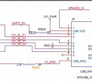

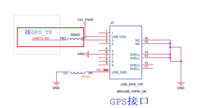

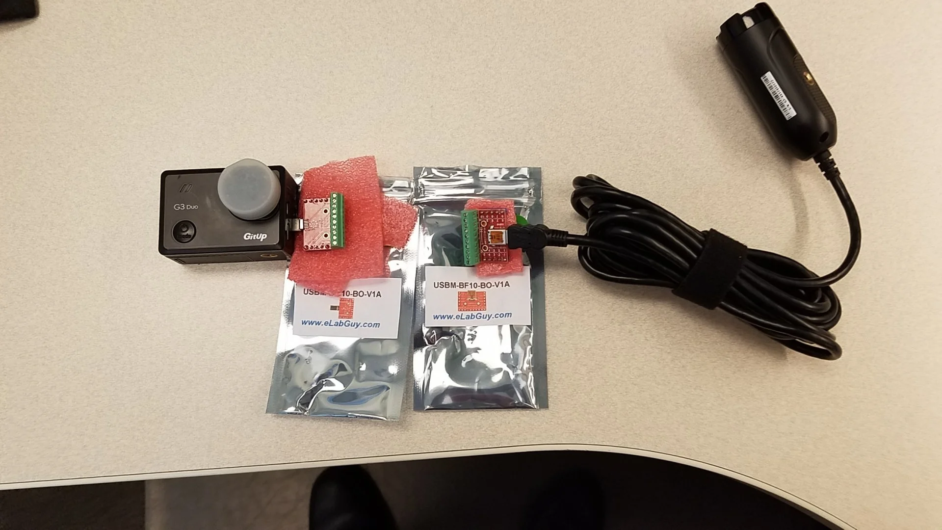

Hello everyone,
I'm still working on a solution to extend this dual cam cable. Please see attached photo. I've acquired a couple of 10-pin mini USBs breadboards, male and female with hopes of manually cross-connecting the necessary pins with wire jumpers.
Is this possible, I can't tell from the diagram what pins should be cross-connected where?

Maybe is possible to cut the original cable and extending it with another piece of cable from VIOFO A129 Duo rear cable? @gitup ?
