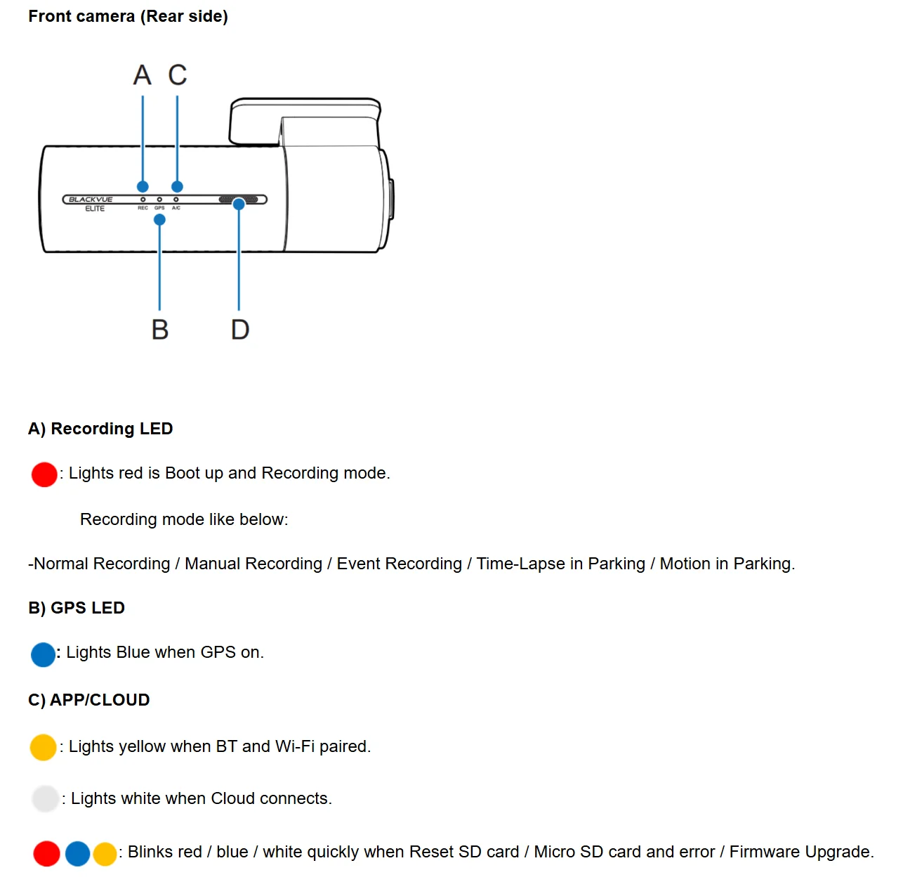

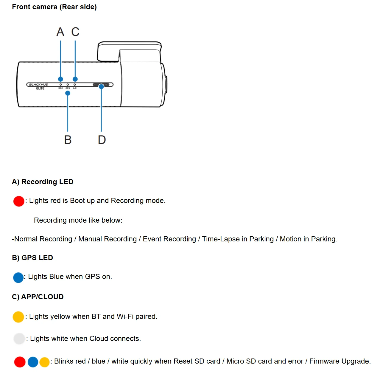

The web documentation for the three LEDs on the back side of the Elite 9 front camera is included below.
The "Recording LED" does not produce a green color at any time. The REC LED turns red when the Elite 9 is recording. For motion detection parking mode, that means the REC LED turns off when it first enters parking mode. When motion is detected, the REC LED turns on solid red for the time period it is recording video for that motion event and then it turns off again.
I've never agreed with the colors listed for the "C) APP/CLOUD" LED for any BlackVue dash camera. It lists white as the color when the dash camera connects to the BlackVue Cloud service. It actually turns green when it's connected to the cloud [see picture below]. It turns white when your phone is connected to the dash camera's WiFi with the BlackVue app. I'll have to send an email asking about that discrepancy.

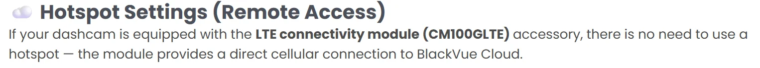

With regard to setting up the WiFi hotspot settings for connectivity to the BlackVue Cloud service, I've not tested that feature for a long time. The web manual states that if you have the CM100G LTE connectivity module you don't need to use the hotspot settings, but I don't know if that means they are mutually exclusive. @Vortex Radar may have more recent info/experience with this configuration.
https://manual.blackvue.com/docs/el...-settings/📱-settings-with-the-blackvue-app-4/
https://manual.blackvue.com/docs/elite-9-series/managing-settings/📱-settings-with-the-blackvue-app-4/

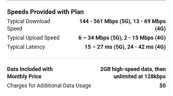

The T-Mobile's documented transfer speeds for this SIM card/ plan are:

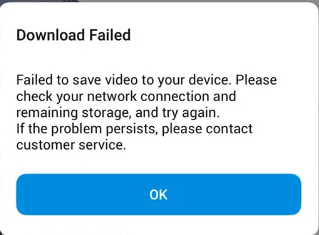

  • Attempt 2: After a long delay, the download failed
