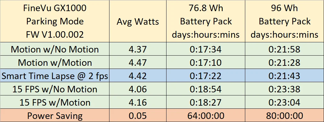

GX1000 power consumption results added 03-Jun-2024
Parking Mode - Time Estimates
I updated post #1 with additional details for the FineVu GX1000 parking modes (Motion, Smart Time Lapse, 15 FPS and Power Saving).

I added my power consumption testing results to an early post in this thread. https://dashcamtalk.com/forum/threads/finevu-gx1000-test-review-rcg.48561/post-590300
Here's another copy of my parking mode time estimates for the GX1000, but these results are from when it had firmware v1.00.02 installed.
The Motion and 15 FPS only record when there is motion within the field of view of the cameras. Smart Time Lapse records time-lapse video only at 2 fps. Each smart time lapse video file is 20 seconds in length which equals 5-minutes of wall clock time (with no audio). The Power Saving parking mode will use the least amount of power, but it takes 5 to 6 seconds for the GX1000 to wake up and start recording after an impact event. You can see all of the various parking mode characteristics in the "Notes" column of my early post with the full power consumption test results (see link above).
If you want to have the GX1000 capture all parking mode activity around your vehicle, then your only option is to use the smart time lapse parking mode.
