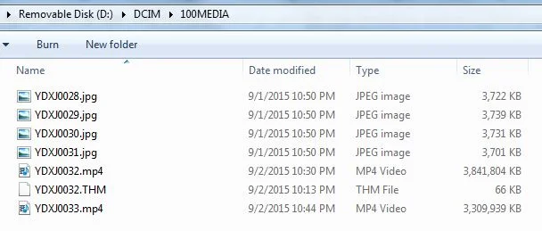

I really don't get your point ? Why the heck you are using exFAT instead of video files of 3.66GB with FAT32, so my answer to your "...I can't write over 2gb" is "Then try to not cancel the video, leave it to record for about 10-14 minutes and you'll see that the first generated file will be 3.66GB 🙂"

For others interested, I have just tried with 23L and it works fine:
Code:
# fw 1.2.6 (tested ok by @luckylz)
writew 0xC0396E64 0x2004
# fw 1.2.12 (tested ok by @cpurage)
writew 0xC03A8620 0x2004
# fw 1.2.13 (tested ok by @gente)
writew 0xC03A8520 0x2004
Did a 2k recording and files were broken into 3.93gb files 🙂
