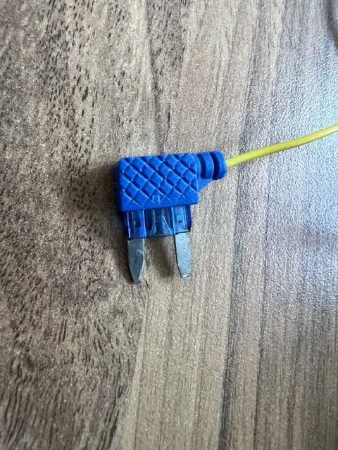

fuse orientation
msh57
Jul 9, 2026
1
preston,lancashire
fitting a cam for my son and the kit came with these fuse taping not sure which way round they go to give you fuse protection
Cut them off , connect the wire to a new fuse tap which you bought. Thats my recommendation.
I'm not sure the validity of this video, as "Fuse Polarity" has been debated quite a bit.... However, I I take it at face value. This should explain to @msh57 what he needs.
Top Fuse = Protects Camera
Bottom Fuse = Original Vehicle Fuse
@SafeDriveSolutions what's your input on polarity?
Polarity definitely matters since if it's installed backwards, one fuse draws current from both loads.
The common side of the fuse tap gets +12V power, and the current splits to each fuse.
There is a good picture that shows this if I can find it.....
