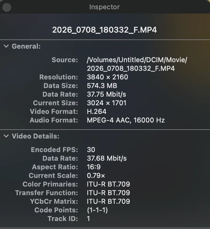

Hi, I haven't reviewed the video in a while and I witnessed a minor accident and I downloaded the video to my Macbook pro, and the video is grainy. Is the dashcam sensor damaged, or something else? I should be recording at 4K 2160P / 1600P 30fps
Here's the video: https://drive.google.com/file/d/1VMOA4JBOHTU9YO0soVkSDr7KbVy0u0EE/view?usp=sharing
I've played the video both from videolan and quicktime player and the video quality is the same, grainy.
I've had this dashcam for like 4 years, and I am wondering if it's damaged from the summer heat.
video is grainy
