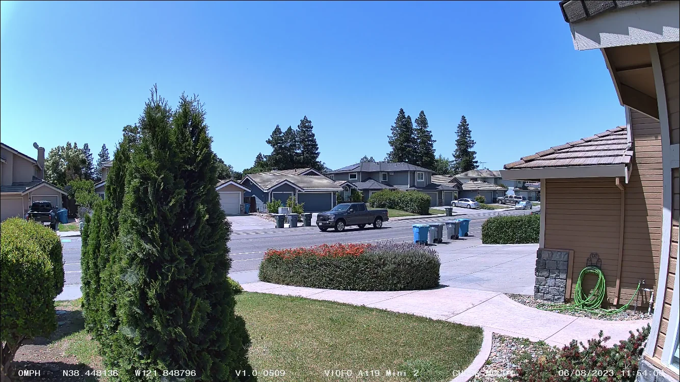

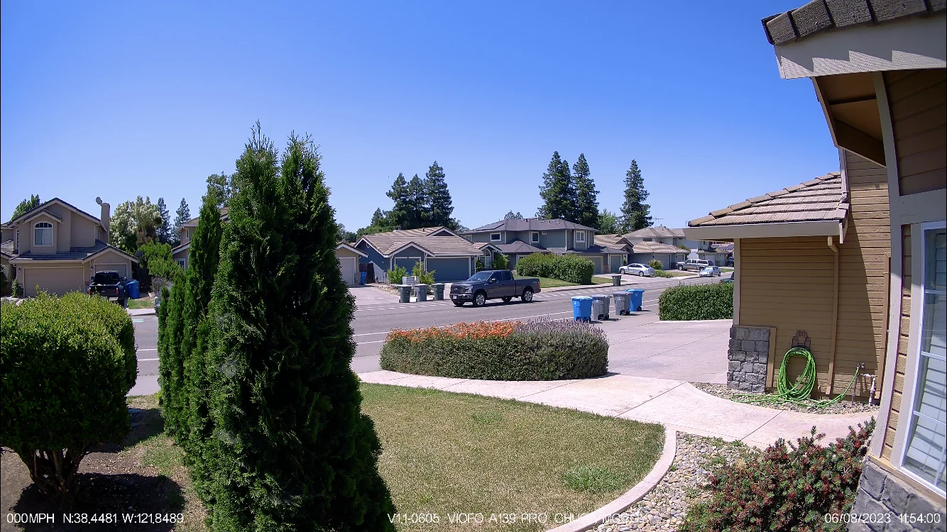

Outdoor Focus Check
Camera Settings:
A139 Pro: 2023_0605 (3840 x 2160) 30fps Bitrate: Maximum 60Mbps HDR: Off CPL Filter: Off
A119 Mini 2: 2023_0509 (2560 x 1440) 60fps Bitrate: High 30Mbps HDR: Off CPL Filter: Off
Here’s the file sizes for the 1 minute clips.
Here’s the 1 minute clips;

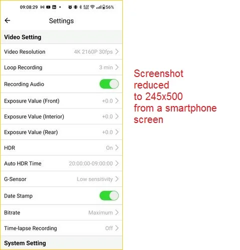

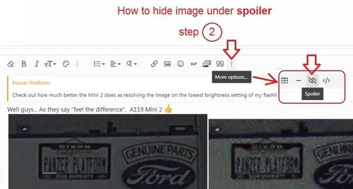

Everything is very simple. 😉 Look under the spoiler:
How to hide image under spoiler
Why do you need to hide pictures under the spoiler - if the horizontal format of the photo (and video)
does not cause inconvenience, then very long vertical pictures of 931x1900 in size just kill.🙁
They take up half a page and it is terribly inconvenient when viewing pages on the forum.
If you cannot reduce the size of the picture (for example, to an acceptable size no more than 500 pixels high):
- just hide this picture under the spoiler.
Please respect forum members. 🙂

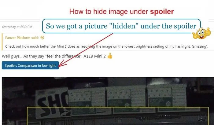

Next, I posted the steps on how to hide the image under the spoiler.
But it is convenient to do it on a PC.
For a smartphone, a slightly different technology:

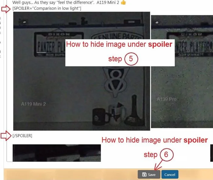

open your post for editing and enter the text in square brackets [ SPOILER ] before the picture and [ /SPOILER ] after.
(Note. The word Spoiler is written without spaces after and before square brackets, I made spaces on purpose, because I have the text immediately turned into a spoiler) 😆
And you will succeed!
In order for the spoiler to be with a caption, simply add the text you need under square brackets
(which you place before the picture) in this format (highlighted in red): [SPOILER="Comparison in low light"]
Hope I could help someone
See how I did it: here

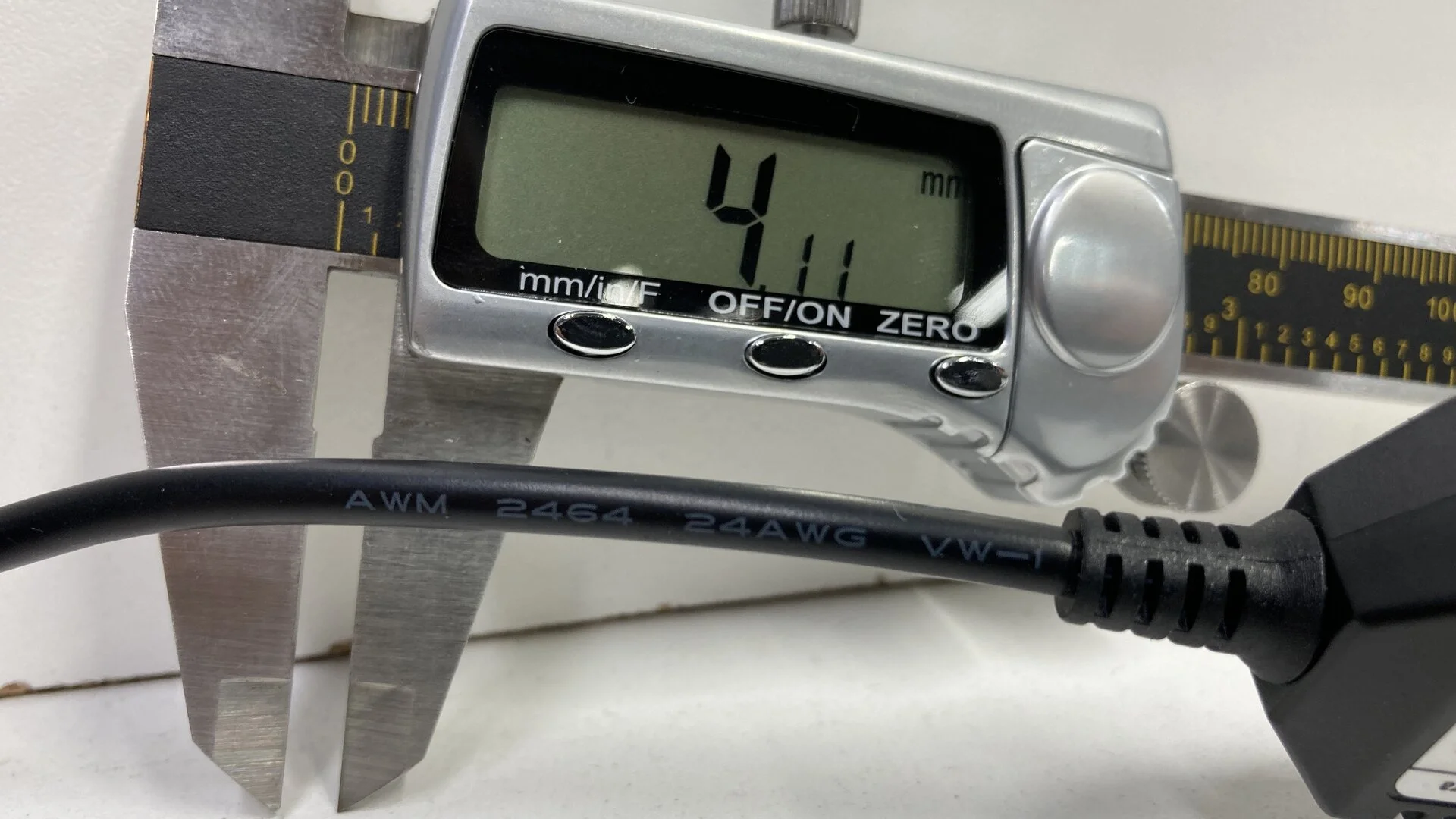

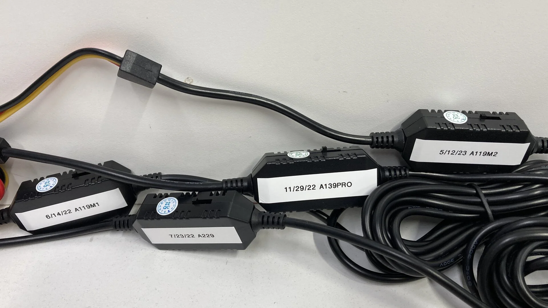

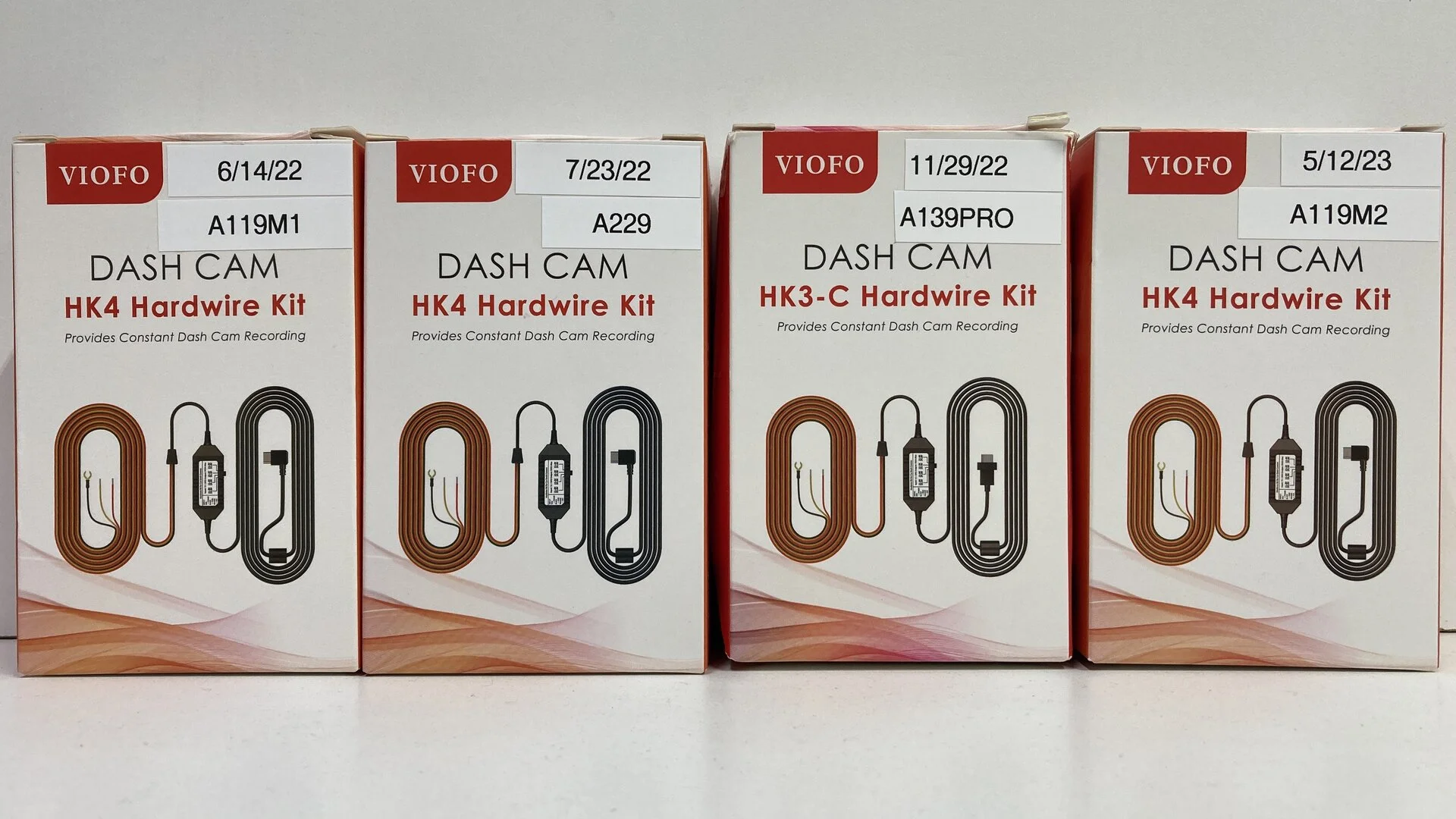

I tested the maximum power output of the new & improved Hardwire Kit specifically designed for the A139 Pro.
In this post I will attempt to confirm & verify the listed power output specifications of hardwire kits that were sent with the following cameras, see attached photos;
6/14/22 A119 Mini 1
7/23/22 A229
11/29/22 A139 Pro
5/12/23 A119 Mini 2

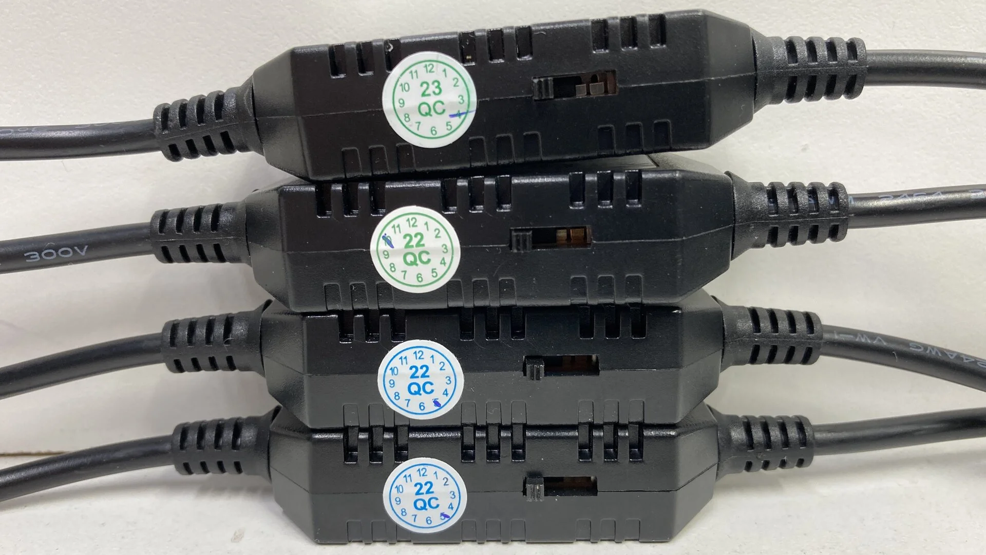

All three HK4 kits have an identical UPC code of 94044-00061.
The HK3-C that was sent with the A139 Pro has a UPC code of 94044-00048.
All hardwire kits have a listed power output specification of 5V2A MAX.
All hardwire kits have a “Quality Control” date code sticker indicating when it was manufactured.
The indicated dates of manufacturer correspond when I received the cameras.

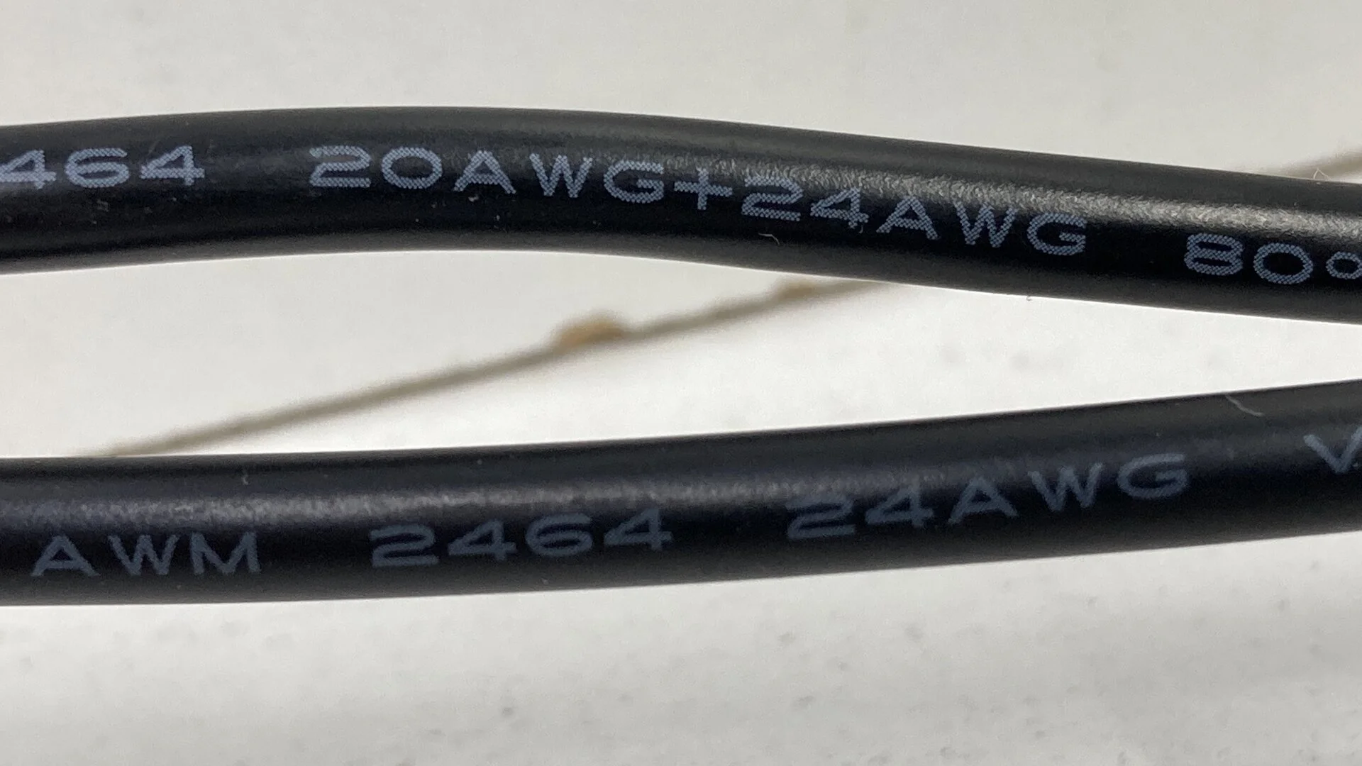

The HK4 kits I received with the A119 Mini 1 & A229 are constructed using 24AWG gauge wire.
The HK3-C & HK4 kits I received with the A139 Pro & A119 Mini 2 are constructed using “20AWG+24AWG” gauge wire, (see attached photos).

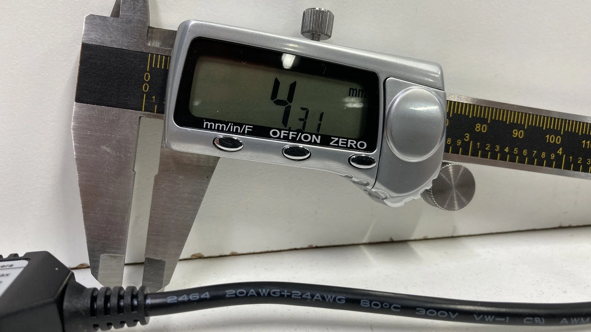

The diameter of the 24AWG gauge wire is 4.11mm.
The diameter of the 20AWG+24AWG gauge wire is 4.31mm.
To obtain the maximum power output of each hardwire kit I’ll be using my;
1.) WANPTEK Power Supply set at 12.60 Volts @ 5 Amps.
2.) DROK USB Load Tester set at 5.00 Volts, and I will crank up the Amperage Load to obtain the max power output.
Both 24AWG kits have an identical maximum power output of 2.3 Amps @ 5.0 Volts = 11.5 Watts
Both 20AWG+24AWG kits have an identical maximum power output of 3.5 Amps @ 5.0 Volts = 17.5 Watts, (an increase of 6 Watts).

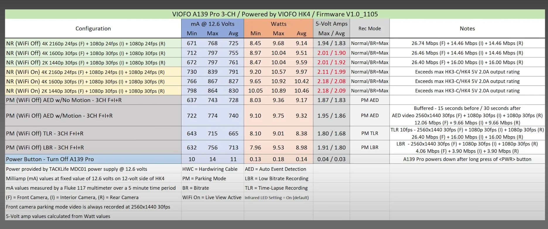

The maximum power consumption of the A139 Pro in 3-channel configuration is approximately 11 Watts. Shoutout to @rcg530 for making these beautiful color coded spreadsheets documenting his power consumption testing, (see attached screenshot).

Here’s videos performing the power output tests;

After 7 lazy months I got around to testing the maximum power output of the new & improved Hardwire Kit specifically designed for the A139 Pro.
In this post I will attempt to confirm & verify the listed power output specifications of hardwire kits that were sent with the following cameras;
6/14/22 A119 Mini 1
7/23/22 A229
11/29/22 A139 Pro
5/12/23 A119 Mini 2
Now, this is where it gets interesting.
What is going on here?
Is @viofo trying to save a few pennies by using 20AWG wire for constant hot positive & ground wires, and using smaller 24AWG wire for the switched ignition positive wire? (just use 20AWG for everything guys)
2.) DROK USB Load Tester set at 5.00 Volts, and I will crank up the Amperage Load until I hear the hardwire kits say; “Uncle!”
Both 20AWG+24AWG kits have an identical maximum power output of 3.5 Amps @ 5.0 Volts = 17.5 Watts.
This means the new & improved 20AWG+24AWG kits have an increased power output of 6 Watts, (that’s a lot!).

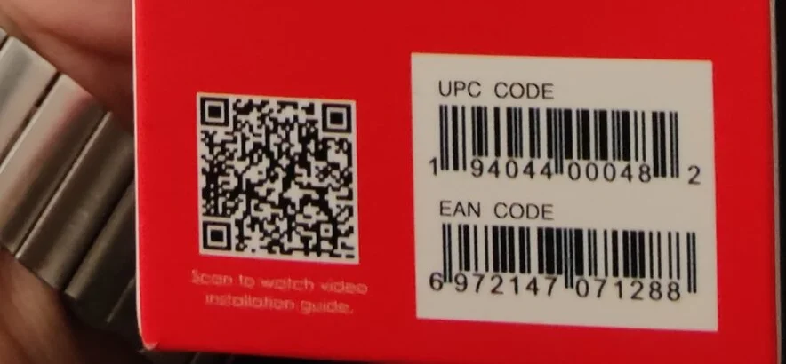

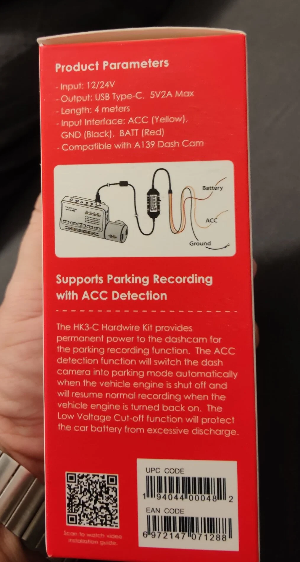

It appears to be possible to check by looking at the box. If the two photos attached – "Side Mug Shot" and "The Usual Suspects" – shows the boxes in the same left-to-right order... as it appears they are... then the third box from the left in the "Usual Suspects" photo is labeled A139 Pro in the photo. Thus the third box from the left in the "Side Mug Shot" photo has a diagram of the A139 and the Hardware Kit on the side panel. So if you still have your Hardware Kit box, you should be able to confirm whether you have that version of the Hardware Kit.
BTW, FWIW, I ordered my A139 Pro and HK3-C kit directly from Viofo in April and the version they sent to me has the same box as the third from the left in the @Panzer Platform photos (with the diagram).
On one hand, I'd expect to be sent the latest back in Feb/March (I ordered from Viofo Benelux)
If it ain't broke, don't fix it. lol

I have an 'old' HK3-C that I bought separately to go with my A139, before upgrading to an A139 Pro. I just checked - it's 24AWG only. Thankfully I only run my camera in 2CH mode.
Thank you. What threw me off is that in the pictures, it's the only HK3-C kit. All the others are HK4 so there's no direct comparison between an "old" HK3-C and a "new" HK3-C kit. I'll check this afternoon if I have a diagram on my box (I saved it) but I suspect I don't.
