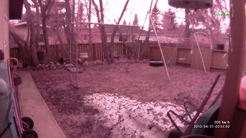

I've purchased a few dash cams lately that were all under $120, just received a GS1000 from DX and now trying to decide which I like best before permanently installing one in my vehicle. I'm very happy with the GS1000 although the recorded audio is noisy and the lens has a much narrower view at 1080p than the 120 deg. advertised. Having good audio is the least of my concerns but a wide angle view like the other cameras I have would make this camera my favorite so I decided to try a number of other lenses I already had which have no built-in IR filter. The manual spec's the existing lens as a F2 3.4mm and 3.4mm agrees with what I found comparing it to the 3.6mm and 2.8mm lenses I tried. A 2.5mm and 2.1mm were also tried comparing the resulting 1080p video image to what my F500LHD provides and the 2.1mm came close, but a 1.8mm would likely make the field of view nearly equal.
The main reason I replied however, is to answer DashCamMan's question "Are the colors all off without the IR filter?" and to provide the following daytime example using a lens with no IR filter that some have been waiting for.
There was very little difference between indoor Images taken with the original lens (with an IR filter) and those taken with lenses without an IR filter. Using a lens without an IR filter wouldn't affect outdoor night time images much either other than making the camera a bit more sensitive to what little light there is and allowing it to take advantage of any IR light that may be available. But from images taken with my unfiltered lenses using just IR illumination it's obvious that the gs1000 sensor (in my camera at least) is very sensitive to IR and from the image above taken with a 2.1mm unfiltered lens during the daytime when there's lot's of IR from the sun it's obvious that this camera requires a properly filtered lens. (Non-filtered lenses can often be used with much less drastic results as many cameras have a sensor that's either much less sensitive to IR or has a filter that provides at least some IR filtering bonded onto it. Even many IR sensitive cameras with IR LED's for night time illumination employ some IR filtering to make them suitable for outdoor daytime use as well). IR filtering is often provided by elements within a lens, but on my camera it's easy to see that an IR filter has been added to the rear of the lens and images taken using only an IR light source show that's it's extremely effective which of course makes the camera IR LED's totally useless. I'm guessing the filter was added to improve the day time image quality which is very nice, but in this case it would have been nice if the IR LED's had also been replaced with white Light LED's although any form of illumination from a camera within a vehicle is basically useless for improving images taken of things outside the vehicle.
My lens tests also revealed that the viewing angle is much greater for gs1000 still images which is where I'm guessing they got the 120 deg viewing angle spec from. The video viewing angle appears to be about half as wide. Not sure exactly why that is, but sure would be nice if it was as wide.

I replaced the lens on my GS1000 with a 2.1mm lens from DX. The angle of view is now 160 deg in 720p, and it should be about 140 deg horizontal in 1080p.
The lens does not have an IR filter, so now you will pick up IR light, and have better brighter night performance at the cost of IR light skewing up the colours.
