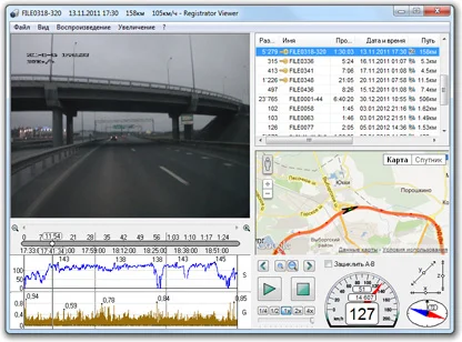

Re: Registrator Viewer
Vadikus said:
Registrator Viewer supports your dashcam now!
That pushed it into my cart, awaiting shipment now....
Thanks Vadikus!
