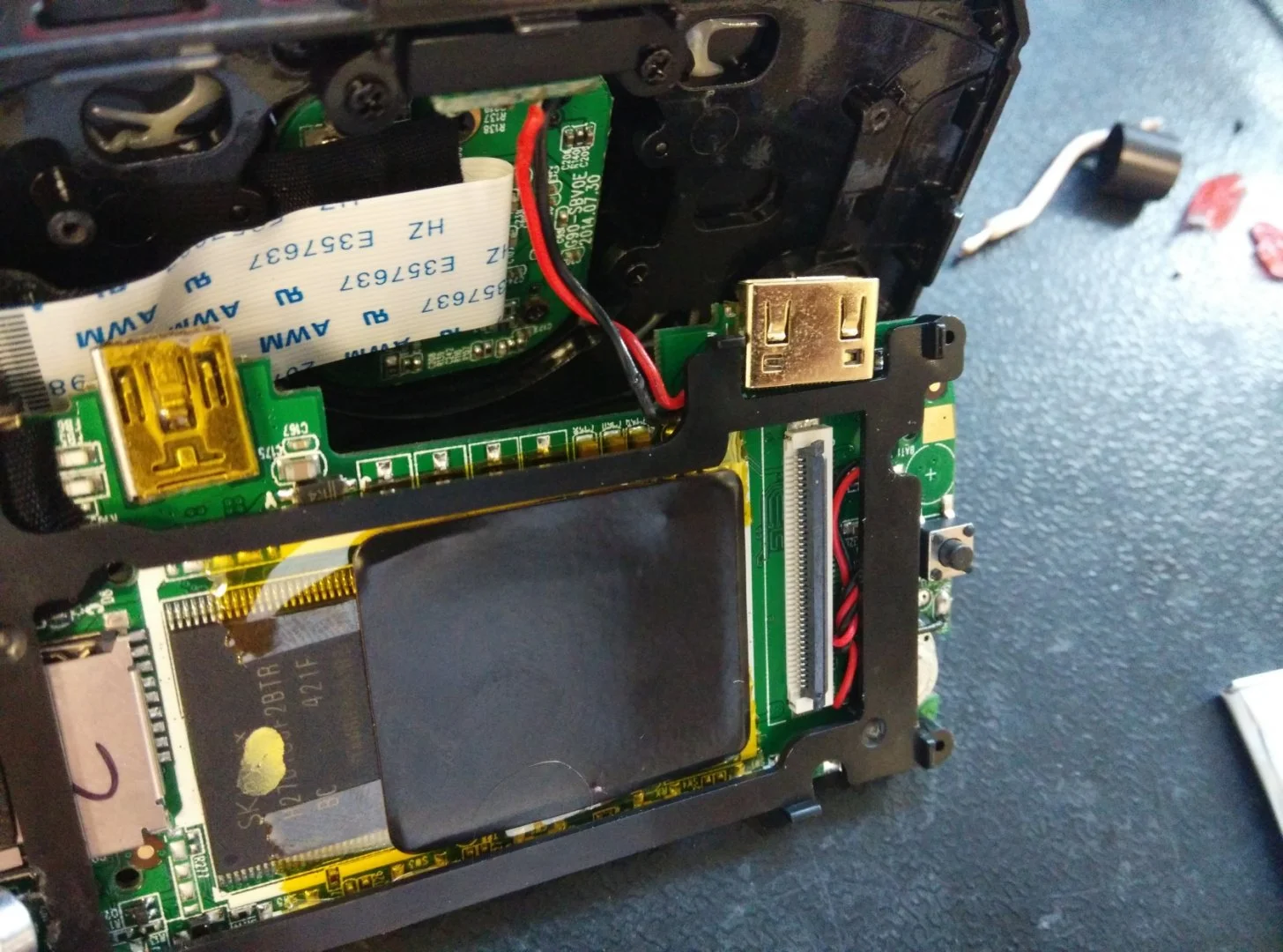

PPS: please take some pictures of the board, especially the charging part.
will try other button combinations with plugging PC cable
Charging/ power area OK - I work as electro-mechanic, assembling SMD parts to boards, repairing broken or bad soldered parts and making optical inspection

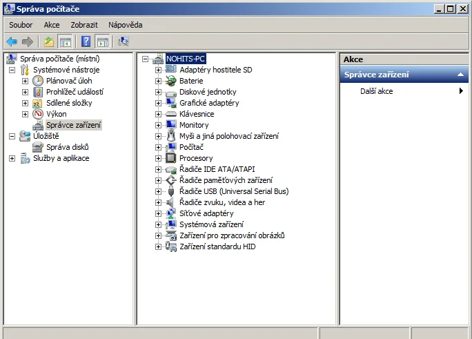

EDIT: so i tried all combinations of buttons and plugging PC cable - At Windows device manager nothing appeared
As I wrote, I had a similar problem (because I played with DirectUSB more than it was needed 😀); anyway I thought I killed the dashcam, but in the end it was detected.
Now, that you pressed the power button, does the LEFT button work ? Did it work ? Have you seen the Ambarella dev board detected in your "device manager" ?

At Device manager no unknown/new device - still like on picture

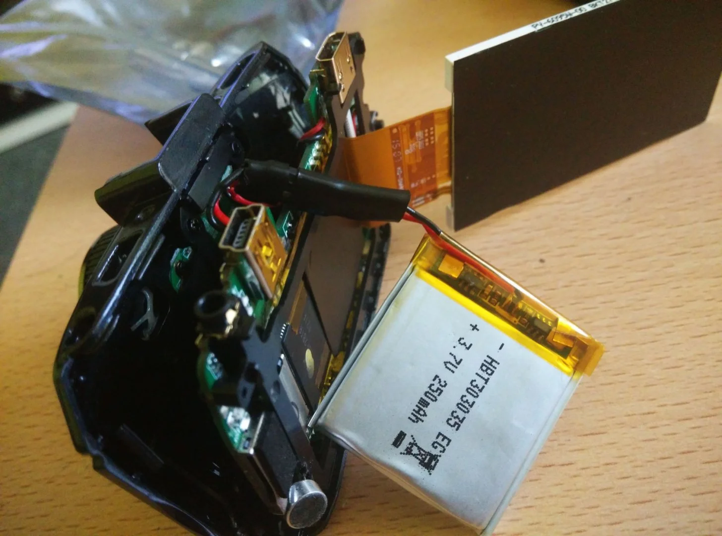

Today I make battery unplug connector for easy way to hard off (dissassembling and reassembling is not very effective method), now i will try few combination with battery unpluging between them
Is it possible to turn on dvr without camera sensor ?

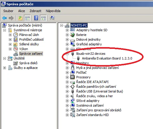

Hah holy sh *** *sdf sdfg fdgsdjřčáýí áéí YEEEEEEEP , comera GOES wooohooo.
My procedure:
1) battery unplug for 30 seconds
2) battery plug
3) hold RIGHT arrow button and inser mini USB cable to PC
4) At Device manager - Amabarella device appeared

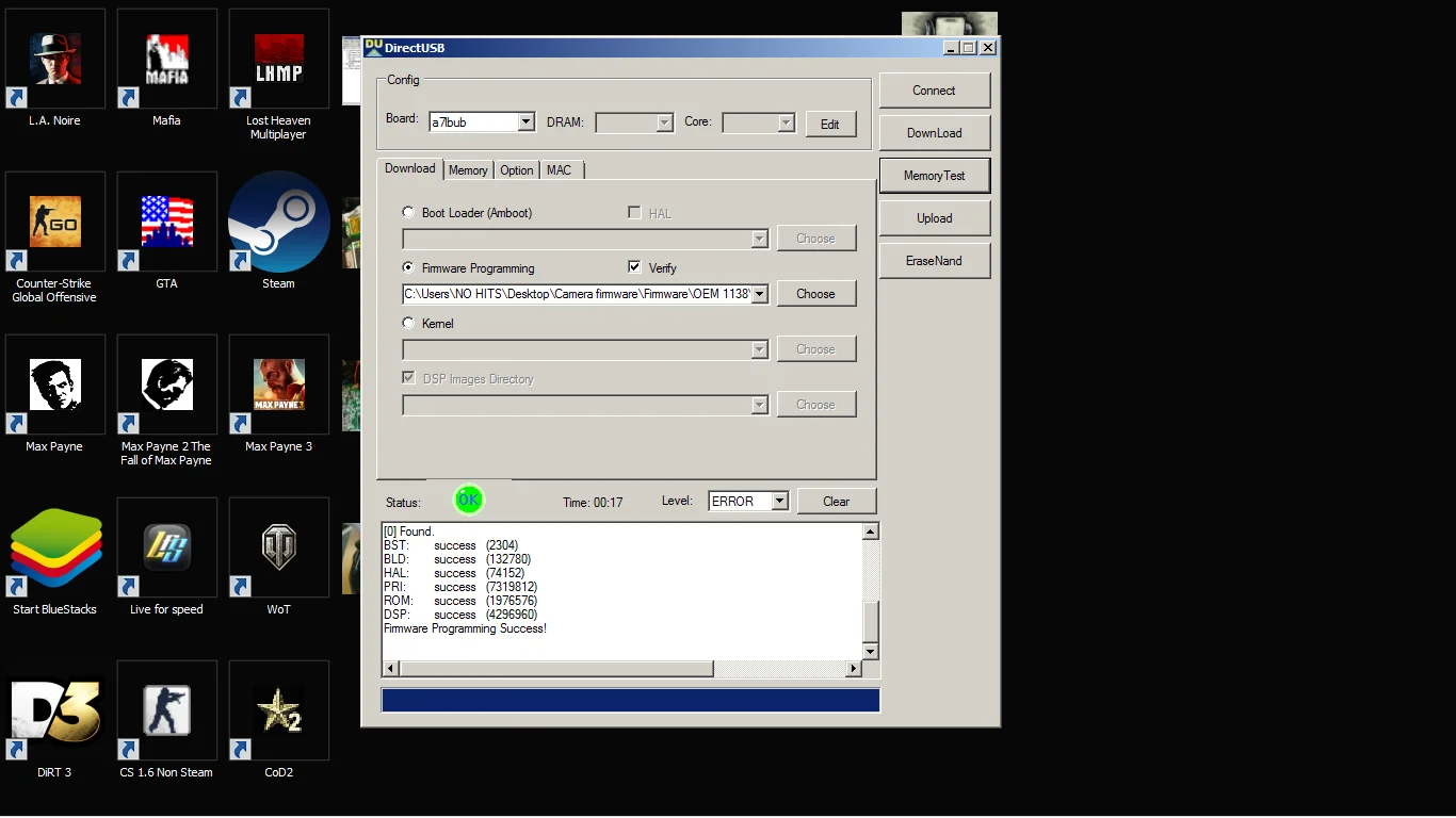

5) Run DirectUSB at a7lbub mode, download (bookmark), insert in Firmware programming right version + Verify checkbox
6) click Connect
-> OK
7)click Erase
-> OK
8) click Download
-> OK , all Success

PS: in your screen captures I've also seen something else 😎
Yes best game ever, made in my town (not capital), next this game icon is LHMP icon lost heaven multiplayer released as RC 5.8.2015 www.lh-mp.eu ... Sorry for OT ;-)
