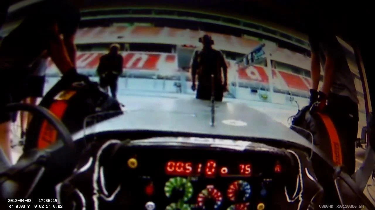

I've finally got around to play with the camera but I have a problem with the WinyBBViewer v1.0.3 crashing when I click config. it says 'gic.blackbox has stopped responding'
Today my WinyBBViewer started working again. :lol:
I don't know if this is because of the new firmware release named WINYCAM_V300_130306_EN.bin. I don't know the changelog for the new firmware but I hope some other users will find what is new. The english voices are still not so good as the first firmware.
Firmware was installed OK as you can see in this screenshot, on the right bottom:
When disconnecting the camera the english voice said: Recording will be end
enjoy,
Mtz
