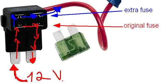

Well firstly you have a 15 amp fuse in there where you only need a 2 Secondly as I said did you actually meter out the original fuse its in because some are on ALL THE TIME

What you wnat is to wire it to fuses that are accessory powered so that camera goes off with ignition. Also make sure you have the addafuses around the correct way. Tak them out and meter each side of the fuse sockets. In the picture they should have power on the left and if not reverse the addafuses.
