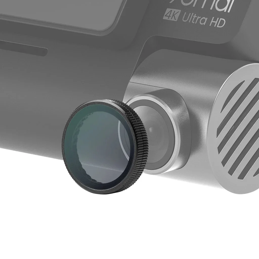

Windshield reflection is a common issue in dashcam footage, especially when the dashboard is strongly illuminated by direct sunlight. You may notice the dashboard being reflected across the lower part of the image, reducing contrast and making details harder to distinguish.
One common solution is a CPL (circular polarizing lens) filter.
What does a CPL filter do?​
A CPL filter can help reduce polarized reflected light from surfaces such as glass and dashboards. In dashcam applications, the main benefits are:
  • Reduced windshield/dashboard reflections
  • Improved image contrast
  • Better visibility of details in high-glare conditions
This can be particularly noticeable when driving in direct sunlight.
How does it work?​
A CPL filter blocks certain directions of light, and it mainly reflects light bouncing off flat surfaces like glass or water, especially in directional sunlight scenes. Your dashcam is always shooting through the windshield, which is basically a giant reflective surface. CPL helps clean that up.
Is a CPL always necessary?​
The effectiveness depends on several factors, including:
  • Windshield angle
  • Dashboard material and color
  • Cabin geometry
  • Sunlight direction
  • Camera mounting position
Vehicles with a large or light-colored dashboard may show more noticeable reflections, while the effect can be less obvious in some SUVs and trucks.
One Important Detail: CPL Orientation​
A CPL isn't simply an "install and forget" accessory. The filter can be rotated to change the polarization angle. Its effectiveness depends on how it is oriented relative to the windshield and the current lighting conditions.
So after installation, it's worth rotating the filter and checking the live image to find the position that minimizes dashboard reflections.

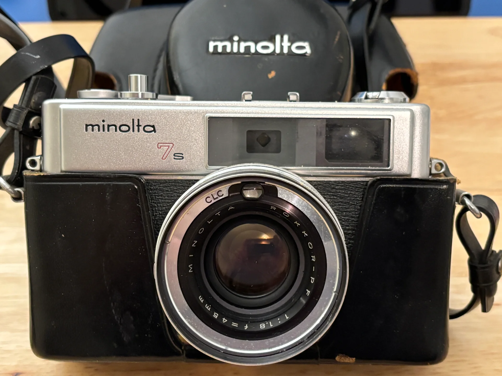

True about reflections. I was wondering, though, whether the plates and the image in general would be clearer if the video were black and white and we could add an amber, yellow, or orange filter. I was just thinking back to my days of shooting black and white with a Minolta.
I still have a little Minolta Dslr lying somewhere, got it in Singapore in 1990, snapper a few pictures on the high seas of the world.
In that context there may be some validity to that approach. I'm not comfortable guessing as to what might happen using a yellow filter on a camera with a color sensor then converting the resulting image/video to B&W.
However, my gut says it should work. I regularly wear yellow glasses (think shooting glasses) around dusk and when driving in the rain and contrast is improved dramatically. I see no reason why the same wouldn't be true for a color sensor.
Still got mine... this 7S takes some of the best black-and-white photos.
