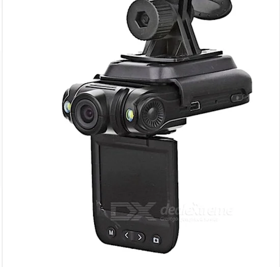

My first real dash cam was a generic model from China called an A-20. It offered 1080p resolution at a time when many dash cams on the market back then were still only 720p. Back in those days there were really no North America vendors selling dash cams. If you wanted a dash cam you needed to order directly from China. One of those vendors was an outlet known as Foxoffer who offered a range of generic cams and their own clones of some Chinese "brand" name dash cams, along with other consumer electronics. Foxoffer eventually began manufacturing and selling their own brand name line of cameras and they are now known as Viofo (and GitUp). FoxxOffer as an online retail vendor no longer exists.
Anyway, when I first got the A20 I was amazed by the performance of the camera. Back then I had never before owned a video camera that could produce 1080p clips and this was a huge improvident over my old Panasonic camcorder. The camera came with a mini HDMI cable and I recall plugging it into my flat panel TV and being blown away by the first footage I shot. By today's standards however the video was poor. The bit rate was minimal and you would often see pixelization in the images. The dynamic range was poor. WDR did not exist yet. All in all I was very happy to have the capabilities this camera provided to me but like ALL dash cams back in those days it was USELESS at night. The very best one could expect was a very grainy image a few yards in front of bright headlights and nothing more. The camera had two white LEDs for illumination which were totally useless but you could easily slide the camera from its mount and use it as a hand-held camera which could come in handy if you had a fender bender and wanted to capture the damage from outside your vehicle. Like many dash cams back then this one was not 100% reliable. Sometimes, for no apparent reason you would get home and discover that it stopped recording somewhere during your journey and I spent a lot of time and energy fiddling with the cables making sure I had a good connection.
The A-20 camera itself was pretty interesting. It had a flip down tilt-table screen with control buttons and it ran on a replaceable cell phone battery. I bought this one because it was stealthier than most cams of that era that had chrome and splashy logos on them whereas this one was all black. There was no way to know what processor or sensor was in it. It took a maximum 32GB memory card. You just had to pick one and hope for the best.
So, I don't know if you could call it a "snails pace" but dash camera technology has sure come a long way in my time with them and each iteration adds improvements, features and new capabilities. My current A119 V3s compared to my A-20 from 12 years ago are from different worlds.
The A-20 dash cam. You can still find it online! (the one I had came with a much stealthier mount)

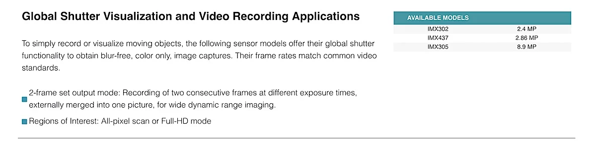

FYI, Pregius sensors are already available with dual frame HDR capabilities implemented into the sensor itself and while not suitable for dash cam use or consumer products some of these sensors are designed for standard video capture which Sony describes as blur free color image captures at standard video frame rates. There is no reason not to believe that this technology will eventually find its way from industry and technical use to consumer products.
You say that and then include an image that says the HDR exposures are "externally merged", not done by the sensor itself!

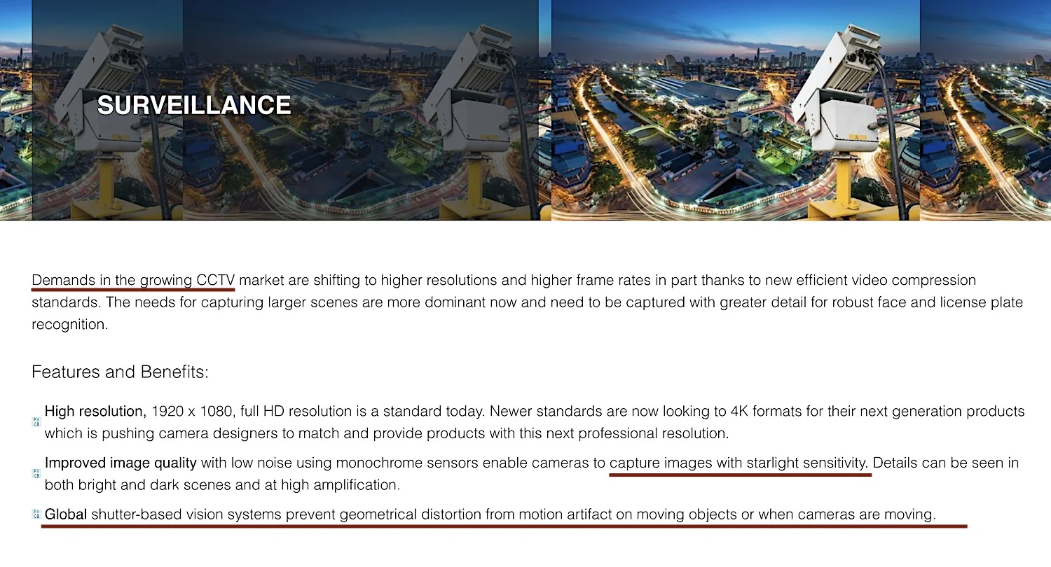

STARVIS and Pregius are both highly sensitive back-illuminated sensors but again, I was not saying anybody is going to put a Pregius sensor in a dash cam, I was speculating about the possibility of Sony eventually developing a global shutter sensor optimized for dash cams that does not currently exist. We were discussing possible future dash cam developments. All this nitpicking about the Pregius sensor actually being used in a dash cam is ridiculous as I never suggested that.
They are not normally used for surveillance cameras, that is what STARVIS was developed for, and that, as we know, uses rolling shutters.
Obviously you weren't paying attention when I brought this up previously but SONY is specifically marketing the Pregius sensor for use in CCTV cameras both for its global shutter and its ability to capture images with "starlight sensitivity".
They also mention license plate capture.
They go on to discuss other benefits of the Pregius family of sensors for use in surveillance cameras.
"Amazing image quality can be had with highly sensitive, large capacity pixels that provide wide dynamic range image captures of drivers and license plates for tolling or law enforcement. These ensure reliable, clear images, even under challenging light conditions, that ensure accurate detection and reading of number plates even under challenging conditions such as reflections, shadows, and direct sunlight."
" NIR sensitivity is increased with the deep pixel wells of the Pregius technology architectures, making them especially interesting for outdoor, nighttime applications, especially if combined with NIR light sources."
Well of course not! It is a sensor, not a processor.
What they are saying is that the sensor has an optional dedicated 2 frame HDR capture mode built into that sends both frames to the processor.

First, your argument was that there would be no reason to use global shutters when HDR is built directly into the sensor
there will be no reason to use it when HDR is built into the image sensor itself.
When I then pointed out that the Pregius units already have HDR incorporated into the functionality of the sensors (and have for several generations) you skipped right over that and moved the goalposts once again, arguing that it is "externally merged".
When I pointed out the obvious fact that it is merely "a sensor, not a processor", but nevertheless a sensor that is designed to capture two HDR images and forward them to the processor you moved the goalposts yet again.

SONY is not marketing these sensors to clueless consumer electronics customers. They are marketing to companies building high end machine vision systems and specialized surveillance cameras. I seriously doubt the engineers designing these systems and making purchasing decisions would fall for hyperbole and hype from SONY.
Both global shutter and high sensitivity are factors that contribute to better visual acuity in video capture.
