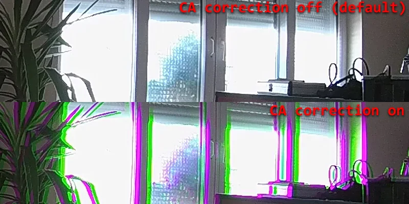

In the meantime, I got a 16mm lens from Aliexpress and found that LSC is not a problem at all, it is not noticed.
I sensed another problem, cromatic aberration and the way the camera deals with it.
Apparently it has a correction system that works great with the R and G channels, but with Blue it completely distort the image on sharp transitions.
On a images there is bottom right corner of camera photo, 1 images pixel = camera pixel.
So I think that I need to switch off aberration correction or to change some parameter. Tega seveda ni v Android app, so I need another line in autoexec. Or I have to buy a better lens, this one is 5MP 1/2" for 7€ :)

I think that it's not disabled. Look closely at this image https://dashcamtalk.com/forum/attachments/bottomrightcorner-b-jpg.53233/ , this is not a classic chromatic aberration, there are some shadows in the image that are brighter than the white background of the image. It can only result in image processing. If you look RGB picture https://dashcamtalk.com/forum/attachments/bottomrightcorner-rgb-jpg.53231/ , there is no chrom. abberation at smal numbers.
It may be an original lens aberration correction that does not work well on the other lens. If I want to find out what image the lens really gives, I should rule out any corrections.
It’s also weird that the R and G channels are completely consistent, I believe this is the result of a correction in the image processor.
If I used a better lens, the result might be even worse. A correction made for the original lens would further spoil the image.
I don't know what you meant.
I know what is CA, at least 40 years.
I think the distortions in blue are due to the action of CA correction.
I don't know the CA correction command, do you?
I'm so happy, the lens for 7 € is (as far as CA is concerned) quite OK, I just had to turn off the CA correction. Here is the image of the lower right corner of the image, I don't see any CA.:p:D(y)
