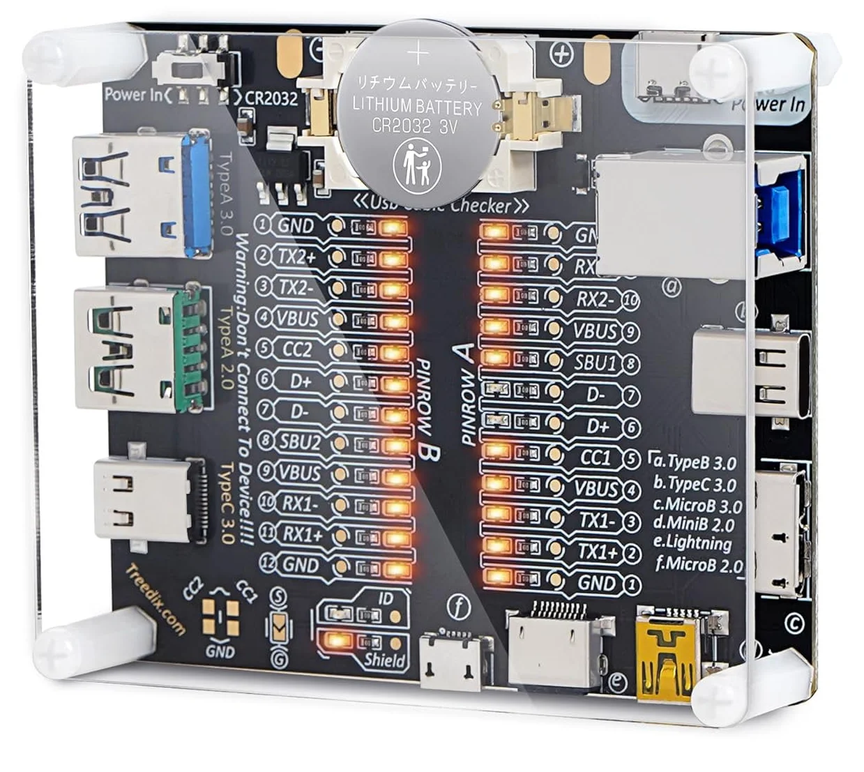

I've built cable testers and it can become a rabbit hole especially when there are electronics within the cable.
Here are some examples of the cable tester results.

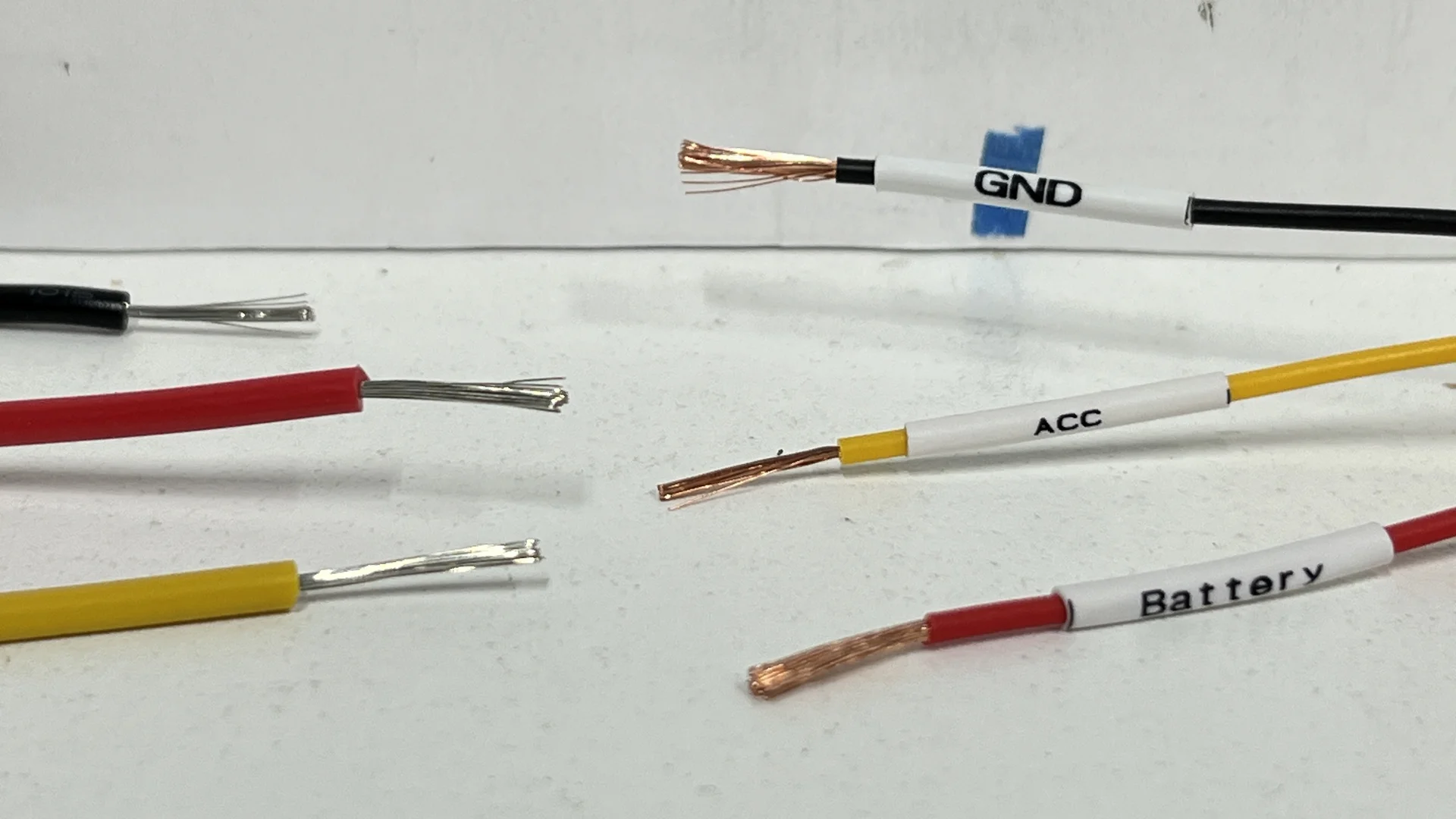

Bad News: The $10 Type-C cable tester was DOA / defective.
Good News: I just received the $16 Treedix TRX5-0575.
Good News: I figured out how to identify ACC / ignition PIN in HK6 Type-C connector using Treedix TRX5-0575.
Bad News: I need two more additional HK6’s.
