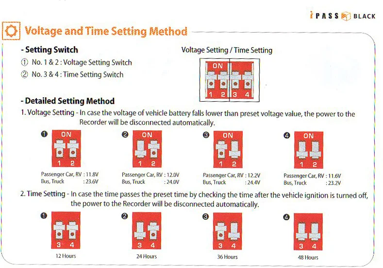

My issue is different.
I have no problem with it recording small movements because I have a 32 Gb card.
The problem is that let's say it will record in parking mode for about 20 min, then looks like it shuts down even if there are still movements (parked at a street were cars pass by all the time).
And it will start back when I reenter the car because I hear those 3 beeps. The camera should be ON anyway because it's connected to the UPC.
I have the Itronics UPC and it's connected to the interior lights fuse.
I don't think that the battery drains below 11.6V. That's the lowest I can set for my UPC. Will try to upload a scanned picture of the manual.
Also I have it setup to 24 hours or 11.6V. Not sure why it turns off after a while (usually 15-25 min).
I have to do m ore testings.
I think there are 4 possibilities.
1. The UPC is not working right.
2. The voltage drops under 11.6 (low probability)
3. The car computer cuts the power to the interior lights after a while to save the battery in case you forgot it on...
4. ..some issues with the camera
Troubleshooting that I have to try:
1. Connect it without the UPC.
2. Connect it to a different fuse.
..these will take me some time to test, but will do it.
