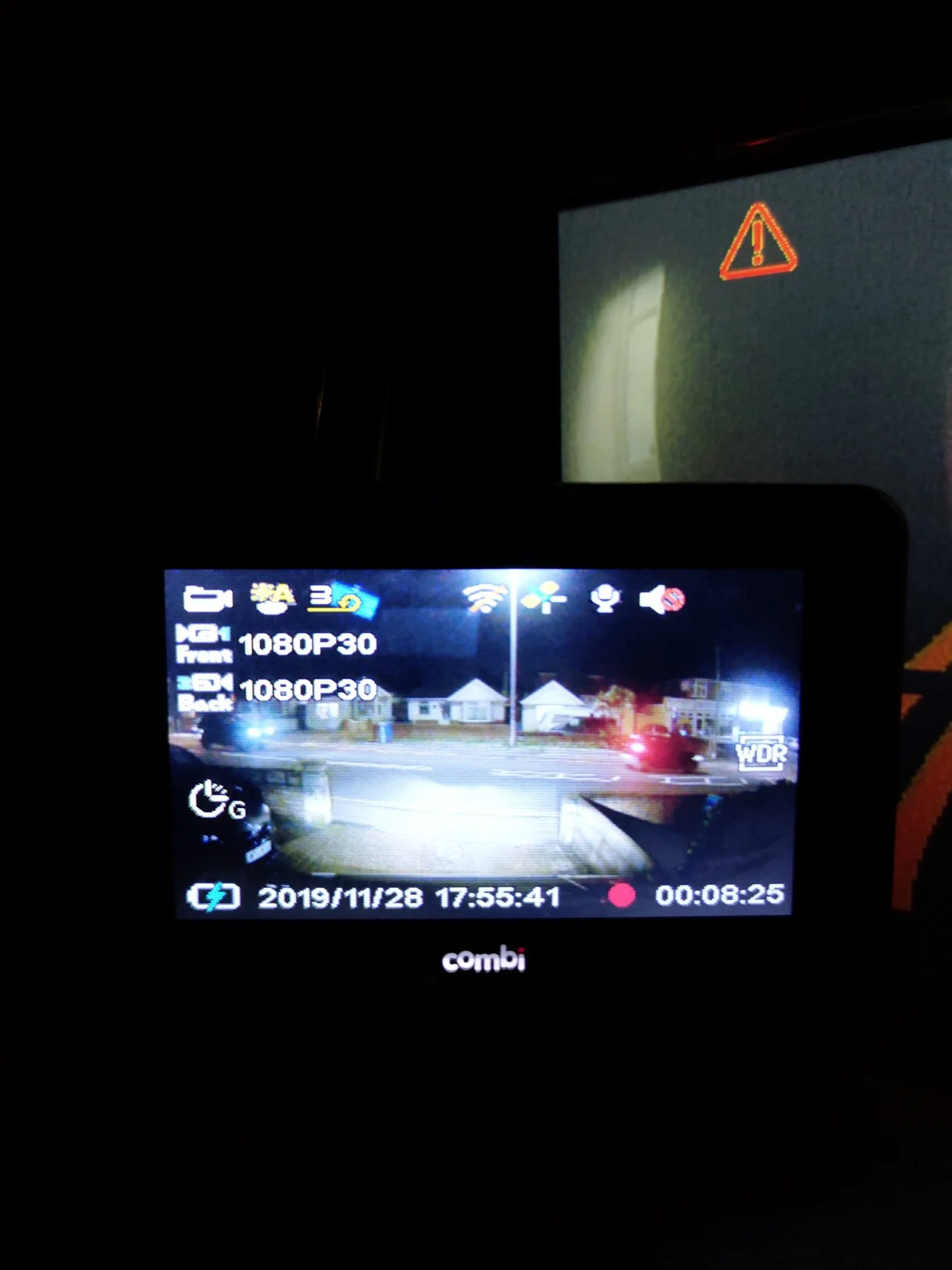

Also, the recordings are set to 3 minute loops in settings but the recordings completely vary in length. Some are 10 seconds, some are much much longer, maybe 8 to 10 minutes.
See below, record time is on 8 minutes, 25 seconds. Loop time currently set to 3 minutes.
I have reset back to factory settings today and I still have these problems.
I am going to contact the supplier (Combi) to swap my unit because it is just too unreliable. :(
