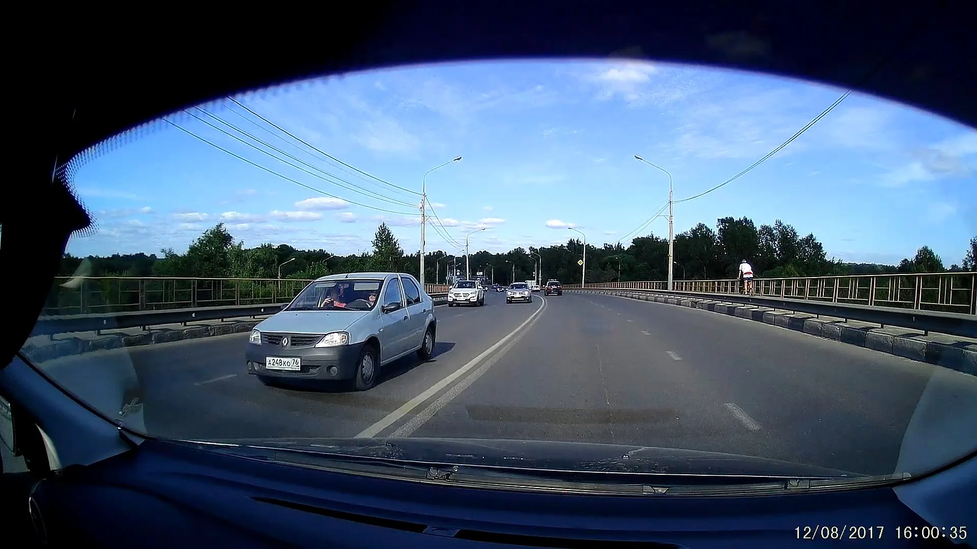

TDR-700  и Крис П , мост через Волгу.MP4_snapshot_00.43_[2017.10.27_14.18.05].webp
One Russian brand faced the problem of defocusing on the DVR, because of the small case and the plastic holder, + the very hot matrix AR0330, the engineers coordinated the review and the DVR was very popular.
It was decided to install heat sinks and a metal holder:
... a Holder made of the material D16T...Dont Knowler I can share with you 1pc.

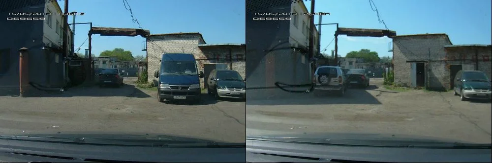

By the way what do you think about the "normal" focus image, good or not good focus?
the videos show exactly the same thing, cooling down it becomes as at the start up.
"cold" picture
I don't know if good or not but you can see details like the child watch, eyes of the robot and look up at the roof, the metallic frame of the neighbors building.
"worm" picture
the image becomes blurry, the figures on the child's watch more difficult to see, no robot eyes (two white points) any more AND the most interesting is that there is no metalic barrier on the roof anymore. no, it's not special effect, it's the magical @VIOFO_Support a119s.
so with couple of degrees more, the A119S becomes blurry, i'll not push it more hot at the direct sun as for sure there can be some even worst damages (maybe not reversible), as now when it cools down for °10C the sharpness of the image becomes "normal"
I suppose that on the direct sun on the windshield and in the summer on 35°C out or on the hot parking it will be much more extreme.
Everything is clearly visible, this test again indicates that there is defocus on heating.

The main difference I see between those images is the lighting, the first image has a lot more contrast which makes it look sharper.
It is not clear to me that there is an issue with the mount. If there is a focus issue then I wouldn't be surprised if it is caused by the lens changing temperature rather than the mount changing temperature, but it looks more like it's caused by a light level change to me.
hi @Nigel , you're right for the "contrast" remarque and I have had the similar doubts as you have.
The first photo looks sharper but the colors are not so saturated.
The second one is blurry but with more saturated/warmer colors.
So I've done other tests and pictures under the same lighting condition, means indoor.
BTW even if, believe me, those two outdoor have been done in the perfect lighting conditions...cloudy sky, like as the photographers prefer, no direct sun etc. I have some others with light (sun) and I've already exlude them as I've new that one of you will have this remarque ;-)
so with the indoor artificial lighting, it's exactly the same, 100%, when the dashcam worms up, the closer objects becomes sharper and the distant object loose the sharpness. When the dashcam cool down the closest object loose the sharpens and the distant object becomes sharp.
