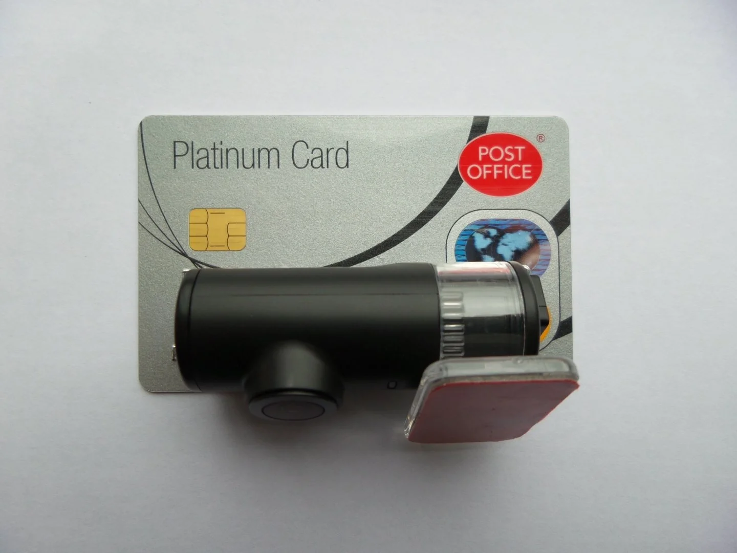

The way my SGZC12RC works might interest you. Mine is set to function in buffered motion sensing mode when driving & when parked. The use of motion detection while driving is not advisable for most cameras, however, it's entirely reliable with the SGZC12RC.
The camera is plugged into the 12v accessory socket. At the same time it's plugged into my 5v Anker 13000mAH external battery.
While driving, the SGZC12RC is powered by the car's 12v supply. When I park & switch off the engine, I simultaneously press the power switch on the external battery, & the camera seamlessly continues recording.
The SGZC12RC is a single channel camera, but a pair of them makes a very good alternative to a dual channel setup.
