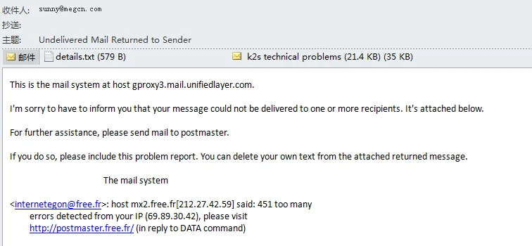

Maybe you mail box is full, she received two emails send back to her.
Hi Egon,please check your email. And here I put her email here for your reference. Anything ,please contact,thanks.
