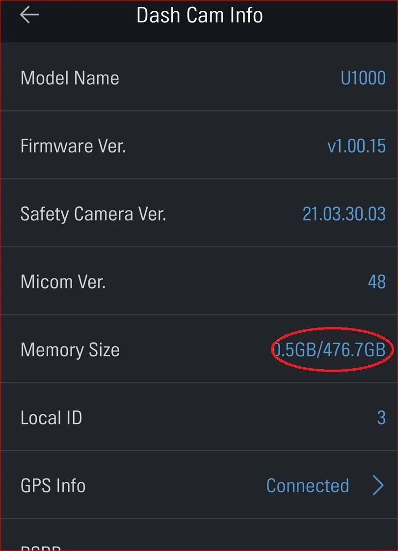

Just updating this thread for interested users of the U1000. I am using the following latest 512GB SanDisk extreme pro
It works perfectly as expectedView attachment 56525
Hi, I just thought of replying as Peter helped me go ahead with 512gb card for Thinkware U1000. Samsung Pro Plus worked, please see attached.
