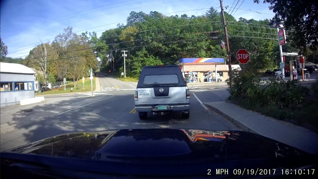

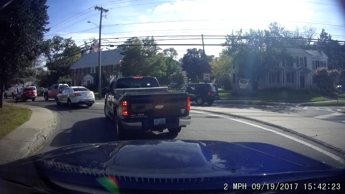

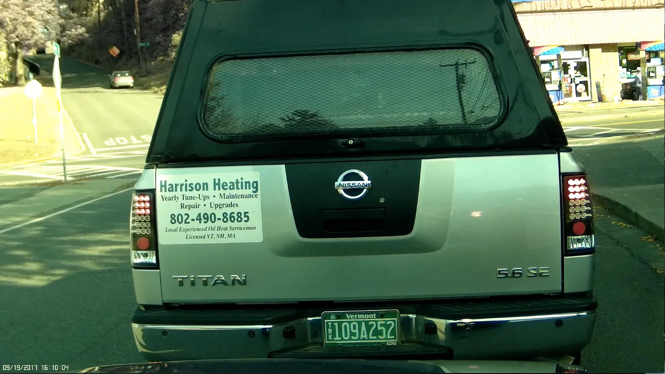

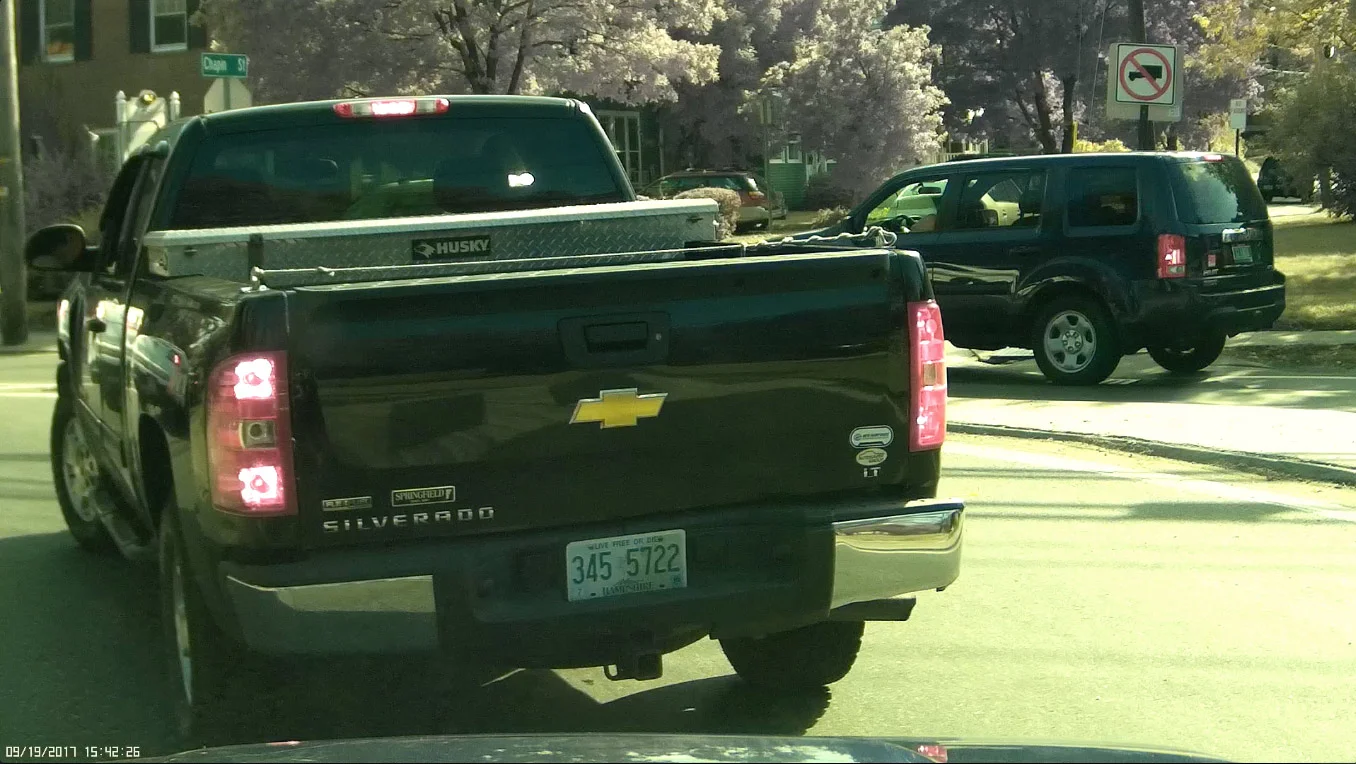

The whole concept of using a telephoto lens on a dash cam has completely altered my experience as a dash cam user. What started out for me as a temporary experiment with a varifocal lens (usually set to about 10-12 mm) has fast become an indispensable addition to my set-up. I don't see going back to having just one wide angle camera facing forward now.
I'm repeatedly astonished at the details I capture with the telephoto as a companion to the usual coverage, so now I'm totally sold on dual focal length cameras. It's interesting timing that both @kamkar1 and me have been experimenting with this concept at the same time. Maybe it's a trend? πŸ™‚ @SawMaster is next! πŸ˜€
Mobius 1 with varifocal set to about 11mm. (IR)
SG9665GC
Mobius 1 tele. (IR)
GC
