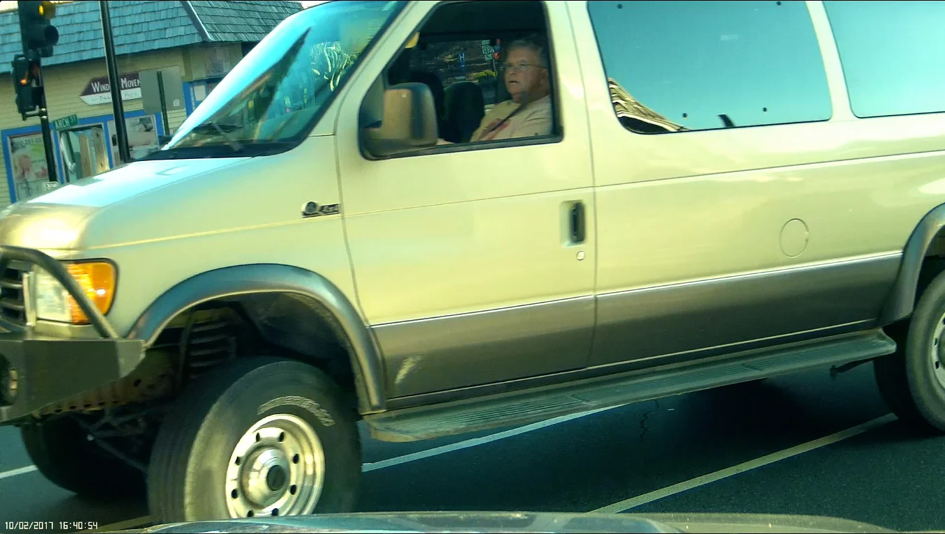

lens experiments ( 12 mm ) long range dashcam
So for JVX you got 1/3 size? I'm going to try 6mm or maybe even 3mm. 90 degree FOV looks like a sweet spot for me.
Great night-time performance :) Watching during your sharper turns with the focus being so far away was almost like being on an amusement park ride, wheeee :ROFLMAO:
it almost look like i run over those guys in the crosswalk too, the long range lens do play tricks on us too.
Sadly i forgot the SD card from the GC, the plan was to make a 50/50 video with night time footage.
