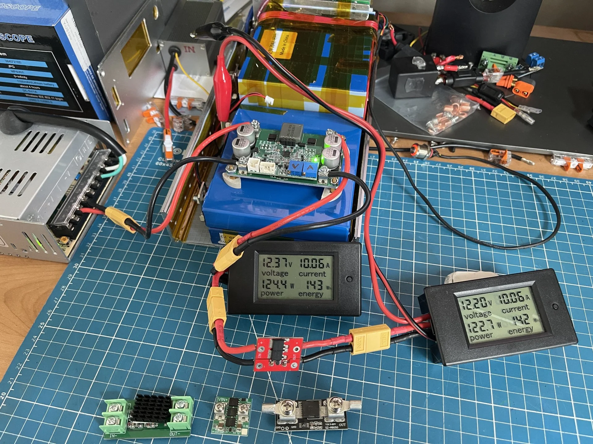

I currently have 4 different anti-reverse "ideal diodes" including the one linked above.
The Red one rated at 15A, shown wired as tested, and the other 3 are shown from left to right on the bottom of image:
15A Grin, 20A Grin (small square) and 50A Black.
Here are the test results for the 15A Red Diode:
Ambient temperature 25°C
Test duration about 30 min, Constant Current, Voltage and Power were gradually growing as battery was charging.
When charging at 8A charging:
The Current drop negligible, about 0.01A
The voltage drop is about 0.14V
The power consumption is 0.14V x 8A = 1.12W
The Diode temperature gradually increased from 25°C ambient to 38°C and stabilized there
The Charger temperature (Inductor) stabilized at 56°C
When charging at 10A charging:
The Current drop negligible about 0.01A
The voltage drop is about 0.17V
The power consumption is 0.17V x 10A = 1.70W
The temperature gradually increased and stabilized at 45°C
The Charger temperature (Inductor) stabilized at 65°C
The Diode average efficiency is about 98.7%
There were no temperature, voltage or current spikes, nothing unexpected.
I tested including from a completely discharged battery at about 9V and at mid-point charge about 12V
I will test and post the results for the rest of the Diodes for comparison.

Update on 15A Red Diode,
I wired it as all other Diodes, bypassing the negative power wire and using negative thin wire/jumper to connect to Diode's negative terminal.
The Diode perform exactly the same as previously with one exception, at 10A charging the temperature was about 42°C or about 3°C cooler.

Re-post from the LTO battery thread:
Here are the test results for the Black 50A Ideal Diode, the one you ordered:
The same test condition as for the 15A red diode.
When charging at 8A:
The voltage drop is about 0.13V
The power consumption is 0.13V x 8A = 1.04W
The Diode temperature gradually increased from 25°C ambient and reached 32°C and
When charging at 10A:
The voltage drop is about 0.16V
The power consumption is 0.16V x 10A = 1.60W
The temperature gradually increased and reached 36°C
The Diode average efficiency is about 98.9%
There were no temperature, voltage or current spikes, nothing unexpected and no back-flow voltage.
Based on the test, this diode is a good choice.
