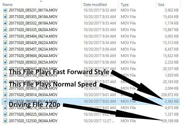

Camera set to 1080p 30fps front & rear.
With parking guard on & G sensor set to high:
Front & rear diving videos recorded as 720p
Recorded when parked 720p with some video's playing like they were in fast forward.
With parking guard & motion turned off camera records 1080p front & back as it should (not shown in this pic).

Tested parking guard again today and I am experiencing similar problems although 1080p and 720p switching is fine between driving and parking mode.
What I have got is when camera switches to parking guard mode every other file is in fast motion and file is only 1 or 2 seconds long and typically 0.5mb. Does look like a firmware bug.
when the vehicle is in parking mode and there is no motion&impact, the image capturing is 2fps and playback is 30fps, which means a 30 seconds quiet recording (60 frames) will be 2 seconds playback.
for example, if you parked the vehicle in a prosperous supermarket parking lot, the camera will be triggered all the time then there maybe a lot of short videos.
Ah hence the speeded up video with people walking at very high speed
yes if the walking people is too far away to trigger the motion detection, they will be play as high speed film
