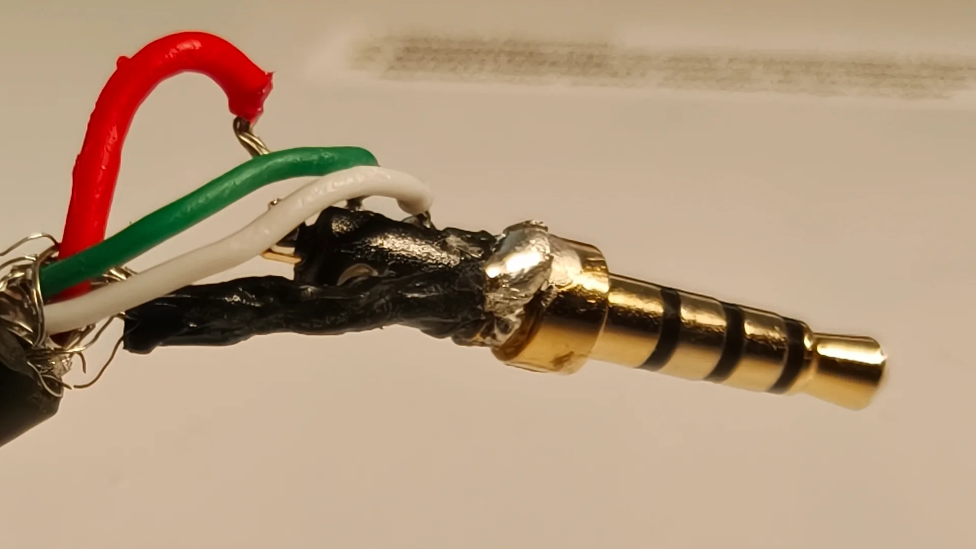

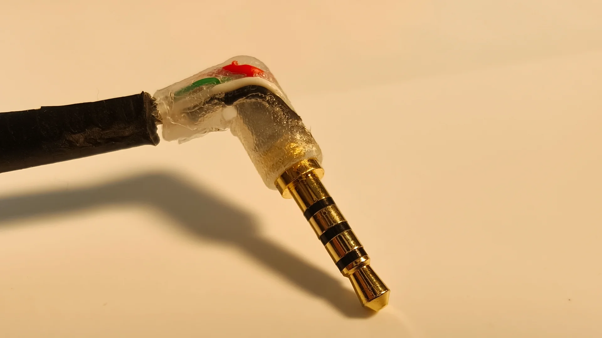

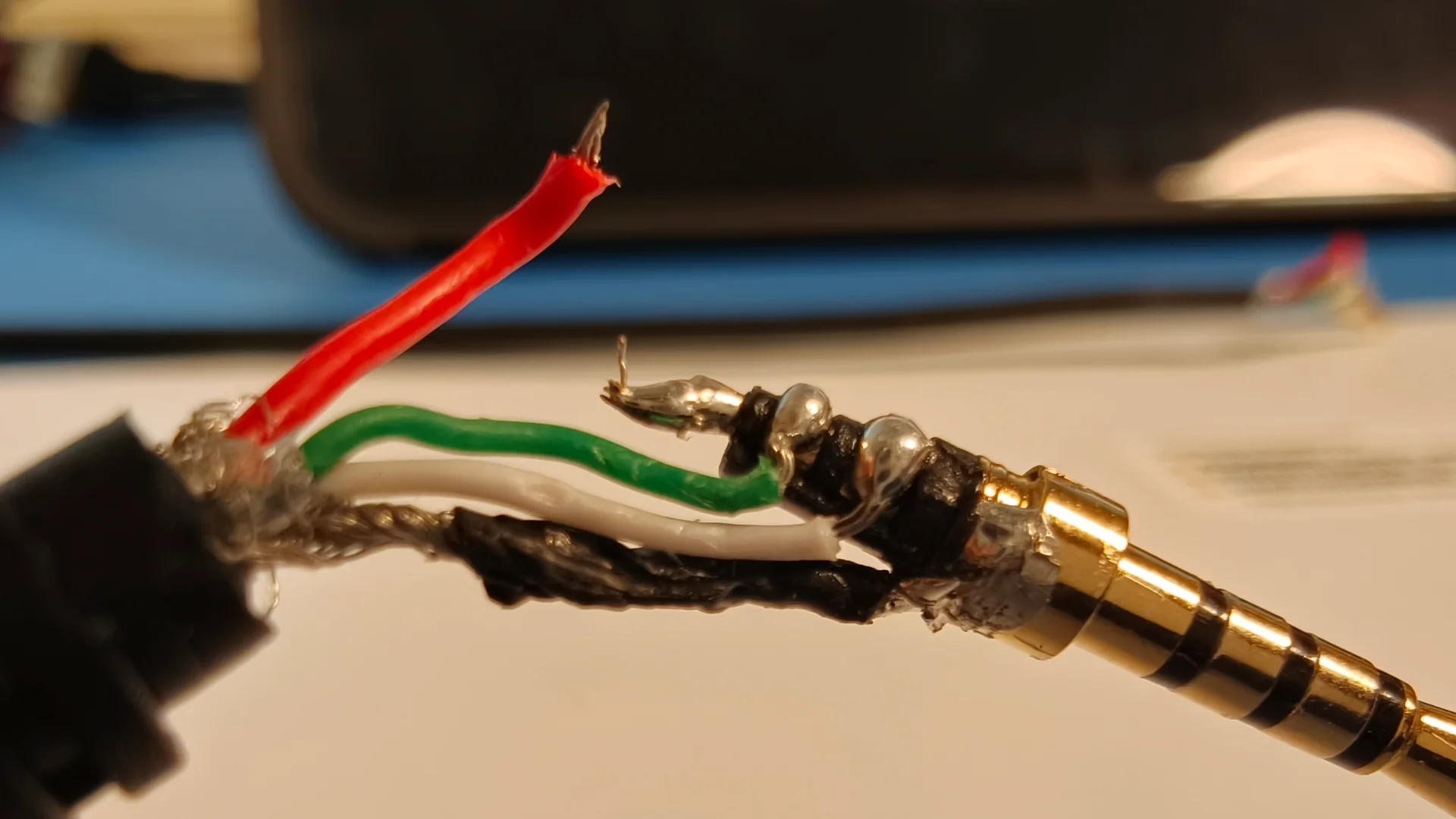

Out of curiosity, I disassembled the rear cable for an S1-4K Rear Camera cable. This is a TRRS connector.
Tip = Red
Ring1 = Green
Ring2 = White
Sleeve = Black
Wiring was red to red, green to green, etc. This is a straight-wired cable, nothing special about it, and this is why the cable that Chuck referenced works; this is just a straight-wired cable. Any 2.5 mm straight-wired TRRS should work as an extension.
Angled end with outer housing removed, and then with encapsulant removed. The Red lead detached itself. I will need to resolder it at a later date.
Straight end with outer housing removed, and then with encapsulant removed. This Red lead detached itself also. The encapsulant seemed to want to adhere to the Red leads.
Now we know what the S1-4K cable for the Rear Camera looks like and how it is wired out.
