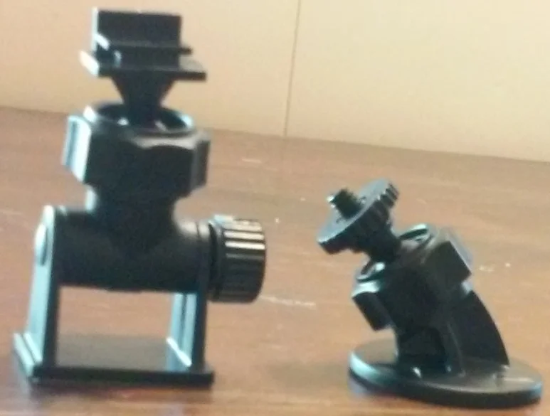

This modification was as simple and easy as a DIY project can get. I bought these 2 mounts. Notice the tall mount has a notched tube end on the right side.

Compare my finished product shown above and still available today for $1.49 and $1.49 with free shipping for these 2 mounts with the ball parts switched out to Jovuu's mount shown below costing £4.50 and £5.00 for shipping (£9.50) Combined cost about $11.09). If anything my mount is slightly (maybe 1/4"?) shorter (better?). I see less than 3mm that could be removed by modifying the bolt to gain more usable threads. If the retaining nut is included in this conversion probably 2mm of thread (about 1/2 turn or 180 degree rotation of the locking nut) are left over after the mobius maxi cradle is mounted. In short, I would guess that less than 5mm of rod length could be removed by using other more drastic DIY measures such as grinding the threaded section a little bit shorter or drilling out the ball to insert a threaded rod of your choice of length or angle. A rod could always be bent to achieve a needed angle as long as you have a rotating head as used on these mounts.

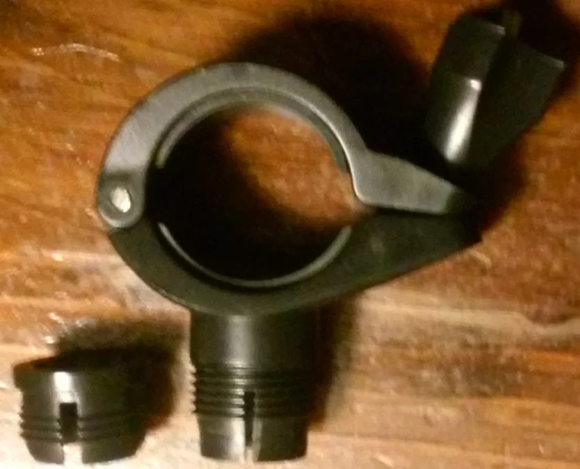

My g1w-s came with a mirror mount that broke on me. The raised column the ball mounts in literally cracked and broke in half below the adjusting nut. The clamshell next to it broke in half. The half broke in 3 different places. These have a design defect. Instead of both halves closing together with a tight fit they have an uneven gap. Thus when trying to tighten the clamp anyone can break it. There is no "feel" available that allows you to know you have reached its maximum tightening ability
Because this mount was junk anyway I decided to try to make it shorter. To reuse this meant I would have had to glue the column (under the locking nut) back together. I took a hand file and shaved the raised column part down to size. This mounts top is cast in one piece. The ball holder column does not unscrew from the clamp. A replacement mount (the cheapest on ebay) was made with screwed together parts. I turned hard plastic into shavings using a very course file probably made to shave down lead used in auto body work or for horses feet.
Instead of using a round bottom to hold the ball in place this viofo mount used a raised column with an internal pipe that used a countersunk hole in the middle. As a result the bottom of the ball was marred. I shaved the marred part of the ball down hoping for smoother movement.

I cut (and broke) this mount down to size. You can see a previous repair on the furthest left piece.
The upper right piece has 3 cracks in it needing repair. Proper design would have not have resulted in any cracks.

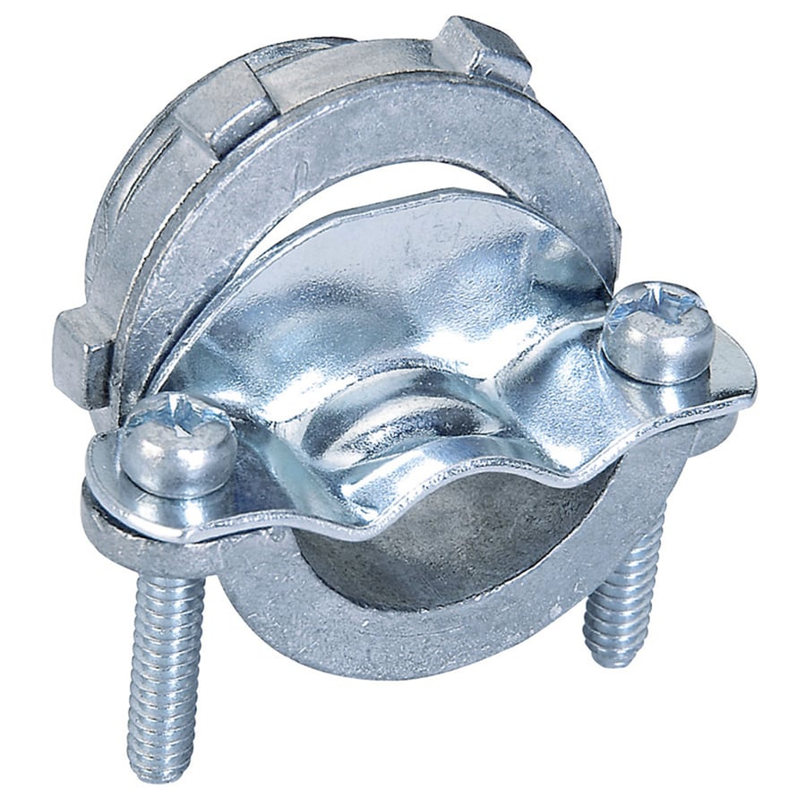

I am debating about losing the factory clamp (with all its cracks and huge inside diamater) for an electrical clamp that would be about the right size.
I could epoxy the mount part to that metal without losing anything except for unnecesary bulk. The down side is tightening 1 or 2 screws that are hard to see.
I do not think this would work without modifications as it probably would not tighten up very well on my rear view mirror.
Using a hacksaw to remove the end plate with the hole and drilling holes on that end for a second bolt would make this usable.
Making the drilled holes square could be tough.

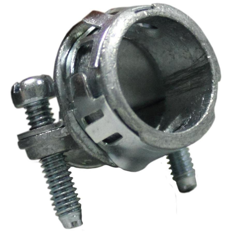

This one however should work exceptionally well. It is a metal clamp and nothing more. Yes, it would need to be cut in half (on one side) to work.
After getting the right size and using some black paint this would be almost invisible after adding the swivel mount from my broken mount.
