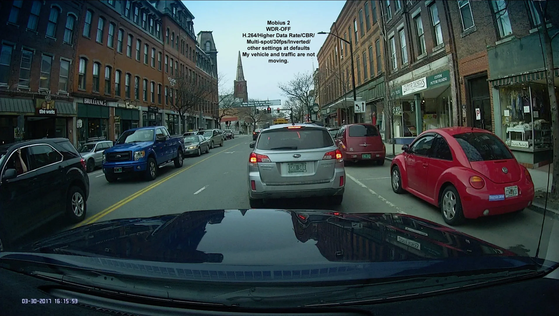

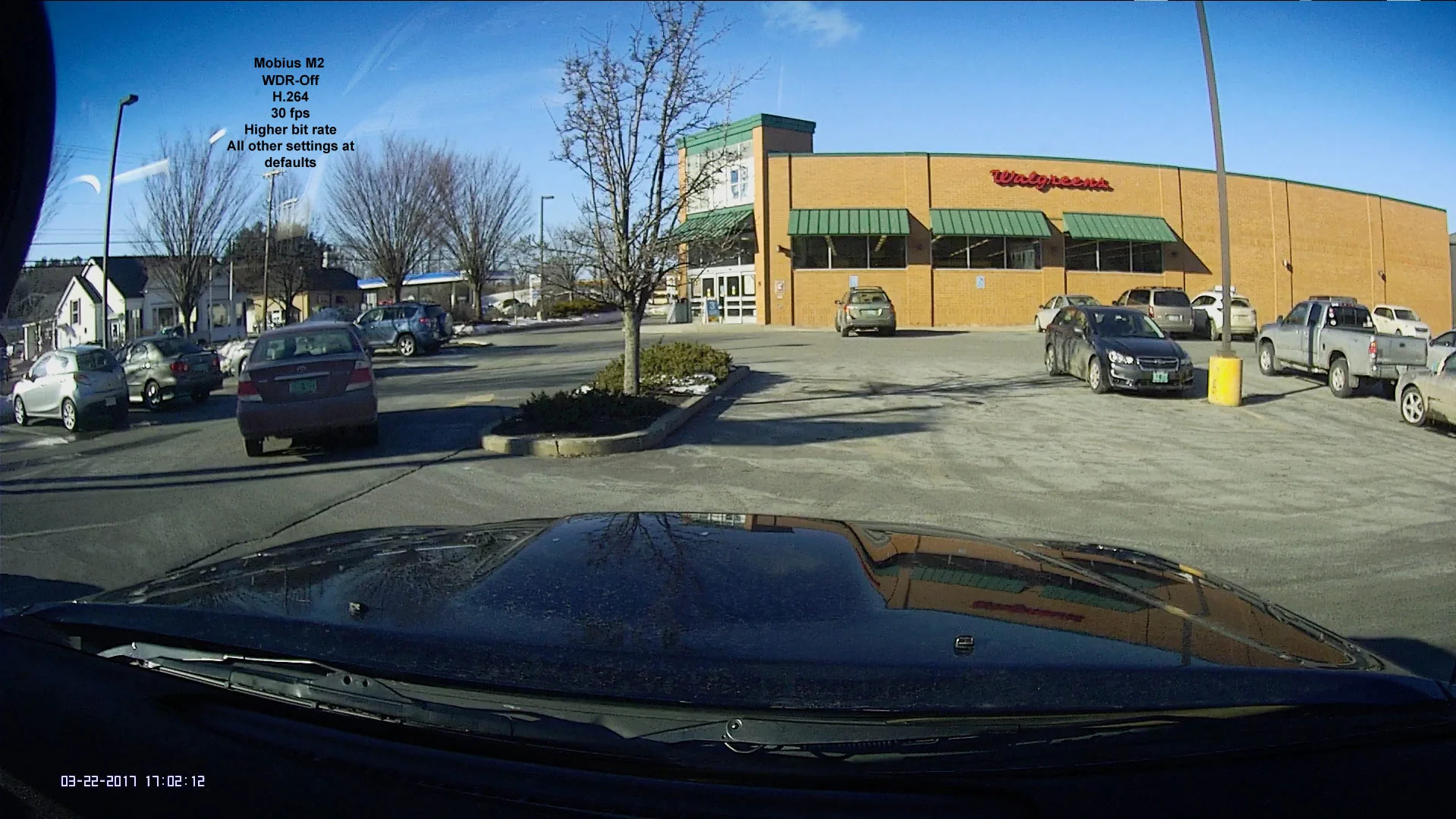

The latest firmware is quite good in many ways and addresses many of the outstanding exposure and contrast issues that have been pending. For me personally, the primary issue is that I have been unable to obtain an adequately clear and sharp image out of either of the two M2 units I own. The images actually look slightly out of focus. Just the other day I went to the trouble of carefully re-focusing one of the cameras using the AV connector on an HDTV and it made no difference. My next experiment is to try a different optic in the camera to rule out a lens flaw but I question how two different M2 samples with two totally different lenses could have the same problem.
Here is a different example of the problem where I compare the SG9665GC with the Mobius 2.
There is a serious lack of critical sharpness in the M2 image. Exposure is poor as well.

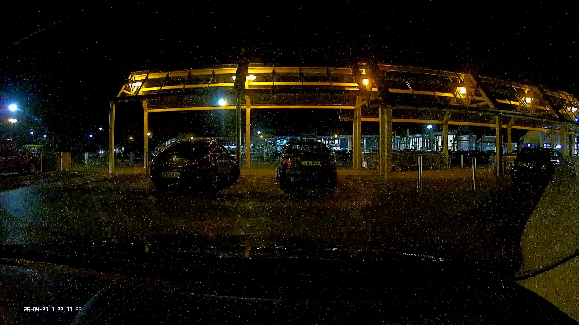

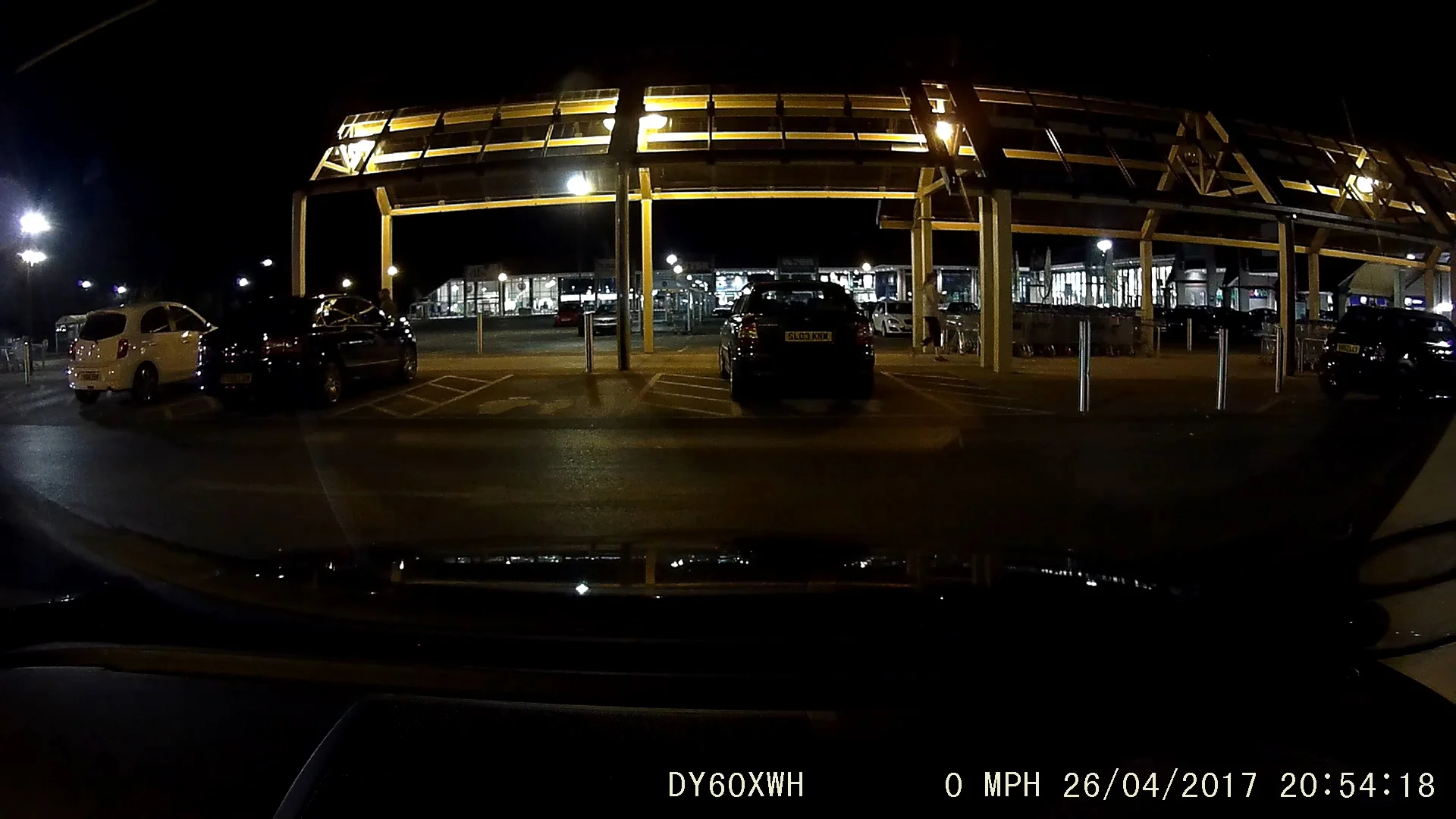

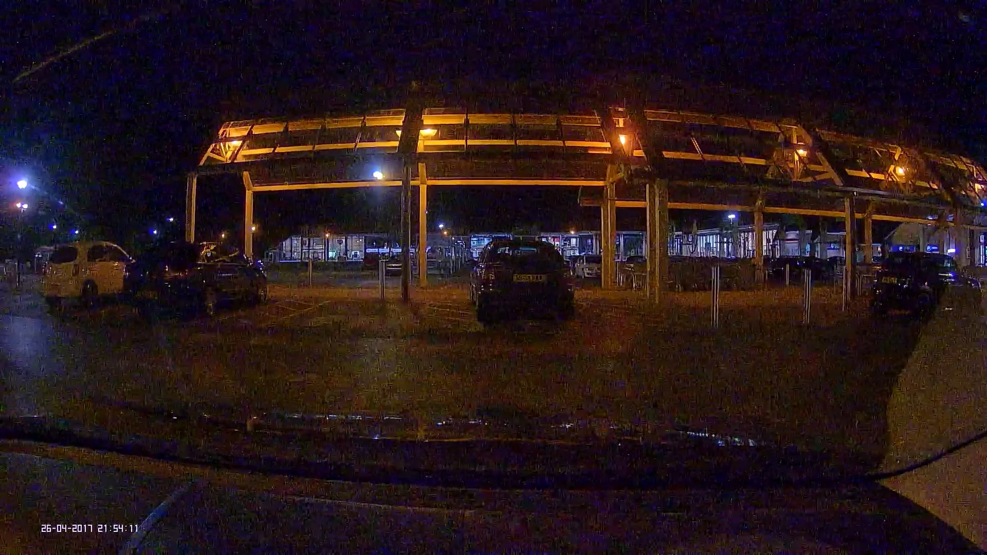

Ran a few day and night comparisons today between the latest FW v2.08, and the last of the dual-frame WDR firmware v1.36. I also have reference shots from my GC.
NIGHT (no headlights)
v2.08 1080p60 WDR on
v2.08 1080p60 WDR off
v1.36 1080p30 Dual-Frame WDR
v1.36 1080p60 (no WDR)
SG9665GC v2 1080p30 WDR on
The night time performance of the early firmware was abysmal; that much we know. What I was referring to was better apparent clarity and motion blur performance during the day with the early dual frame WDR firmware. Wish I had kept my examples but I tend to eventually purge stuff when I clone my drives for back-ups.

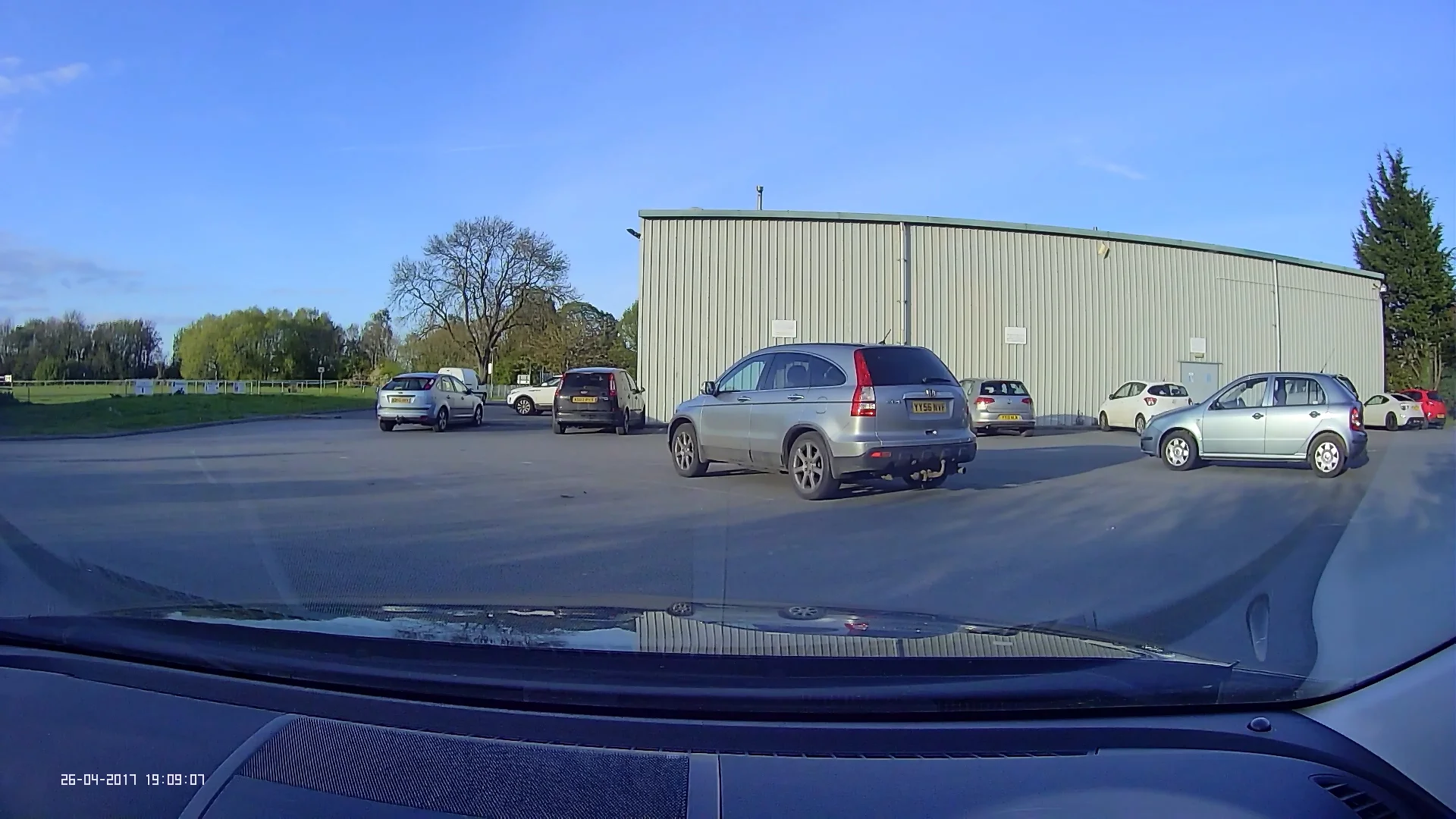

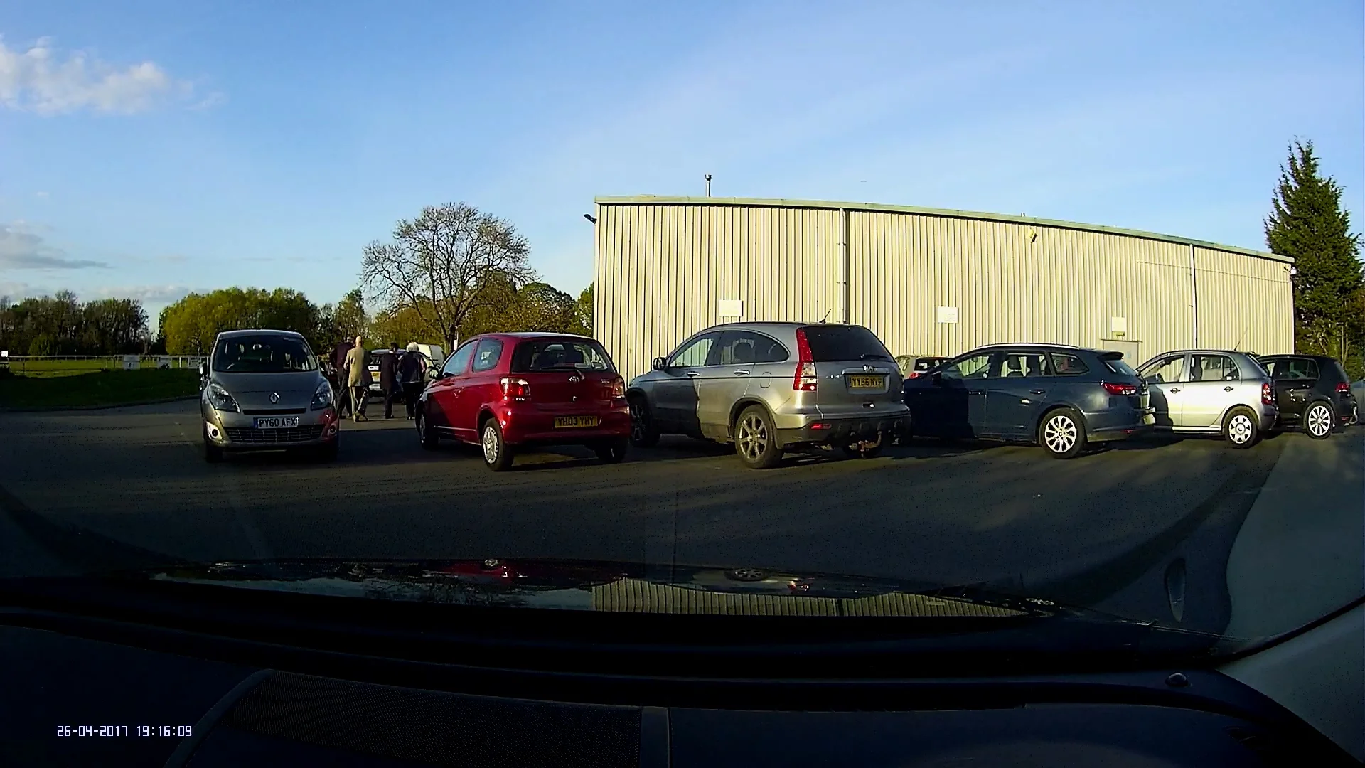

Daytime comparisons between the latest FW v2.08, and the last of the dual-frame WDR firmware v1.36, with reference shot from my GC.
v.136 WDR looks much sharper and clearer to me, echoing my experience. My V.208 firmare seems sorta' worse however. 🙁 Don't know why.
These were still frames from static scenes for ease of comparison. I also took driving samples which I can upload another day.
V.136 WDR definitely looks superior to the more recent firmware, static or not!
