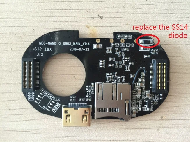

Looking to resurrect the old nanoq and replace the caps.
Can anyone indicate if there is enough room in the case for 2 x 12.5mm diameter caps in place of the 10mm diameter ones?
Has anyone replaced the rtc battery with another supercap successfully by any chance?
I have replaced the rtc with a 3.8v 20f cap using the updated connection positions. All good so far. Holds time for a few days at least so far. Replaced the main caps with 80f 3.8V caps.
Should get a little more life out of it hopefully.
