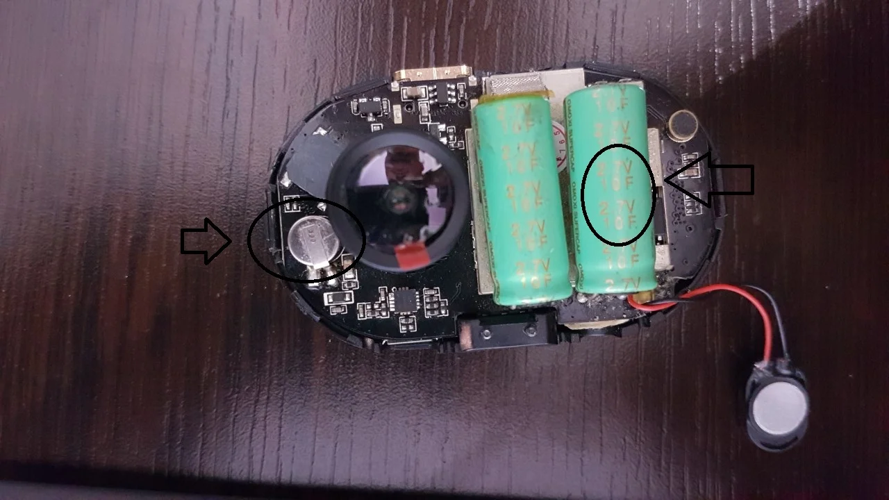

Hello, I opened the camera and I realized that, there is a buttom battery on the board and it drains away.I was defective. So I ordered this back up battery. You can see on the picture left side. I will change it.

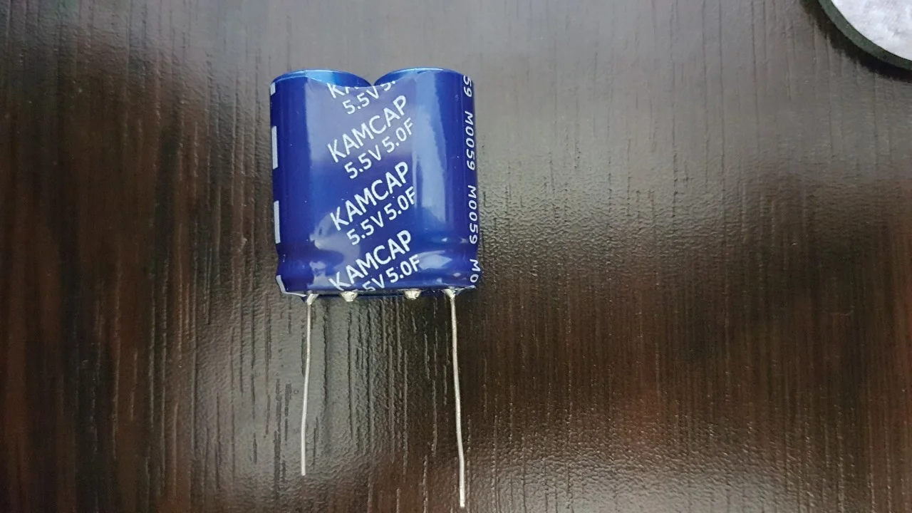

Also I have 5.5v 5,0f capasitor. I will try to change old one. But I am wondering is it suitable or not. Otherwise I will order 2.7v 10f two capasitor.

I have change capasitor and battery nothing has changed. 1 days later it resets date and time.

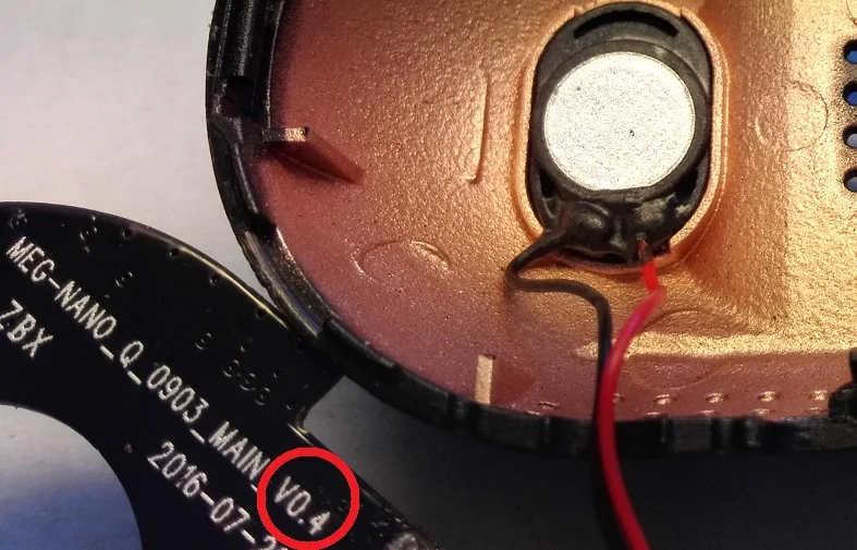

Hi @Evren ,
which version on your nano PCB (Printed circuit board) is marked? Mine are 0.4
If V0.4 or V0.3 - you must make hardware changes as described in this link. Soldering battery opposite "+" with "-" πŸ™‚
Battery need for date and time saving, Capacitor for correct last file saving.

Hi @Evren ,
