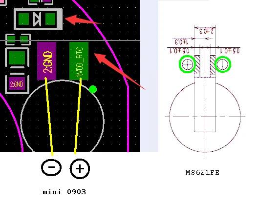

one question from non radio man: is it OK if mini0903 +pin differ than original MS621FE +pin? Or I something missing..?
From my point of view pins are in opposite site...

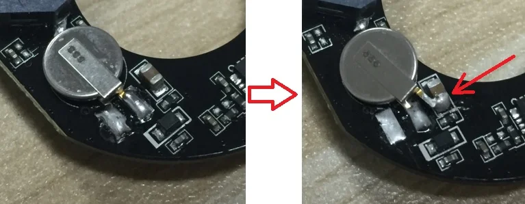

it is a MS621 battery
1, take the battery + pin from PCB, use a heat resisting tape to insulate;
yes we found this mistake on the end of Apr, then changed the PCB design accordingly.
it is quite a shame our engineer made this basic mistake.
that came from a hardware engineer we engaged from a famous Novatek developping team.
all the PCBA which marked V0.3 and V0.4 have to do this modification.

this problem is not about firmware update, but a hardware mistake. see my last image above.

I soldered RTC battery as in Rayman's photo and looks like now problem disappier. For sure need more time.

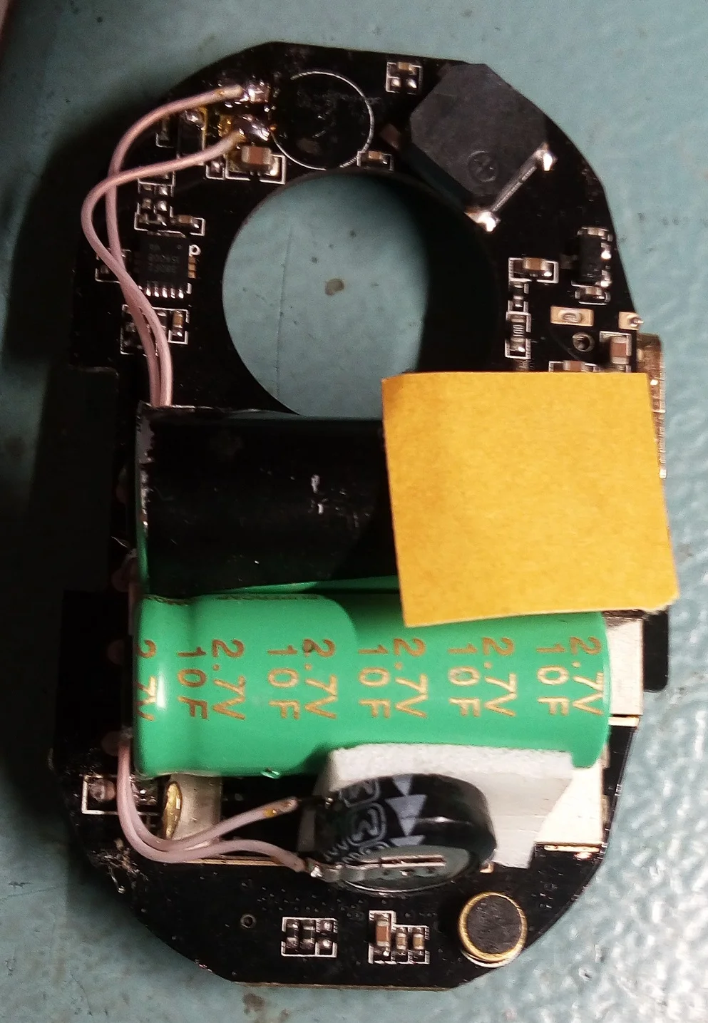

I found in my mess a capacitance, like in here
I replaced a original battery to it. Will try to check how it can save a clock.
P.S. I going to disconnect a WiFi power pin. May be a source a noise, who damage signal from GPS satellites, is a WiFi
I have read above.
In my mess I had only capacitance 🙂
May be a your accumulator is better. I don't know
The original capacitance did not work.
P.S. Did You add 220R to diod, as wrote in first message?
I have read a data sheet for your accumulator. The maximum charge current is 0.1mA. For 220R a charge current is (2.7V-2V)/220R = 3.2mA
(2.7V is output from diod, 2V is minimum voltage for your accumulator)
Ok. May be a your accumulator will be live very long time. Or not.
Time will show.
P.S. I would raise a cathode of diode and add between this pin and pad a SMD resistor 2K.
But after this procedure a time of charge your accumulator will be about 16 hours
