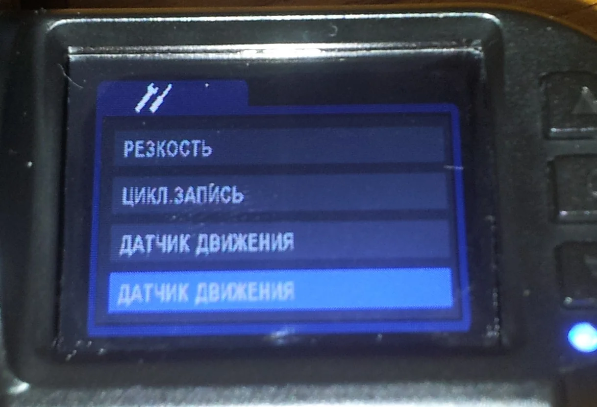

have in russian translite 2 times датчик движения and on boot or shotdown is freeze need to hold power button for ~15 sec
