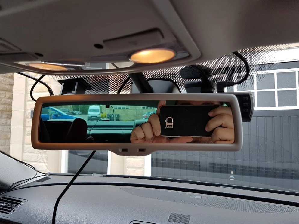

Here are a couple of pics of the installation into a VW CC - excuse the sticky residue above the 0906 - I need to go at that with some more isopropyl alcohol / nail varnish remover or similar to remove it.
You can see the rear camera cable hanging temporarily as I couldn't get the length needed to fully hide the cable (it probably would have been fine to the right but I usually run cables to the left so they're on the passenger side - in this instance it would work better to the right hand side of the car.

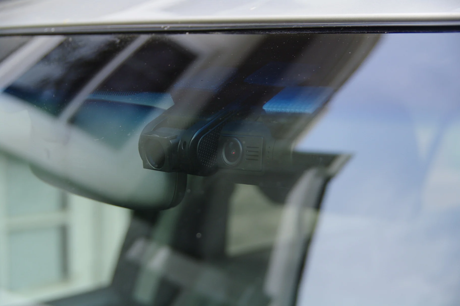

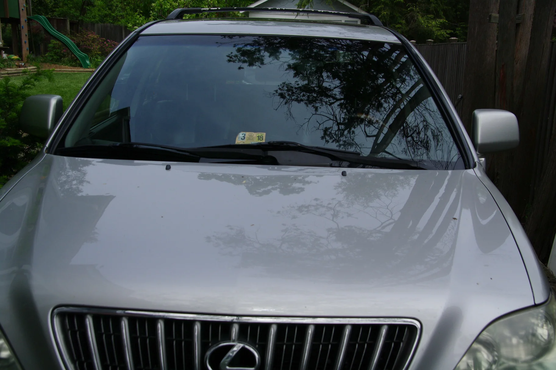

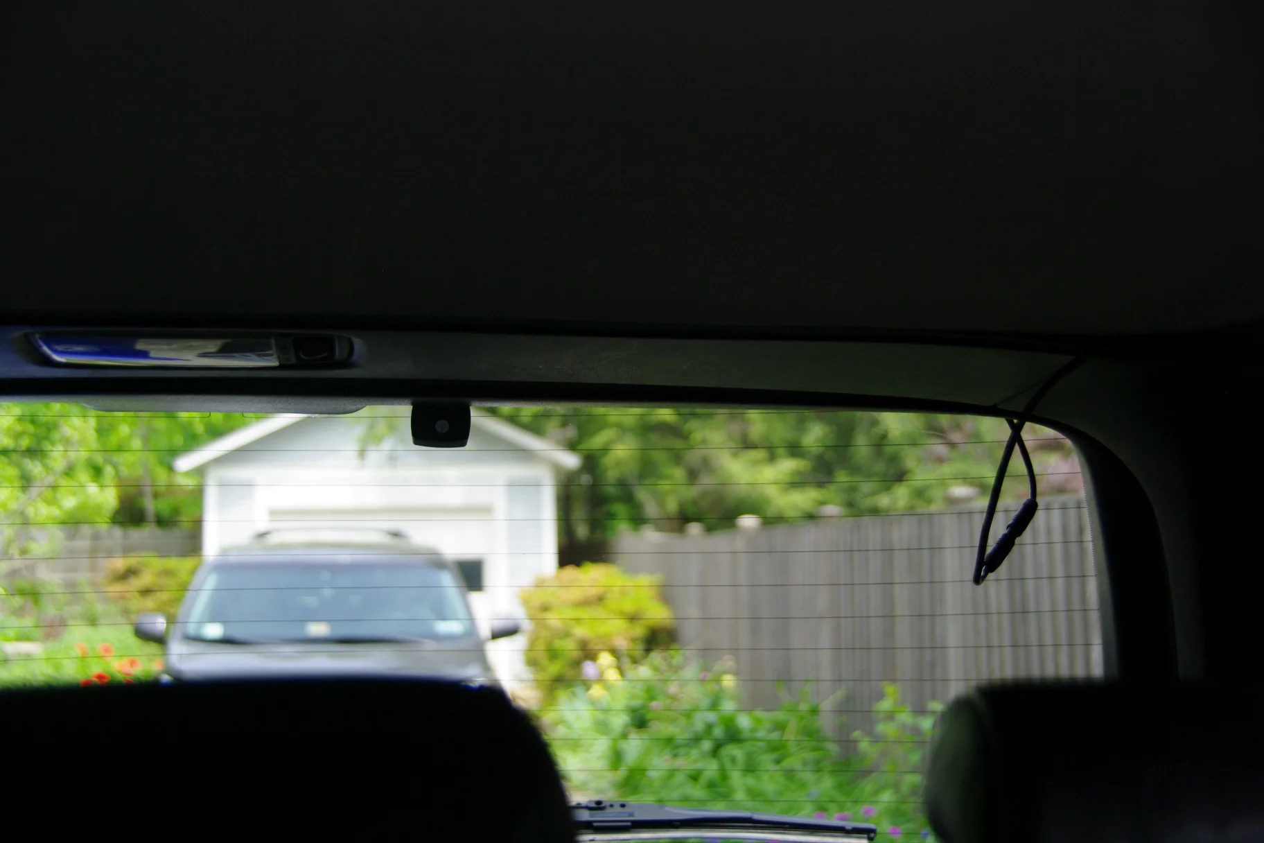

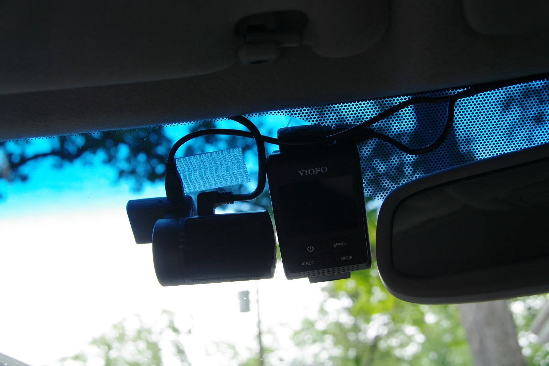

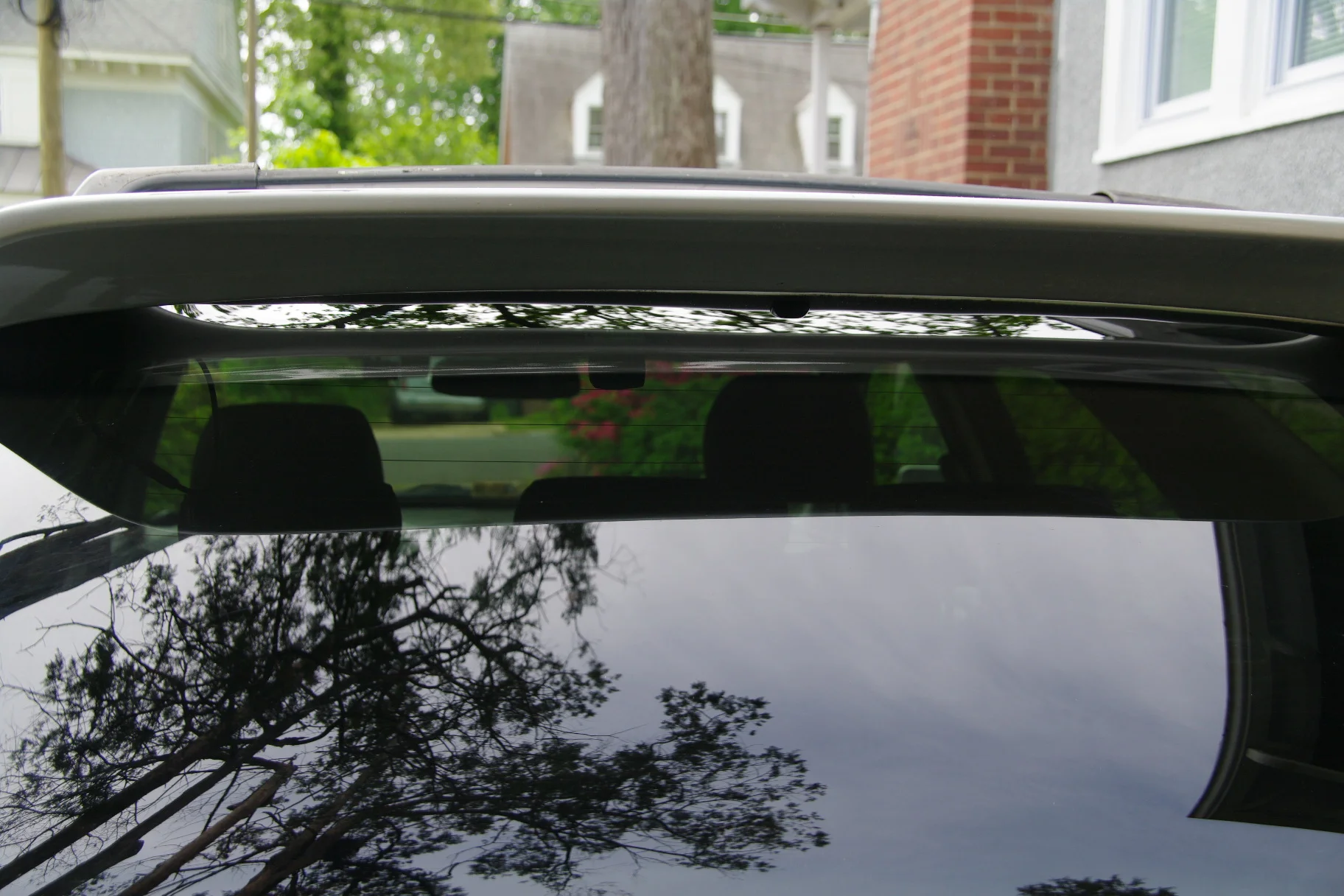

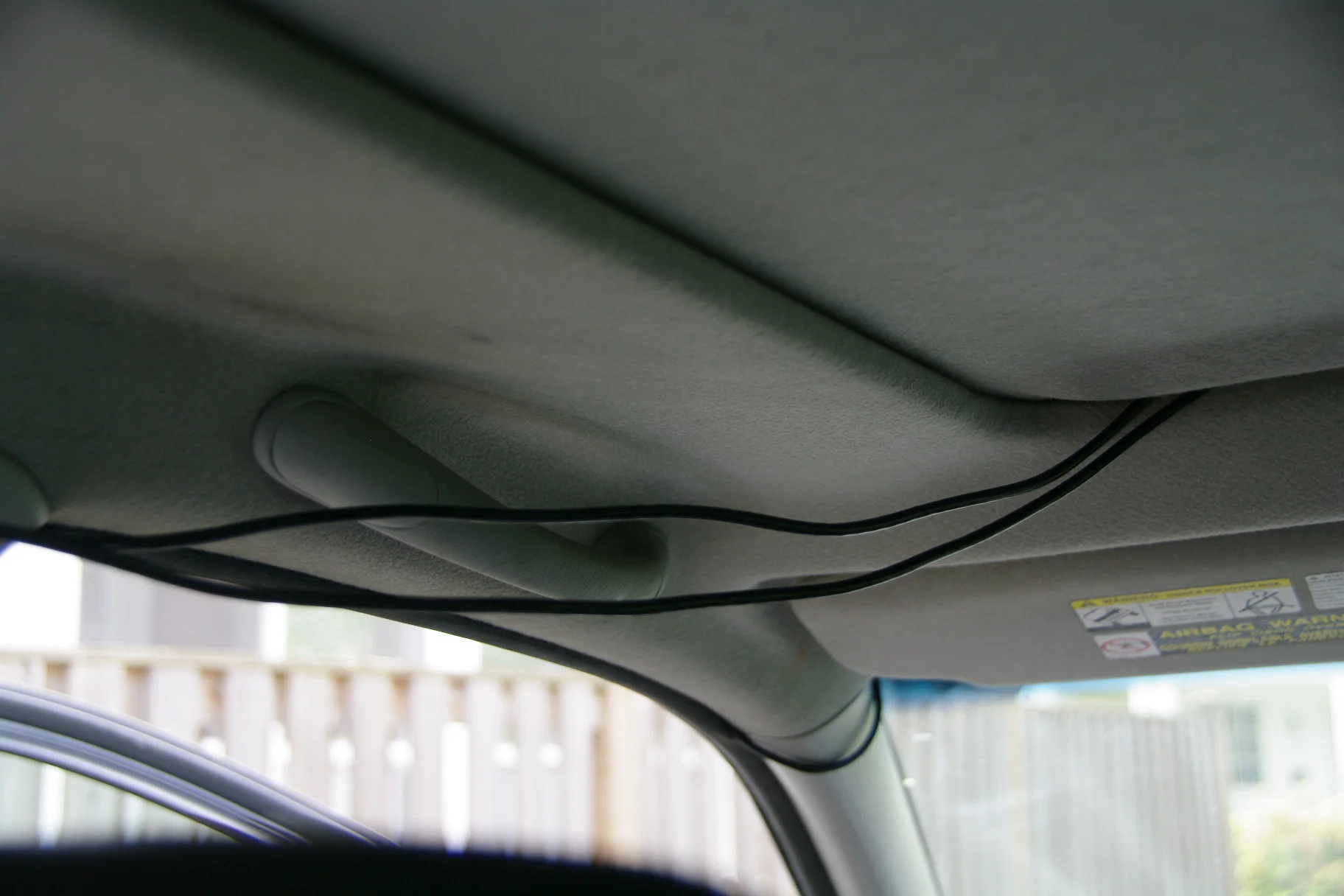

Here is the setup in my car.
To the left of rear mirror A119s, then Mini 906 and to the right, the rear camera.
Cable storage under moon roof.

Doesn't need an angled connector. Rear camera input should be available through the mount as well, will clean things up.

we used to use the stright connector and we found there will be interference with windshield glass if the glass angle is less than 30degree from horizontal; then we made the new tooling for angled rear cam cable.
There are 6 wires in the small cable which is not easy to connect through mount, because it is digital signal transmission. If a VGA rear camera it will be quite easy by analog.
