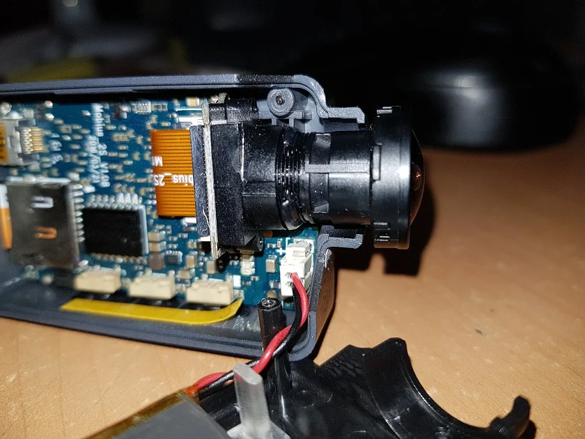

I was able to solve the problem:
I opened the camera and only had to "screw" the lens to the base.
The problem was that without opening the camera, i just put the lens and did not adjust it correctly.
The camera is new (eBay, eletoponline365), the white that is seen, is glue to hold the lens:
Thanks to everyone!!
Glad you got it fixed. Although it doesn't look like there's very much thread engagement within that lens holder, I'm still surprised that you were able to pull it out like that.

Good that it's not actually broken. You'll still need to refocus it.

It would be inappropriate for me to say (assuming we're talking about the same camera) but from what I know it's a case of some positive steps forward and what I would describe as a major step back. 😡 I think hobbyists, enthusiasts and DIYers will be very disappointed in the direction Mobius has decided to take their business. Hopefully, I'm wrong about this but if the heavily glued in lens is any indication many won't be happy.
