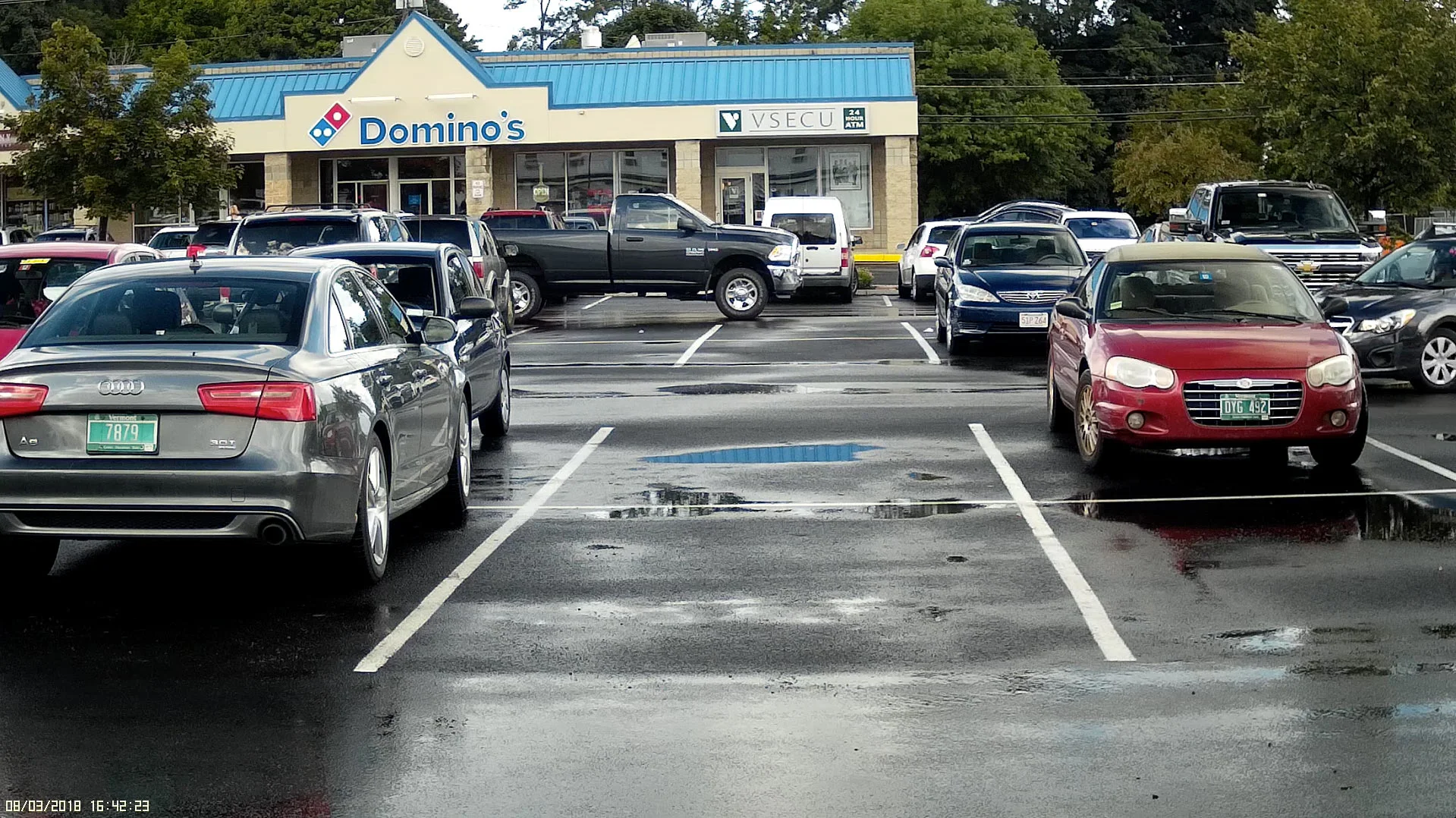

Here's another example of what I mentioned above. Note that the polarizer has eliminated most reflections from virtually every windshield within the camera's FOV in this parking lot regardless of the angles the lens is observing them from. This effect seems to work for the most part regardless of the angle the sunlight is coming from as well, as long as the polarizer is dialed in for other car's windshields. Note that the polarizer is not effective for the other vehicle's side windows or the puddles on the ground.
For the record, I am a fan of polarisers. As we agree, it's impossible to always have the correct angle for all reflections. For internal dash reflections there's nothing better at a reasonable budget, and the polariser above has alleviated the internal reflections on that dullish day and most of the window reflections in the near field, the exceptions being the truck and white van straight ahead and the edges of the windscreens falling on the outer edge of the FOV. I think we're agreed it's down to angle and the result is very good where it matters with a little adjustment. You can't achieve prefect all of the time especially with a varying angle to the light source, but a polarised picture is much better than one without (with the possible exception of nightime video with some sensors). It's just a shame that many proprietary polarisers can't be adjusted.
