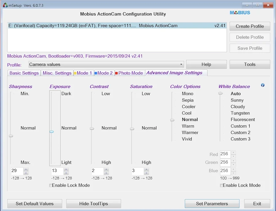

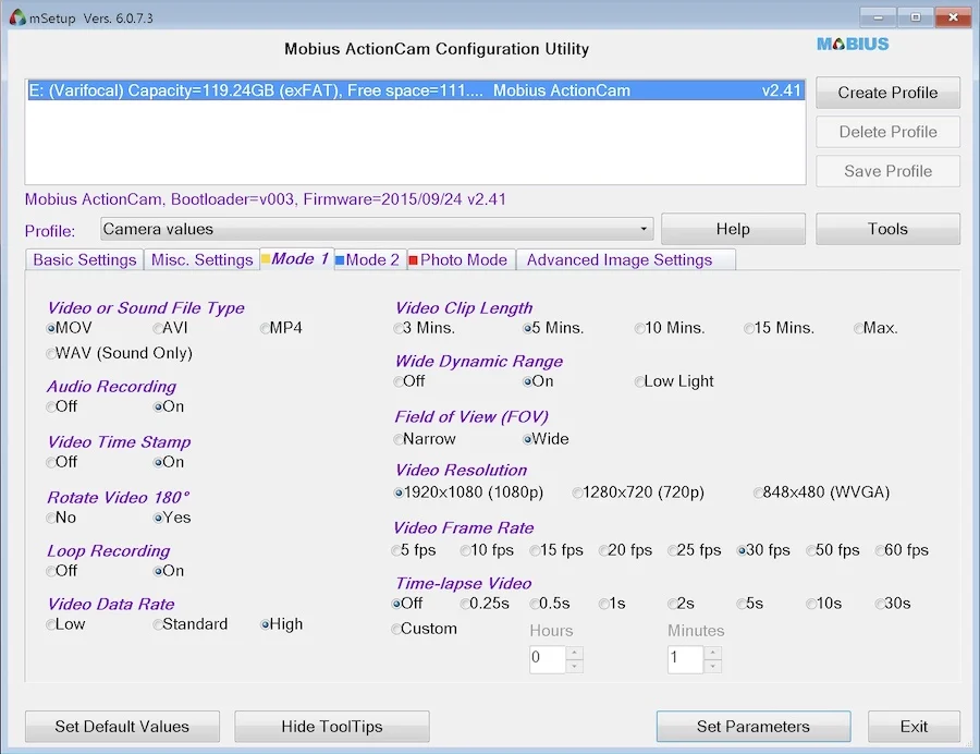

Are there any suggested settings for using this lens with the mobius?
I am using Lens C Profile (that's the original lens) 1080p @ 30fps (should I be using 60fps?) High data rate. Auto exposure.
What file format is best?
ewww

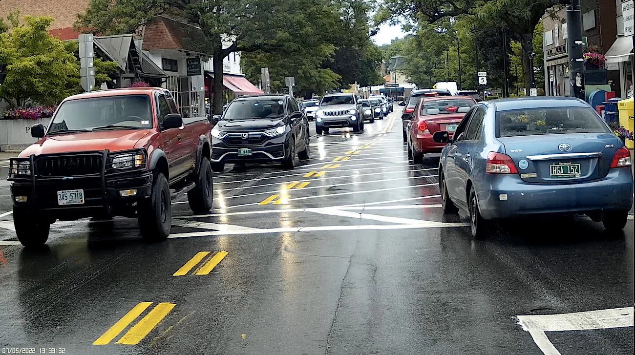

These are the current settings I use for the 5MP Varifocal Zoom 6-22mm ƒ/1.6. The lens has a 37mm Hoya HD circular polarizer installed on it which affects which settings I choose. Of course, the best thing to do is experiment with your settings until you are satisfied with the results.
I use the .MOV file format.
60 fps is not available for 1920 x1080 (1080p). If you try to set it to 60fps, it will automatically switch to 1280 x 720 (720p)
Edit: Forgot to mention that I use the "C" lens profile as it provides the most neutral color balance for the varifocal lens.
