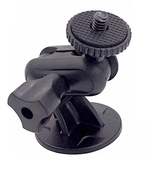

As you mentioned, the mount needs work. What kind of mount are you using?
I use a helmet mount with some thin foam tape on the windshield mounted piece. No vibrations or wobbling with the 12mm.
the mount I used is a repurposed smartphone magnet mount. replaced the magnet with a N42 (Pot Fishing Magnet). I want for the camera to be as near to the car window (out of sight out of mind setup). Magnet is strong enough and cannot be easily pulled out, but it could still slide hence the 3m tapes.
The placement of the expressway rfid have limited where I can put the camera. Current setup is my 2nd time mounting it. As you can you can see in the picture, it was initially place a little higher. It was ok with out of sight out of mind setup up until my wife use the car , she always adjust the rear view mirror and as the first set of pics posted above it has nudged the camera a little bit to the left. The thing about helmet mount is the need to use of the cradle which add length when the camera is mounted (making the M1 visible in the driving seat).

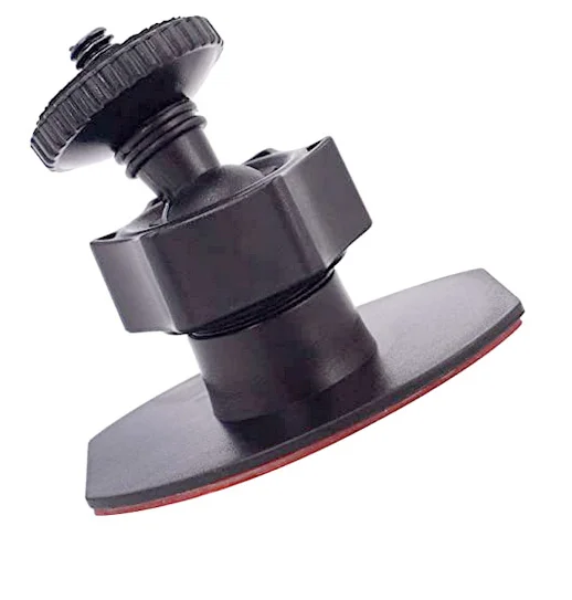

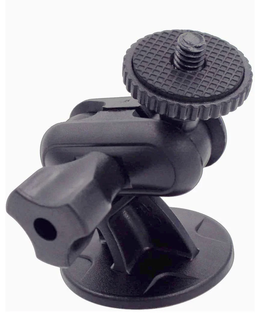

Finally, I agree that you need a more stable and solid camera mount. The varifocal lens is a pretty heavy and when attached to a lightweight camera like the Mobius is needs a really strong mount that will be more secure than the magnets.
These days I've been using one of these generic, widely available mounts for my M1 varifocal and it works very well. It can depend on the slope of your windscreen whether this mount will work for you.
Another mount I have which I am going to be switching to soon is this one from iSaddle. It is very versatile for aiming and positioning the camera and once you tighten the thumbscrew it is ROCK solid.
https://www.amazon.com/gp/B00QSFKJ8E
https://www.ebay.com/itm/194764881944
I also spoke about these mounts a few months ago in a different post and I think one of these two would be a good option.
The iSaddle mount looks like a good alternative to the helmet mount.
