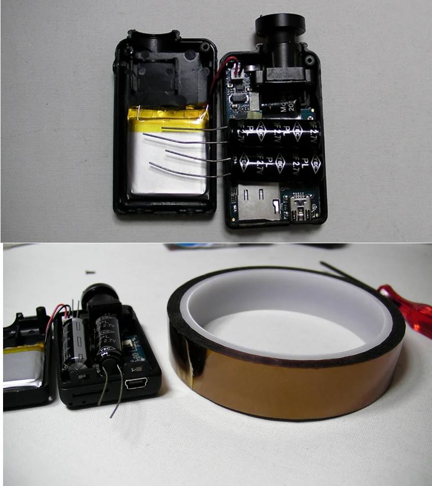

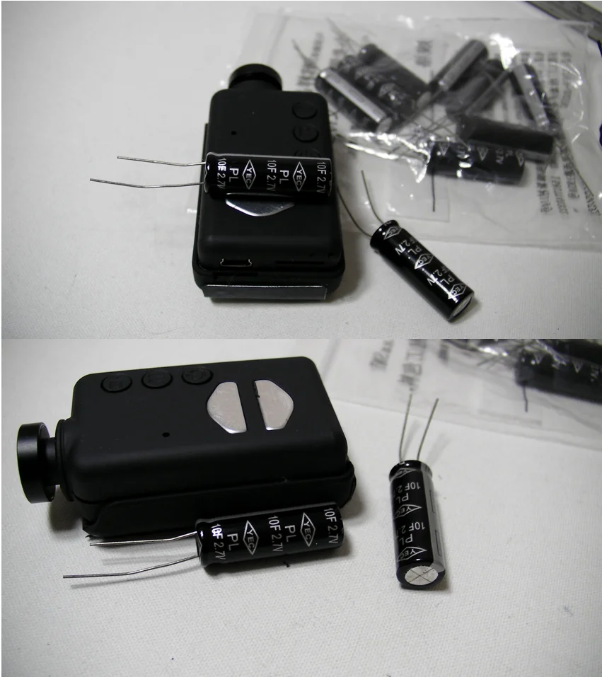

niko, if you are looking on the search link you provided on Aliexpress, you will see the Vinatech supercaps are expensive, about $17/pc.
I remember that Mobius developer was searching for some chinese capacitor but he didn't found any model maybe because of too big size and he was forced to use the expensive Vinatech compared to some cheap chinese.
If these capacitors are so expensive I was expecting the developer to find a solution to use some small battery just for the clock. In this way he could use cheap capacitors just for saving and turning off the camera. But if that batteries can be affected by the heat too, why not a dedicated cheap supercap just for the clock?
But if the PCB was made before the capacitors idea I think this is the only solution.
